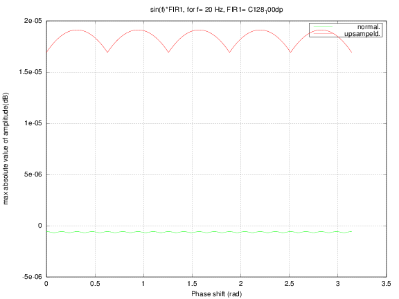

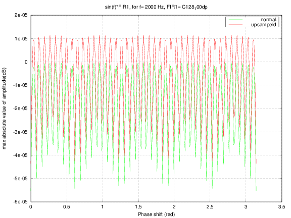

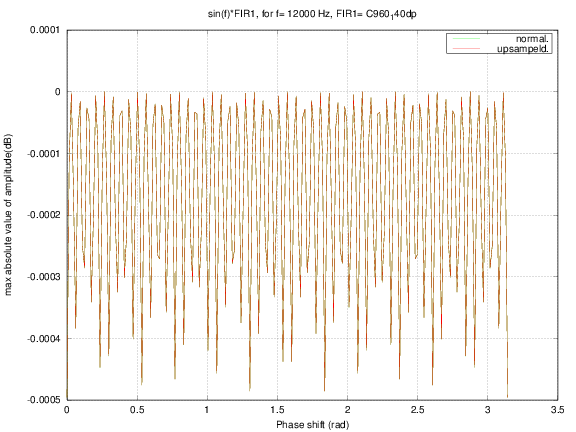

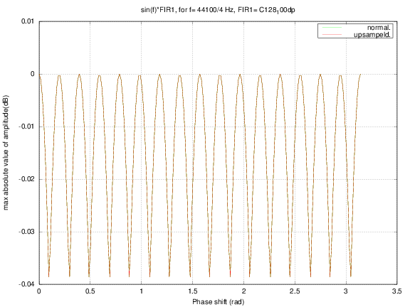

In the quest for the "fs/4-peak" I computed the convolution of a sin() signal of frequency f with the FIR1 filter. Then I looked at the maximal absolut value of the resulting sequence. I did this for different phase shifts of the sin, as the samples of sin then differ slightly. I did that for a sin() with fs=8*44100Hz and for a sin with fs=44100 which was then 8-fold oversampled. The graphs of that where a bit surprising (for me).

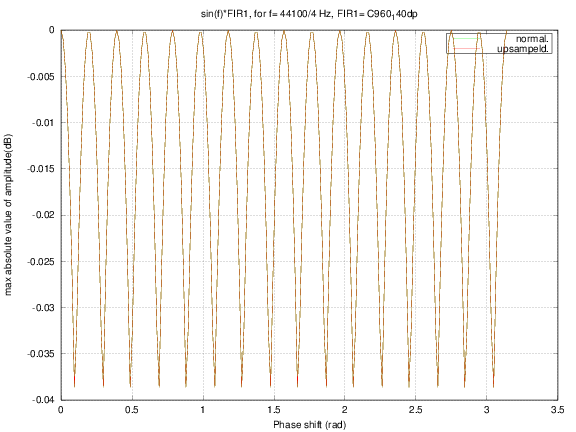

Also there is something special for f=44100/4Hz, but I am not yet sure how that could explain the "peak".

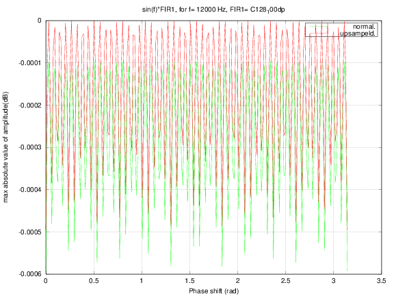

First observation, the oversampled and non oversampled case differ (by a very small amount) in general, more visible for low frequency and when the roll off starts

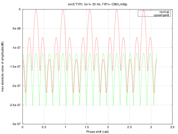

Here an example of C128_100dp and C960_140dp at 20Hz.
Second observation, while for the C960_140dp difference disappears quickly (at 200Hz it is no longer visible) for the C128_100dp it remains. Moreover the oversampled case with the C128_100dp has its maxima over 0dB, so is clipping slightly, while the non-oversampled is not clipping.
Third observation, for f=44100/4Hz the variation with the phase is much bigger than usual ... is that the cause for the peak?

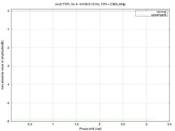

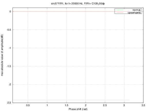

Fourth observation in the roll off area only the non oversampled case rolls off (remeber we see only the maxima not all samples)
After some headache, I figured out this is no bug but a feature ... of the Nyqvist filters.
We know Nyqvist filters preserve on oversampled signals the original samples. If f is no or not near a big integer divisor of 44100, more or less all values of the sin function will appear as sample, so especially 1 (=0dB), and will be preserved by the Nyqvist Filter.
Compare with IPv4_p35, the oversampled case also begins to drop, not as fast as the non oversampled, but definitely does not stay at 0dB.
It remains to understand if the bigger variation at 44100/4Hz is cause for the peak and if yes to explain that variation.
Here the Octave code used to make the graphs:
Code:
pkg load signal;
format long # print more digits
global fs=8*44100;
f= 12000; % frequncy of the sin test tone
fir1= dlmread("/path/fir1_C128_100dp.txt");
ti=round(fs/f)+length(fir1) % lenght of convolution of FIR and one period of sin
t=ti*16 ; # nr samples of the sin function (in the not upsampled case)
ap=200; # number of divisions in phase shift
function rdb = db(H)
% dB
rdb= 20*log10(abs(H));
end;
% time of i-th sample (non oversampling case)
for i = 0:t
x(i+1) = i/fs;
endfor
% divisions of phase shift in [0,pi]
for i = 1:(ap+1)
ps(i) = pi*(i-1)/ap;
endfor
%non oversampling case
% compute convolution of the sin of frequency f with pahseshift ps(i) with the FIR filter
% discard beginning and end of the result, to get rid of the margin effects
% store the max absolute value of the sequence
for i = 1:(ap+1)
r=conv(sin(2*pi*f*x +ps(i)),fir1);
lr=length( r);
dms1(i)=max(abs( r(ti:(lr-ti)) ));
endfor
% time of i-th sample (oversampling case)
for i = 0:(t/8)
u(i+1) = 8*i/fs;
endfor
%oversampling case - description see above
for i = 1:(ap+1)
r=conv(upsample(sin(2*pi*f*u +ps(i)),8),fir1);
lr=length( r);
dms2(i)=max(abs( r(ti:(lr-ti)) ))*8;
endfor
% print the max absolute values of the sequences as function of the phase shift
plot(ps,db(dms1),'g',ps,db(dms2),'r')
xlabel('Phase shift (rad)');
ylabel('max absolute value of amplitude(dB)');
h=legend ({'normal. ', 'upsampeld. '}) ;
title ('sin(f)*FIR1, for f= 12000 Hz, FIR1= C128_100dp' );
grid('on');

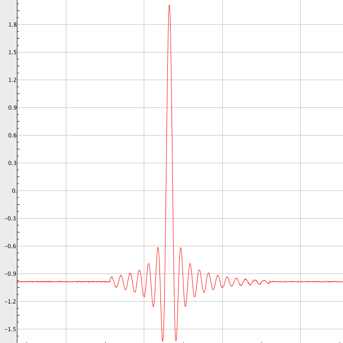

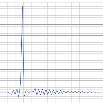

Yes, impulse you see is what comes out of DAM add to measurement board with ADC filter.
NOS measure also had ringing.

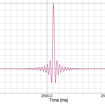

I think we need to be a bit careful how we interpret sound card tests using impulses.
The C960_140 impulse you posted after processing via your ADC and fuzzmeasure looks like this:
attachment.php
I've hooked up my Bitscope Micro and measured the output at the +/GND on the XLR connectors.
The bitscope was using Enhanced mode which gives highest bit resolution. Sampling rate is 5MHz which isn't the best.
The capture is truncated due to triggering and the resolution of the Bitscope. The display is offset by about -0.9v, mainly so I could zoom in on the area interest on screen.
This shows the 1 sample impulse played via iTunes -> USB -> Amanero, then processed with C960_140 filter installed on the DAM:
attachment.php
And finally the C960_140 + FIR2 impulses processed against the same test signal using SoX, which is my usual method.
attachment.php
You can see that the characteristics of the filter impulse response and the impulse response at the DAC output in my tests are broadly similar, which isn't too bad given the abilities of the Bitscope. On the other hand the impulse you've posted looks as though it results from another filter all together.
You could probably improve the quality of the results you are getting by upping the sample rate of the ADC to minimise the influence the ADC internal filters on the DAC output. Although this means feeding the DAM at 44.1 and setting the ADC to a higher rate which isn't usually possible if you are running the DAM from the SPDIF of the same sound card.
TBH this is why I prefer to work with the impulse response of the filter coefficients themselves. Anything else adds too many variables to the equation.

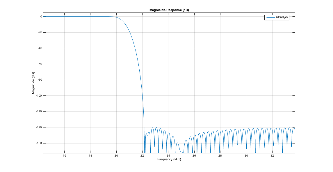

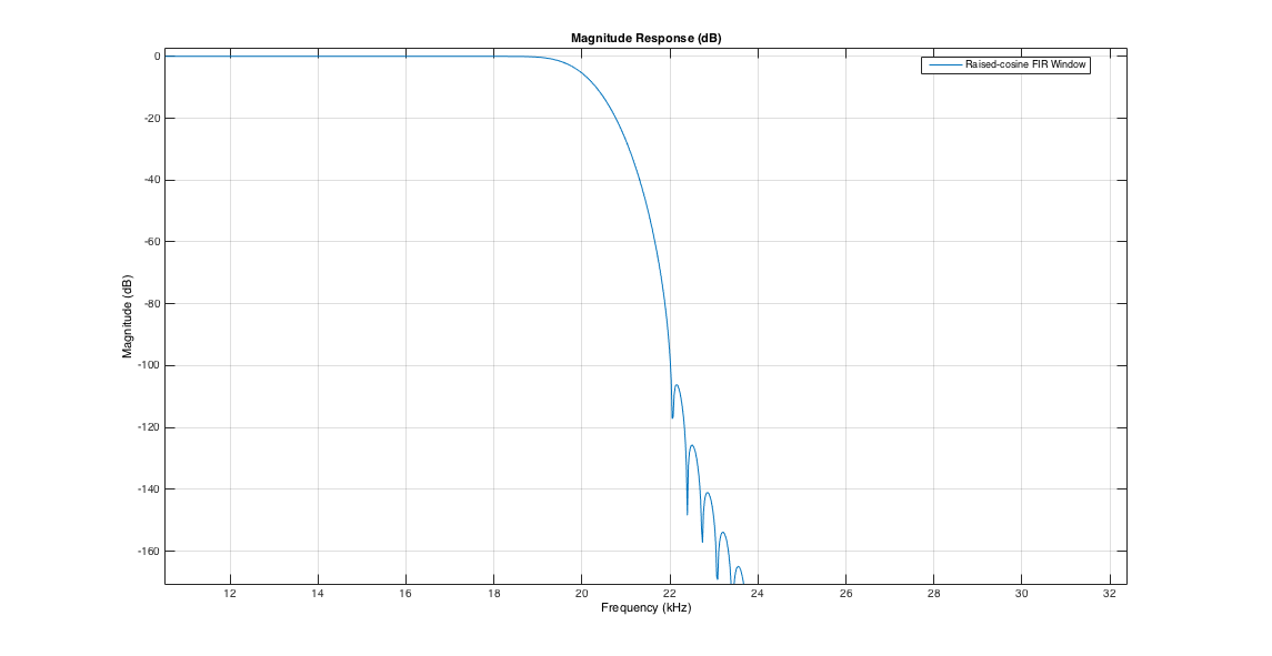

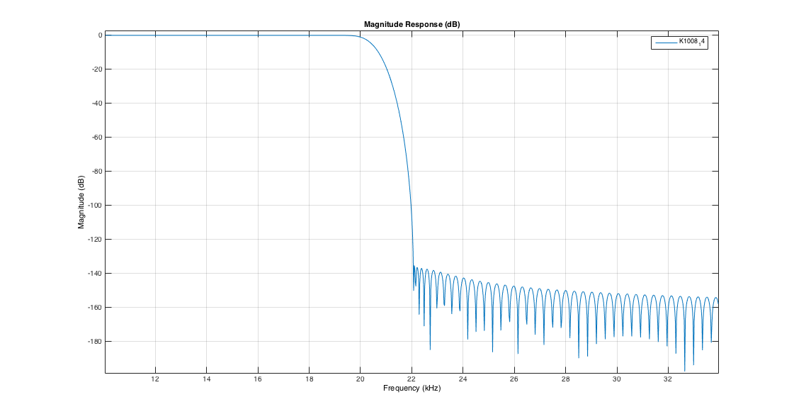

The CT1014 is basically a brick wall filter, with a slightly gentle rolloff. Plot of CT1008 is essentially the same as posted filter.
Attached are two variants with Kaiser and Chebyshev windows. The aim is to have around 100dB attenuation at Nyquist.
I suspect there is a bit to be gained by the added stop band attenuation.
There isn't much between the filters. I think the deeper attenuation of the stop band might make the LF sound slightly more open. There is more roll-off with the CT1014 above 19kHz, otherwise....
Goal of all the above is to eliminate the imaging around Nyquist as far as possible. I was also checking for colouration that might be attributed to the window functions. I don't think there is much to pick between them. Interested to hear constructive comments.
