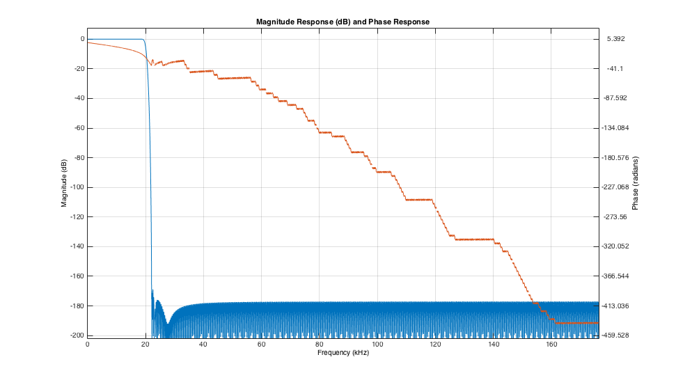

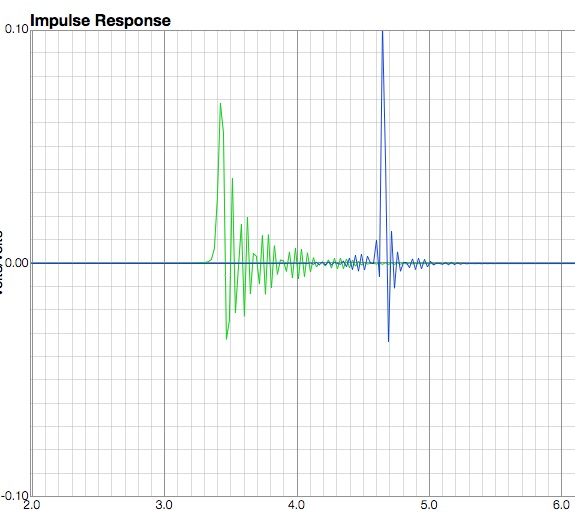

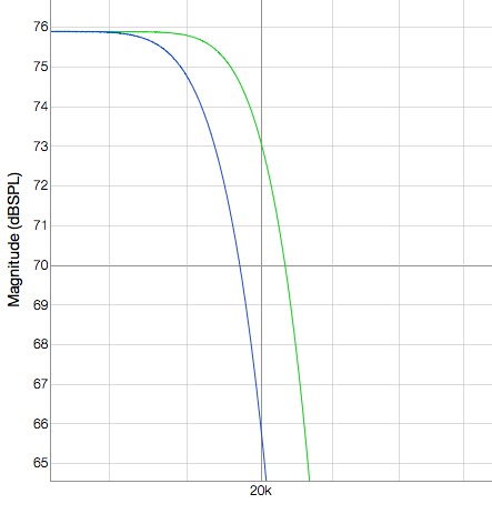

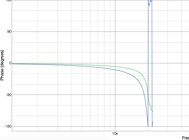

Just compared 1013 180 LP vs 1013 170 MP and I am surprised that I like the Minimal Phase filter better than the Linear phase one. There seems to be a better soundstage with the MP filter, things get a bit more emotional for me. And the body of the instruments are more pronounced. As always it could be some kind of enhancement going on, but I like it.
But there seems to go on more that just a switch from LP to MP, if you look at the attachments you see that frequency and phase response differ quite a bit.
MP rings a lot though, I would love to try some intermediate filter with those settings.
Yep. I'd been messing around checking to see the effect of Søren's proposed tap length increase, and altered some other settings...
Phase response will be completely different - one is minimum phase, the other is linear after all.
Saving settings is a bit hit and miss in Slifer so I've redone the base filter and made a MP directly from that.

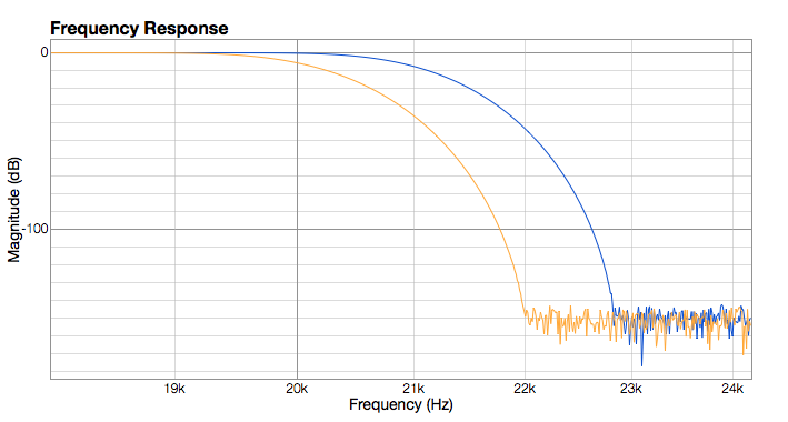

attachment.php
The SoX filter runs over fs/2 by 7-800Hz which allows it to remain flat to over 20kHz, whereas the C180 is down by 6dB at 20kHz, although I doubt the flat response to 20+kHz is making much difference.
I've done a test filter that is has 140dB stop band attenuation at 22.05kHz, which has the effect of reducing roll-off to -2dB at 20kHz. I don't hear any appreciable difference in detail between the two non-SoX two filters. Yet the SoX filter is noticeably brighter.
The Log Squared response of the SoX HiAtt and C180 is virtually identical in shape, so nothing there that would indicate a reason for these apparent differences.

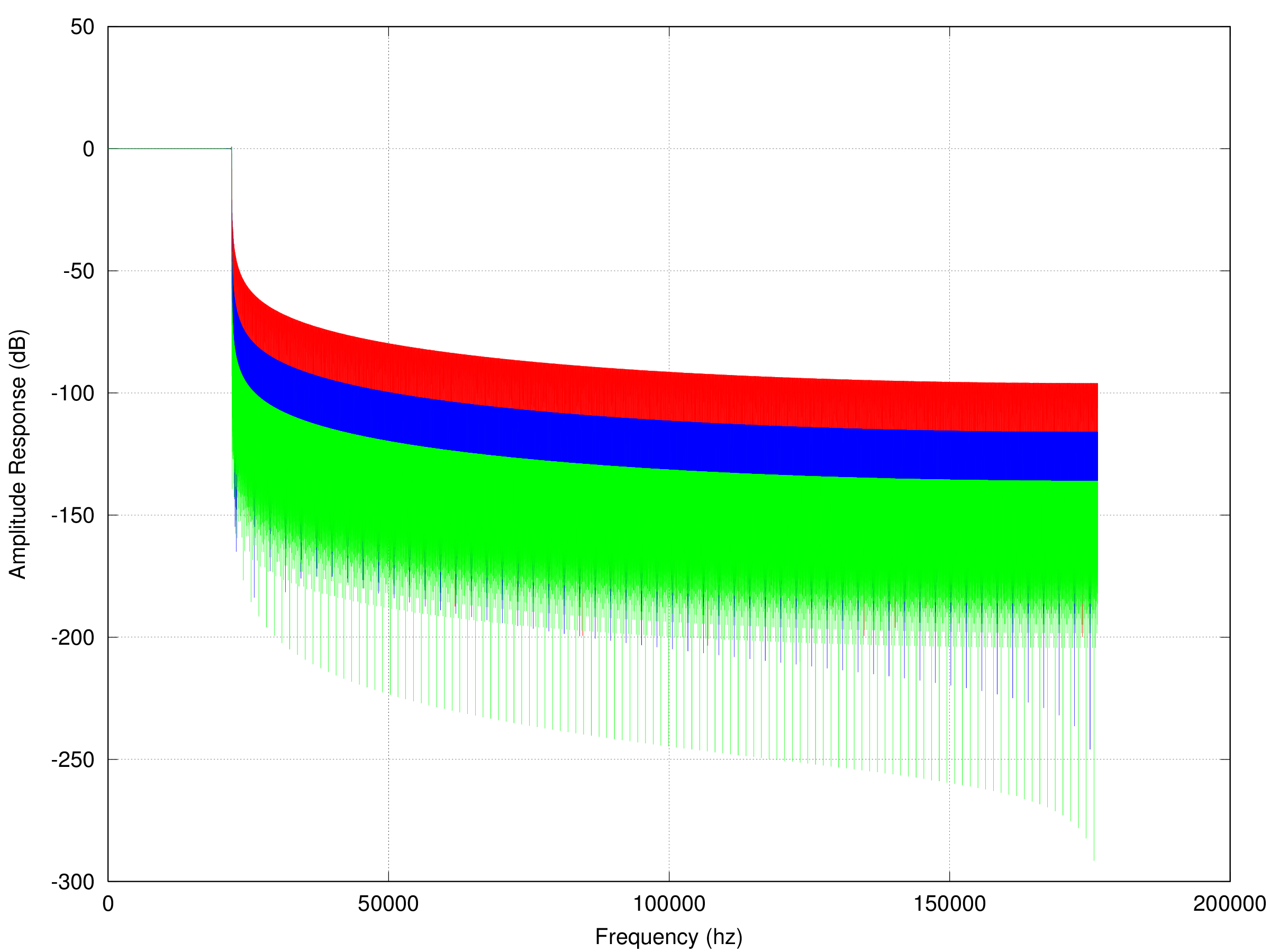

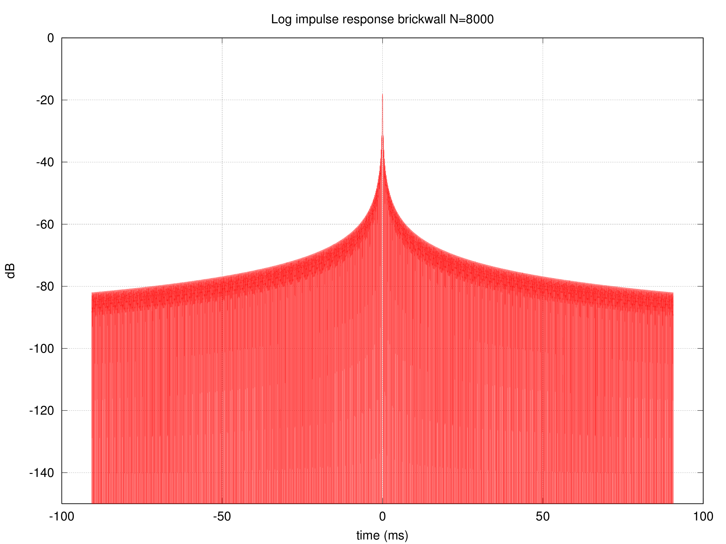

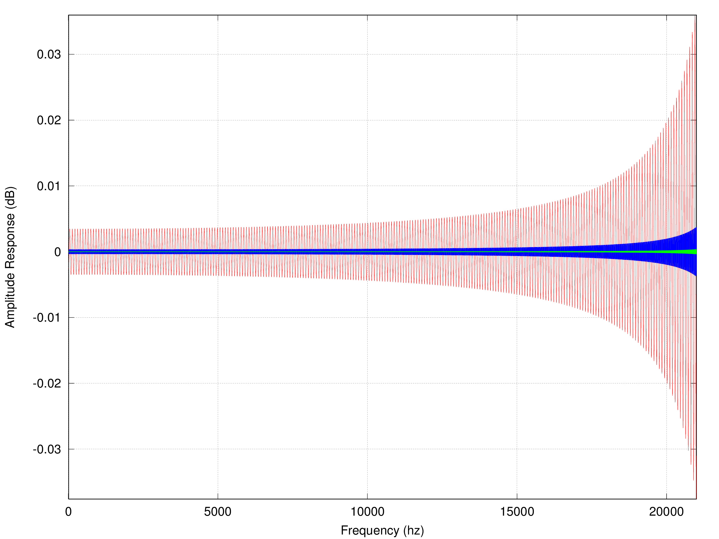

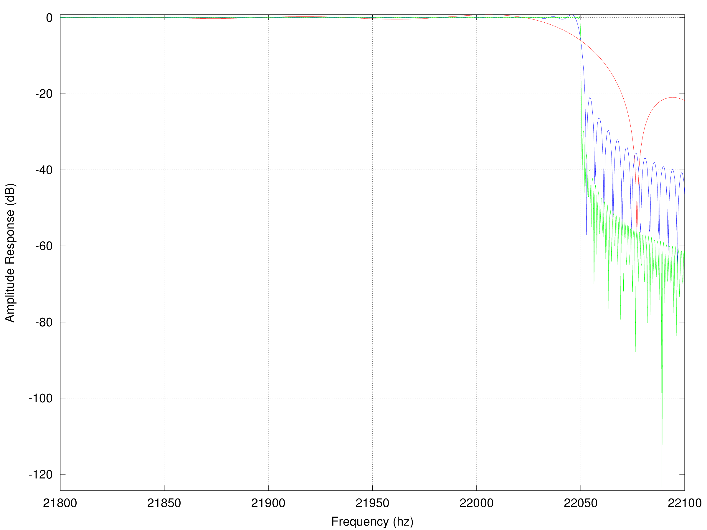

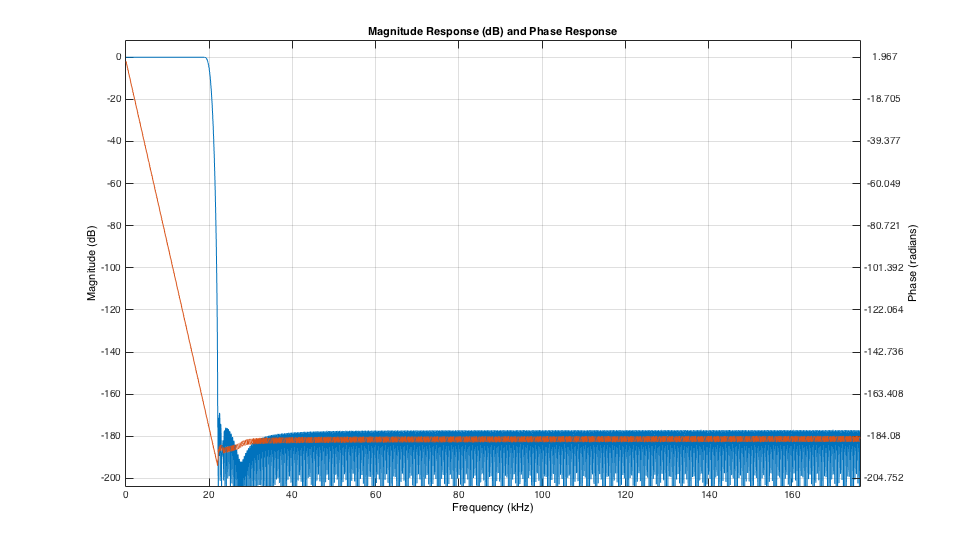

It might be interesting to have a look on the ideal brick wall filter for an n-times upsampled signal of (original) sample frequency fs. I.e. the LP filter with frequency response 1 for f<= fs/2 and 0 for f>fs/2.
The corresponding FIR filter is the Fourier transform of that "rectangular pulse", so its coefficients are
c_i = 1/n* sinc(i/n) = 1/n* sin(pi* i/n)/(pi* i/n)
This FIR filter has infinite length and is not realizable. But we can look on how it "performs" if we truncate it.
But first some general observations ... it contradicts many of the early design criteria:
- It is very long.
- The log-Impulse response plot is relatively flat.
- It gets more and more brick wall :)
Some plots for n=8, fs=44100Hz, and only considering the coefficients i= -N/2...,N/2 for N=8,000 (red), N=80,000 (blue) and N=800,000 (green).
The log-squared-impulse response
The frequency response plus some close-ups.
Impulse_reponse_brickwall.png Impulse_reponse_brickwall10-21000.png Impulse_reponse_brickwall21800-22100.png
