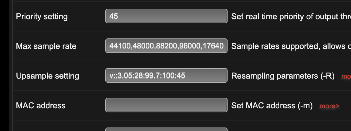

Only doing upsampling in the rpi for the last year and half. "Felt" it worked better than doing filter brewing etc. on the dam.
This is my setup
