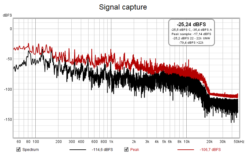

The attenuation of >22k is only 55dB - are you satisfied with this?

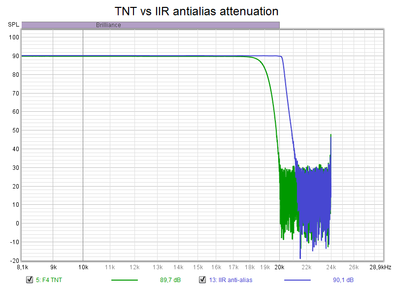

The anti-alias IIR filters you deploy, what type, order (15?) and Fo (freq) does it have?

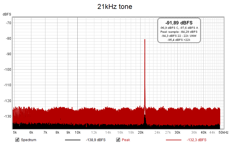

If You took that number from picture it's noise floor generated by tone sweep test. Single tone on 21kHz or signal capture show full attenuation.
I don’t have fancy equipment to show more 😊
It’s IIR 15th order filter with cut of frequency just after 20kHz and full attenuation at 22,05kHz constructed from biquads – nothing spectacular.
I’m not using any external filters with this filter set now. This filters set it’s standalone complete solution.

So 15th order = 90/oct => signal is down 90 dB at 40 000 Hz (one octave above 20k). I see attenuation at 22,05 is approx 50 dB. The theorem says no signals shall be allowed above Fs/2. Just as a comparison, my filters published here are >180 dB down at 22,04 to mitigate aliases. On the other hand its down several dB at 20k but only -0,04 at 17k... trading trading

Is that measured using REW?
Or was the chart generated by REW from the filter coefficients?
