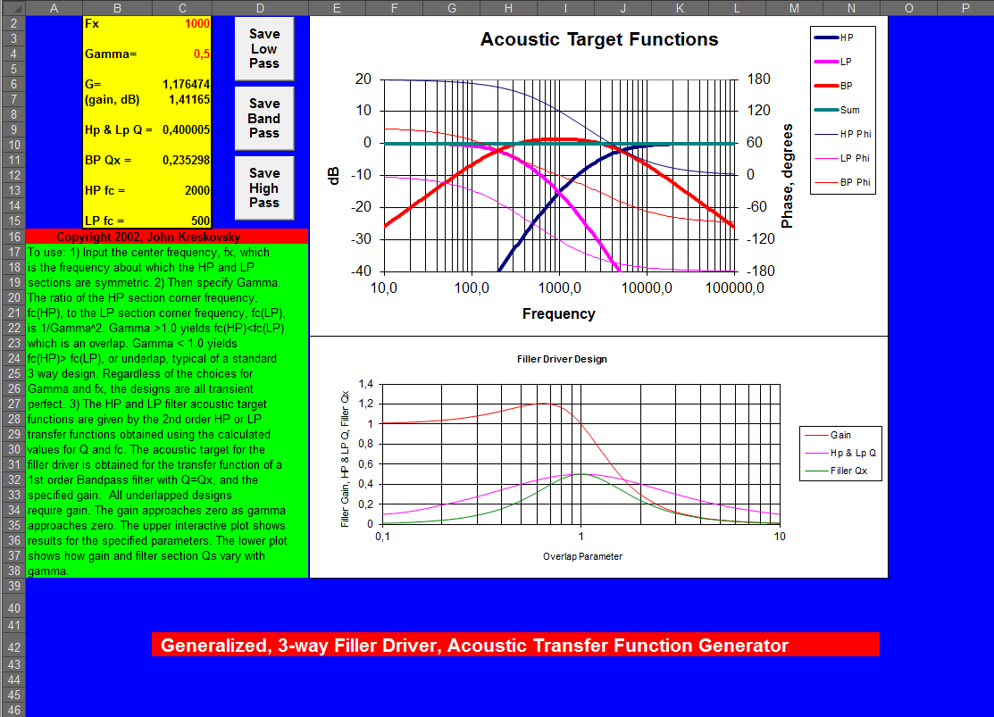

More to the subject was started by PLB at post 133 where some pdf files is available http://www.diyaudio.com/forums/multi-way/88135-filler-driver-ala-b-o-14.html#post4383549. Had a run PLB's filters (linked below) thru my JRiver DSP with soundcard hardwire loopback and REW listening in between at post 139 http://www.diyaudio.com/forums/multi-way/88135-filler-driver-ala-b-o-14.html#post4383814.
Guess key is use John Kreskosky's spreadsheet to find slopes that suit ones drivers bandwidth best, then from spreadsheet at the three grey button export the three curves as frd file and import into measurement program used as overlays and hit those slopes in acoustic domain, probably by a handful or more IIR filters as helpers and a way to bring acoustic center in sync. Below screen capture example from spreadsheet and at post 24 GM shared a link to spreadsheet http://www.diyaudio.com/forums/multi-way/88135-filler-driver-ala-b-o-3.html#post4375989.

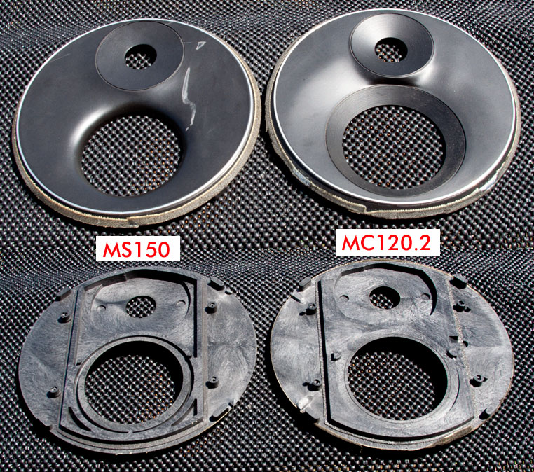

Is that a large coaxial on top for the S45? It looks like a mild angle canted angle is used to bring the woofer forward by tilting whole speaker backwards on a stand with tilt. Not a radical 3in offset as would have been required when I did a passive 2 way with transient perfect first order xo at 600Hz.
Here is the cone mid implementation S45-2:
The S45-2 uses 8in woofer and 3in mid and 1in dome very similar in size to drivers I am picking out. Maybe I am just making a modern version with updated readily available drivers?
https://www.beoworld.org/prod_details.asp?pid=666

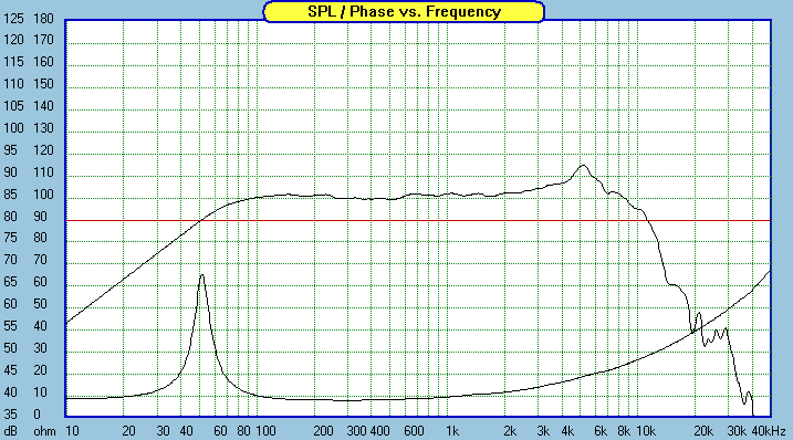

Hi X, here is more accurate fr response for AC130F1. There is minor breakup at 5kHz. Otherwise its perfectly flat around 1-2kHz. There may be something wrong there with your setup.
The 1.5kHz peak is due to the resonance of the hypercube enclosure (spherical breathing mode). It just happened to be the only enclosure I had at the time for a 5.25in sealed driver. I am pretty sure it is flat through there as shown by Zaph and factory curves.

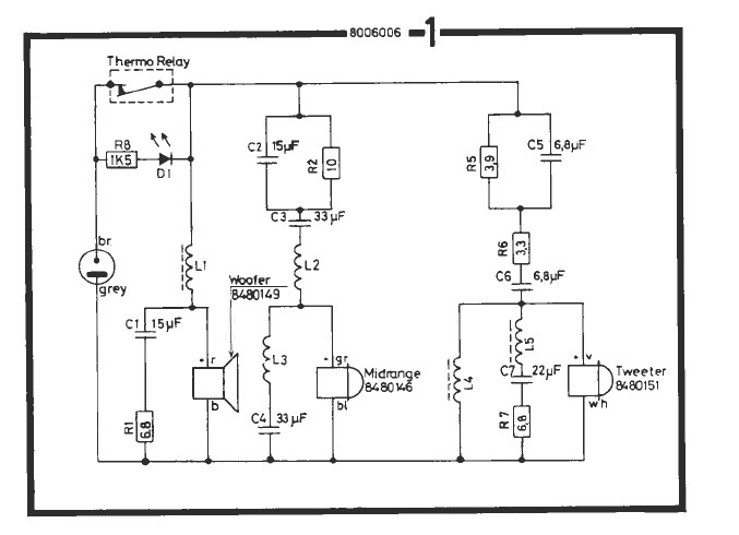

schematic
At post 22 system7 is your friend here link http://www.diyaudio.com/forums/multi-way/88135-filler-driver-ala-b-o-3.html#post4375955
Ha ha post 23 says this:.....Does anyone have an actual XO diagram from one of these B&O hole filler speakers ?.....
Oh, wow! Thanks for B&O xo schematic! Really interested in this.
