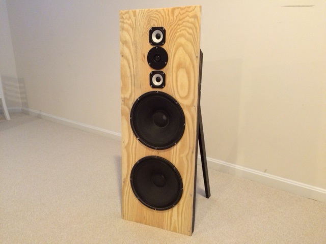

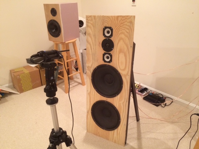

3-way XO Test Bed
I had some drivers lying around and found some plywood so I decided to make a XO test bed to play around with some of these ideas. Maybe look at the Duelund XO, the B&O filler, etc. For simplicity I made it an OB which will limit bass extension but I am more interested in exploring the stuff above 100Hz to see if I can get transient perfect responses etc.
The baffle is 16in wide x 44.5in tall. The drivers are spaced, from the top edge at 5.0in to the mid (TG9FD-10-8) then 4.0in between the mid and tweeter (DC28F-8), then 4.0in from the tweeter to the next mid (TG9FD-10-8), then 8.0in to the woofer (Beta 12cx) and woofers are spaced 13.0in apart. There is a frame on the back and some legs to support it. My plan is to wire the TG9FD's in parallel for 91dB at 2.83v sensitivity, and the Beta 12cx's in parallel for 100dB at 2.83v sensitivity. The DC28F-8 is rated at 89dB at 1W, so probably closer to 91dB at 2.83v. The OB will cut into the woofer efficiency quite a bit but should get me back to circa 90dB after all is said and done?

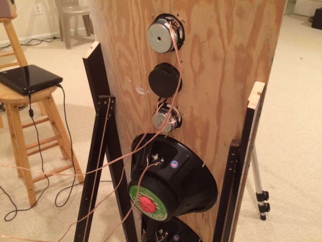

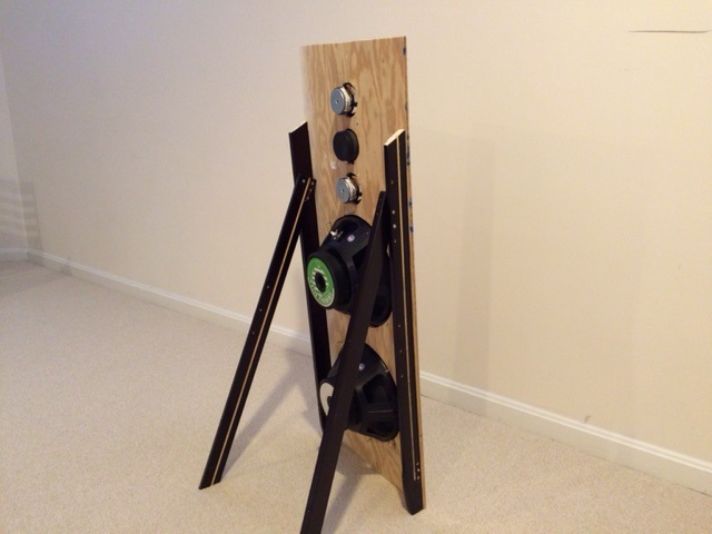

Here are some photos... have not had time to wire it up yet. Will be running it fully active using 1x4 miniDSP advanced 4-way XO and have option of powering woofers with independent amp channels or in parallel. Should be fun and good for learning about 3-way or evebn 4-way XO's. May not be the best drivers but it was what I have lying around. I think the TG9FD should be ideal for the hole filler as it has a wide bandwidth being a full range capable of 250Hz to 9kHz before breakup.

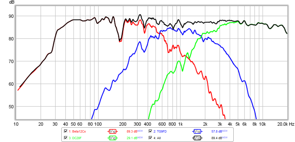

XO Test Bed initial trial all LR2
Just to get things going, I setup a conventional LR2 XO centered at 1kHz with the LF having a LPF at 500Hz, and the HF having a HPF at 2000Hz, and the mid with bandpass filters defined by 500Hz and 2000Hz.
Here is the wiring, I went with quad-amplified with 4 channels from two TPA3116D2 amps. Using minDSP 1x4 advanced 4-way plugin for the XO and PEQ.
Here is the speaker setup for measurement at 0.5m
This is measured acoustical XO:

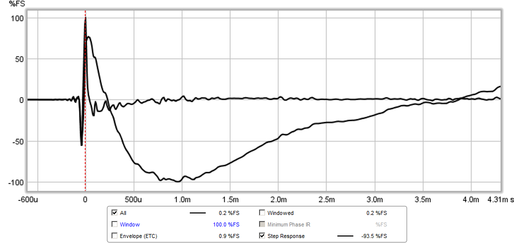

This is the measured impulse response and step response (not transient perfect because this is all LR2) :

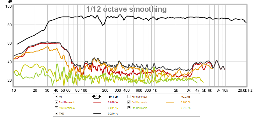

This is the harmonic distortion at low power:
Al in all, it sounds very nice - I am surprised how rich and full the bass is. The -3dB point is about 35Hz. System sensitivity worked out perfectly matched with very minor level adjustment between the drivers. Jazz ensembles have a very good presentation with excellent dynamic range. Vocals and brass instruments sound very convincingly real. Plucked stand up bass is excellent with weight that you can feel. I should note that these Beta12cx's are off spec with a high Qts of 0.65. This may be contributing to the better than average bass extension given the lack of wings even on an OB.

Following, nice work 🙂
What's the dip @ around 200Hz ?
I wonder what 6dB Oct would be like, @ appropiate f's ?

I suspect that might be a cancellation due to front back waves between the two woofers? I could turn one woofer off to see if it goes away. Mic is too close for it to be floor bounce.
