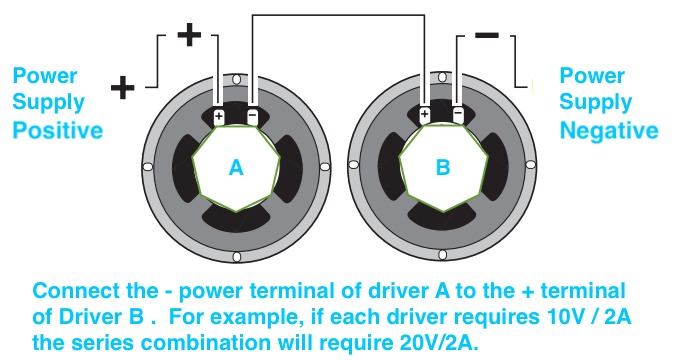

Thank you Hearinspace. Am confuse about wiring 2 FC in series. Would appreciate if you could elaborate moreWhat it seems online and what it is in reality are not the same. It's easy and not worth worrying about . Think of shopping for expensive shoes and worrying about the laces.
An off the shelf (or appropriate diy version) linear bench dc supply with adjustable voltage and current in the ranges the drivers can use will be fine. The adjustability is especially useful in the beginning for fine tuning to the enclosure and ear. Once you have what you want you can switch to a better supply (bought or built) with fixed output if you want .
Assuming you're thinking stereo, wire the two field coils in series and they act as chokes for each other. (This of course necessitates twice the voltage at the same current.) Add another choke somewhere in there for more CCS like behaviour if you find it helps.
Really, the supply should not be part of your decision of what driver to use (buy), unless of course electrical power availability has some limiting factor where you are. Then permanent magnet might be the answer.
It's just a diagram kluged from an online image . I hope it makes it clear enough. Check again to be sure once you're ready to start hooking them up ! : )
