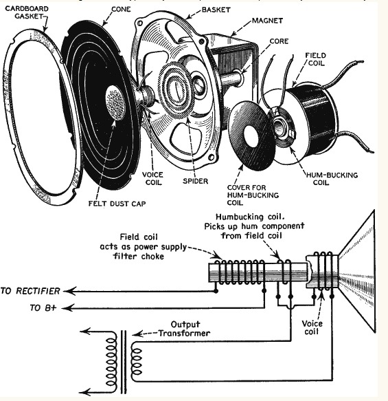

Somewhere I read that yesteryear designs used the FC as a filter choke, which seems like a recipe for hum and noise unless some kind of feed-forward noise cancellation was intended - although efficient on use of power supply current. So, a dedicated quiet supply is already a significant improvement. It's possible that some hum-bucking designs were available which might be a good idea even with dedicated supply.
They were:
https://www.antiqueradios.com/forums/viewtopic.php?f=6&t=234041
Hugo
Reactions: 1 user
