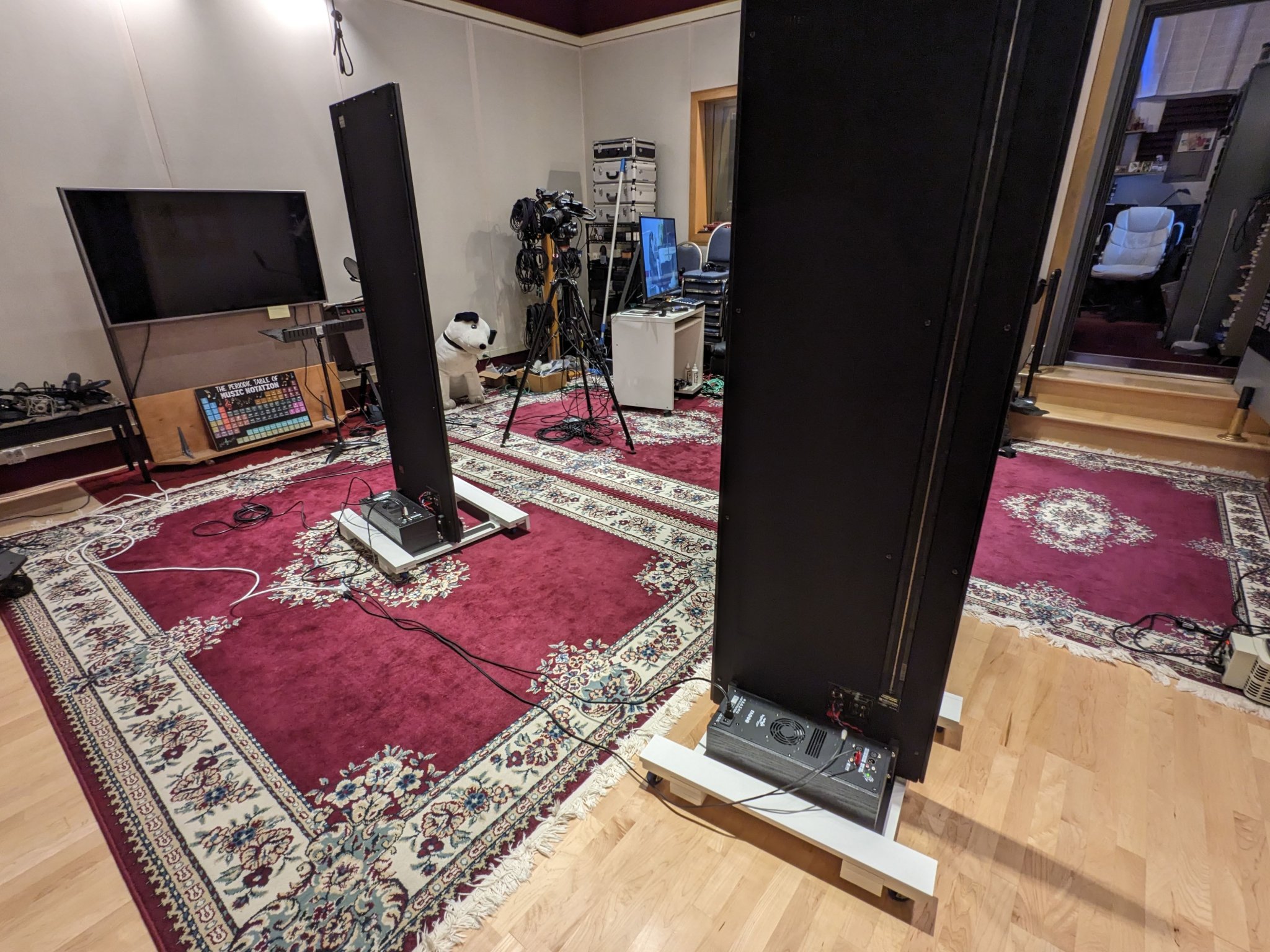

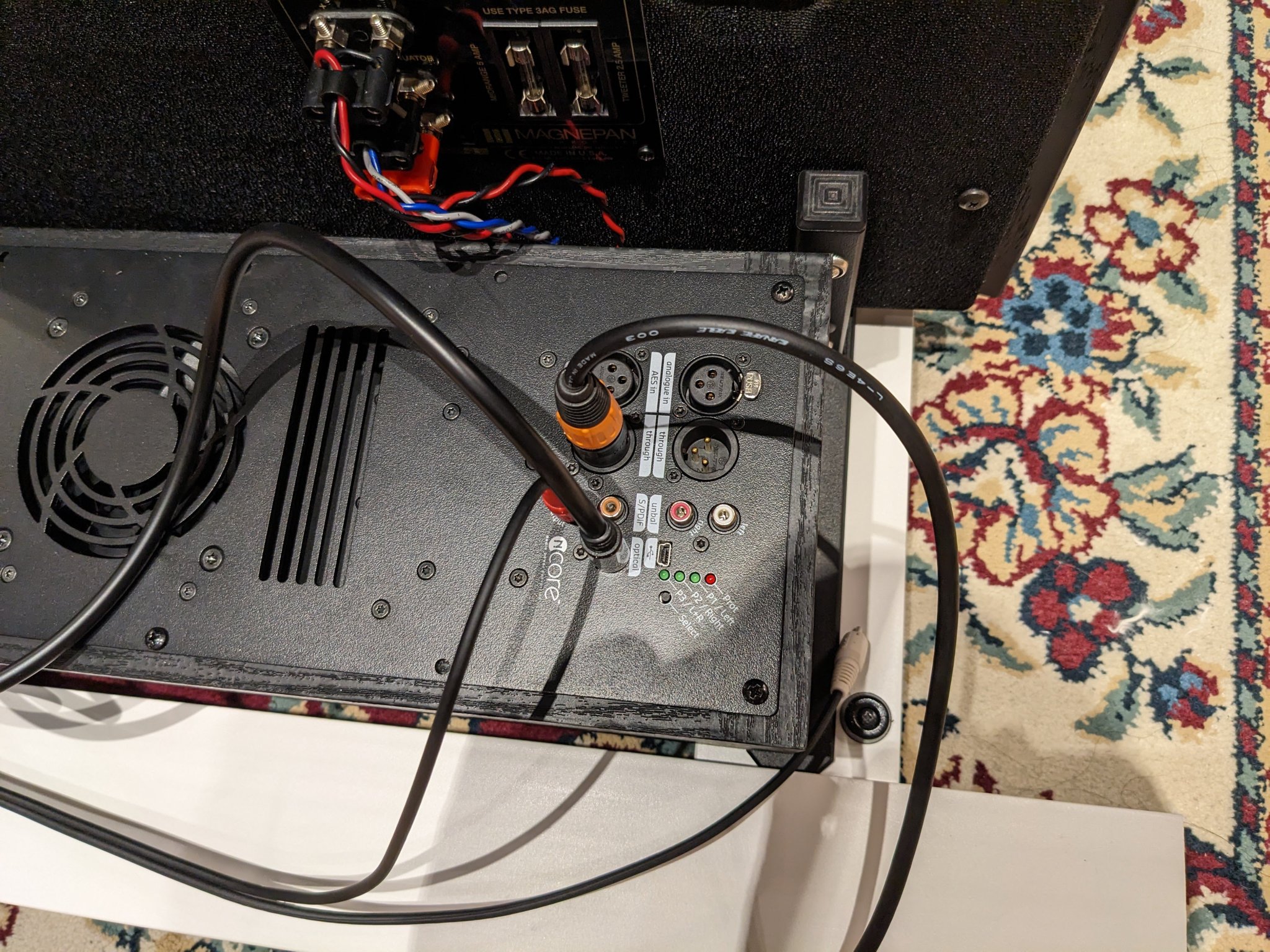

Here are a few pictures of my Hypex install on a pair of Magneplanar 3.7i speakers. No place to put them in a planar speaker. I built boxes for the plate amps and just connected banana plugs to the hypex wires. After some mods to the Maggies, they just plug in. So with separate enclosures these amps can be easily moved to another speaker if desired.I have looked at the Hypex stuff as well. It looks excellent, and I hear they are close to releasing a newer version with FIR filters and the new ncorex amps. Consider my breath bated!

Clever solution! I bet those sound killer. I might have considered that, except that I already bought a multichannel amp. Anyways, I love the look of a stereo rack, so I'm content this way anywaysHere are a few pictures of my Hypex install on a pair of Magneplanar 3.7i speakers. No place to put them in a planar speaker. I built boxes for the plate amps and just connected banana plugs to the hypex wires. After some mods to the Maggies, they just plug in. So with separate enclosures these amps can be easily moved to another speaker if desired.
My favorite speakers I've ever owned have been the Magnepan .7's, except for maybe my Selah Tanzanites that i own now (Rick Craig). Absolutely stunning sound. Just lacked a bit of bass and highs, and the dynamics left a bit to be desired. But I loved the wall of sound, and the clarity was the best I've ever heard in a speaker. Stock 3.7i's were my dream speaker, before I fell down this whole diy rabbit hole haha
How do they sound? Specifically curious about how you like the dynamics, as that was my biggest complaint about the .7's
I also felt that EVERYTHING sounded huge. Tubas sounded huge, as they should have, Hammond organ sounded huge, as it should have, but mandolin also sounded huge.. which I wasn't as much a fan of
