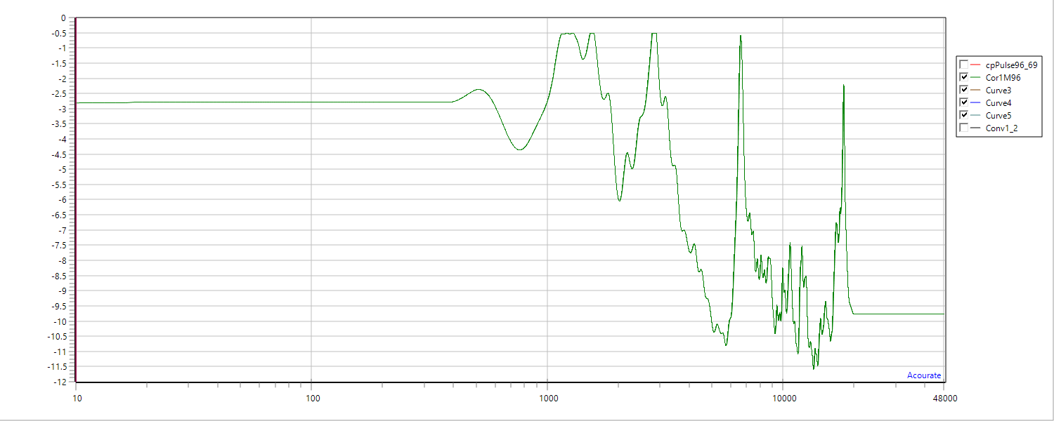

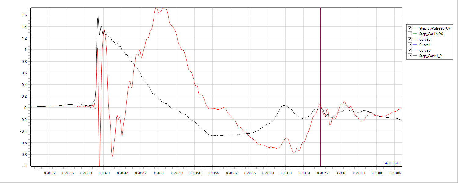

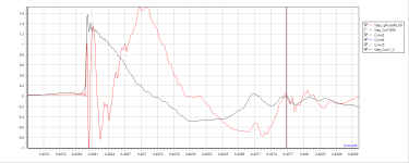

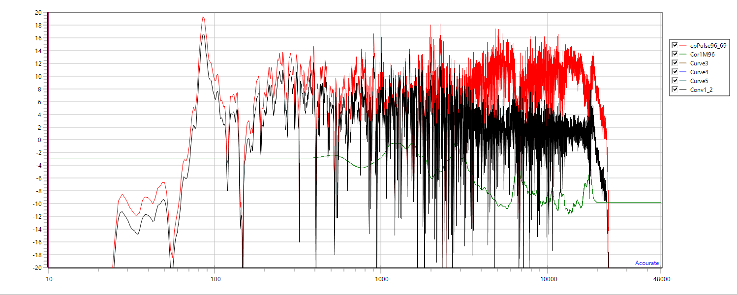

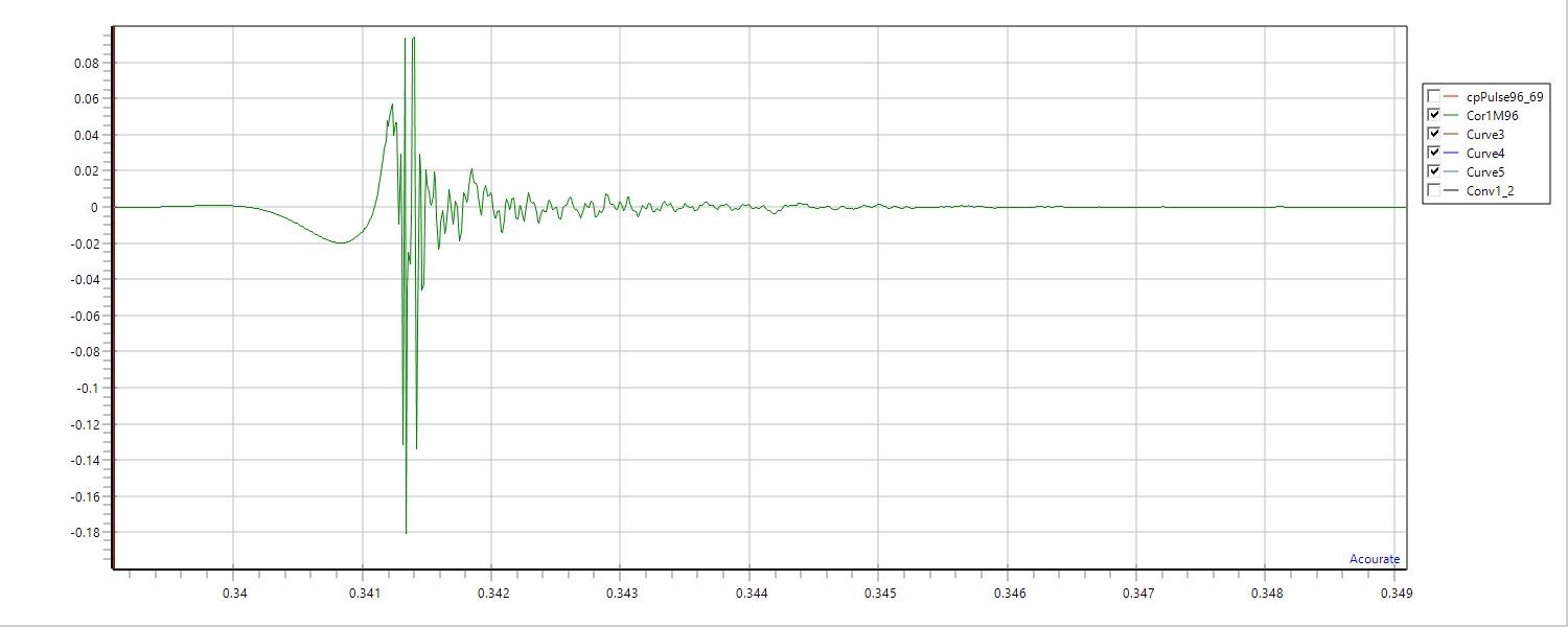

This very question points to one of THE most rewarding applications for DSP: The use of DSP to tame the typically quite wild step response of passive multiway speakers. Decently doing so, you will get a near-perfect ideal step response.
Most rewarding is to start from a well renown design, maybe from a well built vintage passive speaker, such as a Yamaha NS1000 and the like. In my use case, I have a pair of Cabasse Sampan 311 built in the early 1980's which overall perform quite pleasantly. Adding a simple DSP filter stage stage to linearize theirs phase behavior makes theirs step response simply look gorgeous. And all this beauty will set you back only by some 50$ ... 100$ for a raspberry py and maybe an IO-board.
The filter of the following example was set up also to have an effect on the amplitude characteristic. The filter itself is rather rough in this terms, but very well shows the effect on the phase. Furthermore, the amplitude graphs show all room reflections. In the phase plots, the first reflections artefacts are marked at about 3.5ms after the impulse onset.
Red: Original passive 3-Way
Black: Original x DSP filtering
Green: DSP filter (modifying both phase and amplitude behavior)
