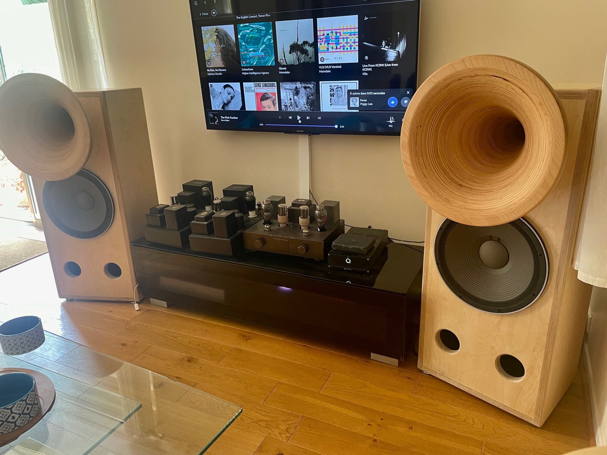

it is in perpetual move , i still have a BSS 366T modified , after a Mini DSP SHD and a LAKE processor . with a 2 way speaker TAD 1601 / RCF ND850 crossed at 500hz . but i have plan to keep the BSS only for the woofer and goes analog active or passive for the compression driver . the best sounding crossover i had was the First Watt B4 regret to sold it 🙁What is your system?
You always hear about buyers remorse. Not as much about seller's remorse. I find that often cuts deeper 🙁regret to sold it
How do you find the upper treble to sound on the ND850? I've sort of considered it to be more of a mid range driver than something that can play full range above 500Hz. Of course, I've only played with the 2.0, maybe v1 was different?

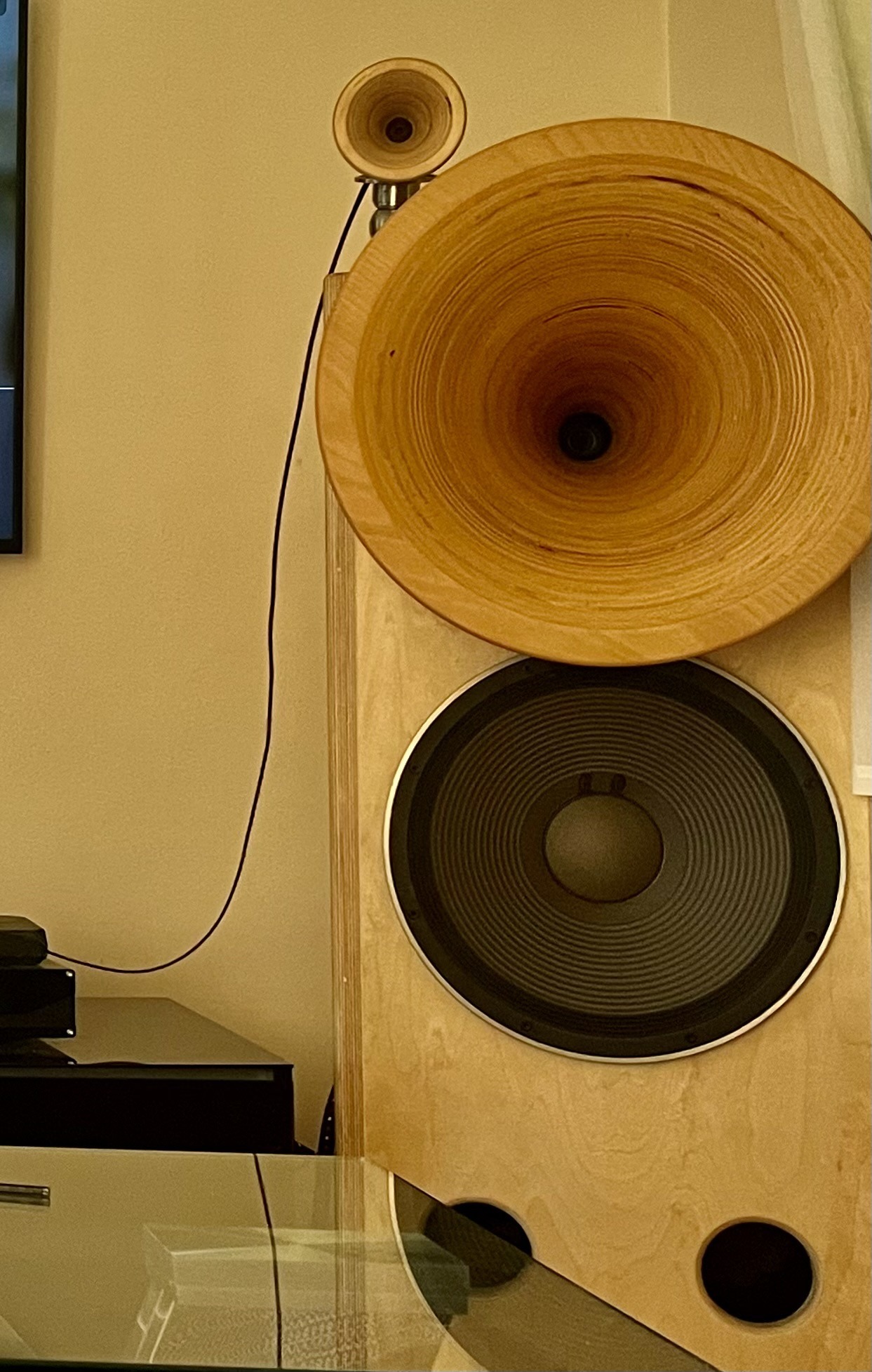

i have the actual RCF ND850 2inch find it better than my previous 18sound NSD3N as it needs no correction to have a flat respons with my horn and it goes lower you can even cross it at 800/900hz in 6db and it sounds very good . the upper treble is not the most clean i have heard but a 2 way is always a compromise . i have to find the right tweeter to use up 8 /10khz . My faital HF108 with my 1khz horn doesn't do the job..You always hear about buyers remorse. Not as much about seller's remorse. I find that often cuts deeper 🙁
Beautiful horns!My faital HF108 with my 1khz horn doesn't do the job..

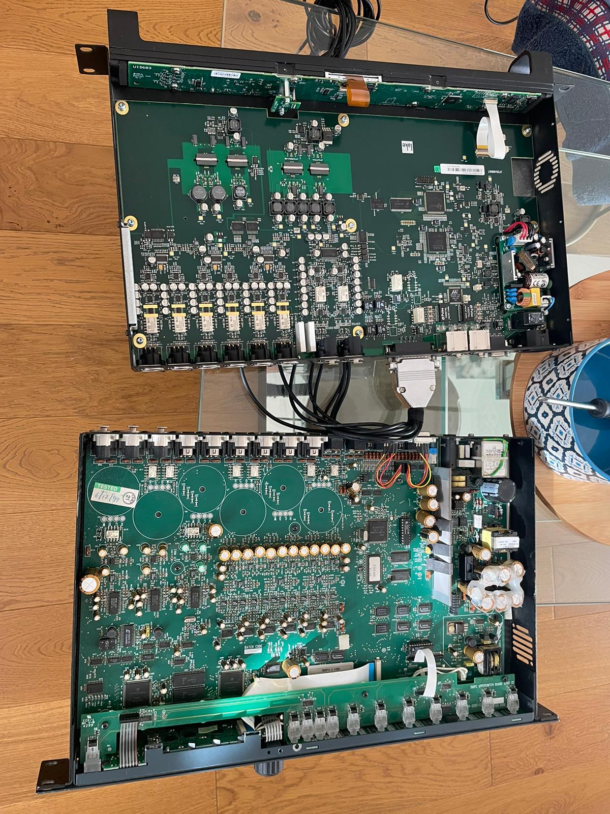

this is both the BSS and LAKE processor inside . not so different sounding after the all the BSS capacitor changed to new ones. but sure a real nightmare for analog lovers with their Smps power supply , opamp stage and electrolyte capacitor coupling 😛
I use a Lake since 10 years now. It even serve as my main mastering converters ( ADC/ DAC)... nothing to complain about processing ( the Dolby eq are pristine) and to find difference in ADC/DAC i had to target units like Lavry Gold, Cranesong, Prism ADA, Antelope,... in other word invest same amount ( or up to x4 that amount of money) to have something 'different' rather than better... the only point that could have been 'bettered' is the clock imo.
Juanitox, apologize but i don't see a Lake in this. Maybe you have Clair's brothers version ( Contour?), if that is the case converters are different from Lake ( treatments are the same though but less powerful, there is no fpga in them).
