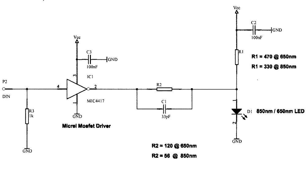

Circuit for the transmitter below...
@ Telstar
No I didn't compare it. I2S is for very short ways. Too short for my PC-DAC-distances (for me ...). This kind of fiber optic sounds so good compared to the usual cable solutions - main reason must be the complete galvanic isolation (and no usual transformer problems in this case...) - that I didn't seriously consider this way. Though it is very promising...
I didn't make this ST-job on the card. I will do it with this new parts (not quiet identical) and this circuit in my next project (Asus Xonar D2X - PCIe, shielded, separate PS or Lynx).
Have a look at Georges Wadia schematics at post #14. After P1 ST-out and Toslink begins or otherwise the usual cable S/PDIF (74hcu04)...

I will get the Ratioplast parts soon and have decided to build this stuff. But parallel I will also make a second installation of darkfenriz' suggestion. In audio, things are too different only to "belief" in something without listening to different solutions ...

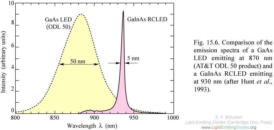

Here is a little more I picked up on the AT&T ODL-50
http://www.ecse.rpi.edu/~schubert/Light-Emitting-Diodes-dot-org/chap15/chap15.htm
Cheers George
Cheers George
Very interesting! Thank you George ...
I am very anxious to listen to the 1310nm Version with 9/125, what darkfenriz recommended 🙂 The laser is still more concentrated than in your comparison of the 870 and 930 nm.
