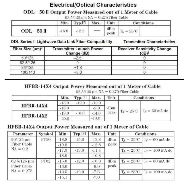

HFBR series Reciever Sensitivity using 50um fiver
Be carefull, optical fiver core size, when using 50um core fiver with HFBR series.
AT&T ODL50 II has AGC sercuit, it is no problem when using 50um fiver.
But hp is only LED, we must attach an outside circuit like hp's application note.
