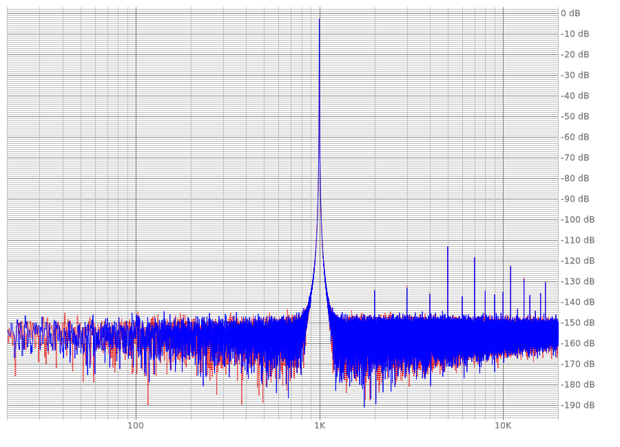

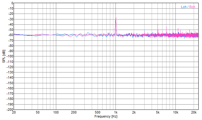

Input and output differ noticeably, Had to write a script to subtract one from another and amplify (+114 db) the difference. Here is the spectrum of the result.
Looks like SRC produces the difference. Will try REW soon.
Ahm, there is very professional tool for than, DeltaWave, and astonishingly enough it is free-ware / donation-ware, just like equally the professional REW toolbox.

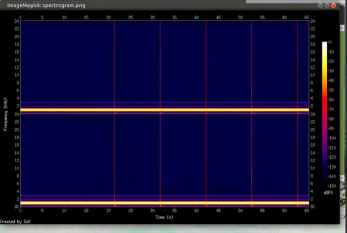

To check I2S loopback bit-perfection I use sox spectrogram, to view a clean sine generated e.g. by sox. The point is just a single sample once per many seconds can be missing or corrupted, and viewing FFT will not reveal it. E.g. this is a missing sample every ten secs (digital loopback where the USB-host driver did not honor implicit USB-async feedback correctly):

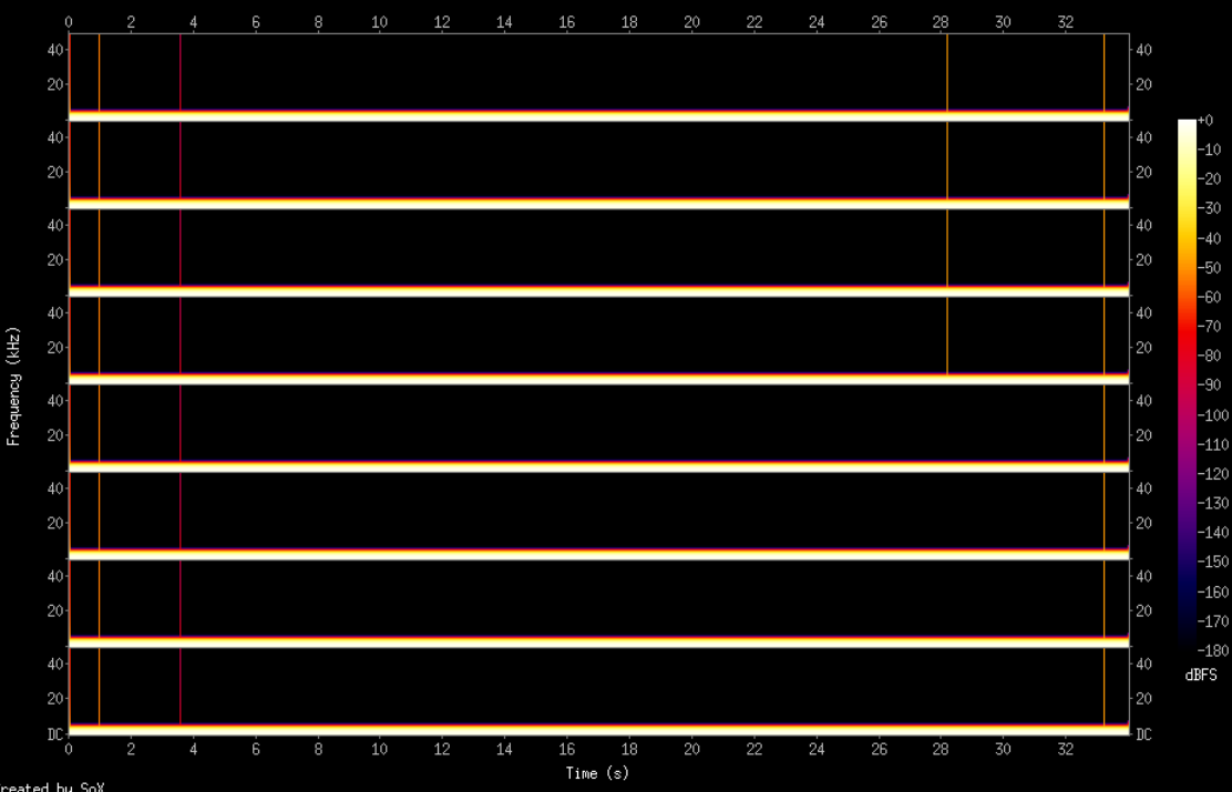

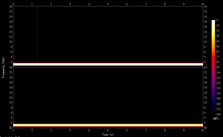

Sox spectrogram is extremely revealing - this is one 16th-bit flipped (using a hexa editor) in a 10-second 32-bit stereo wav:
Also for testing USB interfaces it's good to pick a frequency which does not place complete periods into USB frames (i.e. not using multiples of 1kHz) for which a dropped USB frame would produce no detectable discontinuity in the stream.

I am not sure I understand. The X axis is time of the stream, not frequency as in an FFT chart. A single dropped sample on standard FFT will flicker and get overwritten by new FFT chart. Even if averaging is used, it will not be able to tell when/where in the stream the issue happened. Seeing the time dimension is important when checking for bit-stream perfection as it allows to relate the issue to its cause. E.g. the very regular interval of the issue on the first spectrogram directly suggested some regular buffer over/underflow was hapenning (in fact caused by overflows of the receiving buffer in the playback direction as the USB host was sending data too fast, due to ignoring the implicit feedback provided by the capture-direction stream).
Seeing frequency of the issues shown on the spectrogram helps when fine-tuning system params to minimize/avoid alltogether the issues (did a change make some improvement?)

What I'm seeing in the data is this:
  • input and output files appear to have been mistaken, in is out and out is in
  • (true) input file is clean, and properly dithered
  • (true) output has some low level harmonic distortion -- which should not be there -- but is otherwise clean as well, there is definitely no syncing problem or the like. So that's the good news ;-)
Subtraction does not work reliably as we don't know how the files align in time, a marker pulse (for example one single full-scale sample in a zero crossing of the source file) is required for exact alignment. When not time aligned we can only "shape align" by trimming to zero crossings but then the diff would show the dithering delta if we are off by any number of full periods.
If @SergeG could redo the test with a marker pulse in the input file so that the two files can be correctly time aligned we could hope for more insight from the diff. Ideally, it should be true zeros all the way... if not, some processing happened in between and most likely it happened in software**). As mentioned, it is mandatory to bypass the Windows audio mixer, either by using WASAPI exclusive or by using ASIO.
**) the input stream is fully saturated, max/min sample value is +/- 8388607 (2^23 - 1) which means there is no headroom left for re-dithering of the positive peaks and only 1 bit left for the negative peaks. That might explain the distortion.
I suggest not to saturate the input stream, give it a little headroom like 0.1dB or so to avoid these kind of problems.

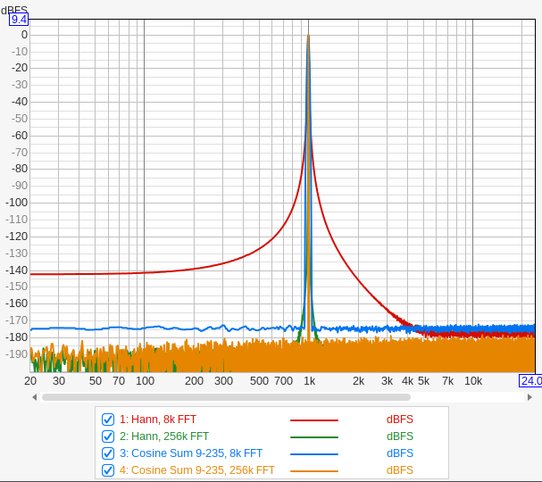

If so, FFT improper windowing is the only reason?
Yes, it seems.
The only way I could provoke similar display to the ones shown in initial post is using way too short FFT size of 8k together with Hann window.
Showing the distortion-free input file to the loopback process (still named "out", maybe because it was named from I2S perspective) :
But the issue with the recorded file still is there, it should really be bit-identical to the source file when exactly time-aligned.
Thank you! Actually REW shows the correct spectrum. I honestly didn’t expect such Hann windowing behavior. Actually it’s the first digital loopback I was testing. I never faced the problem with ADC/DAC measurements probably just because the analog loopback noise level is higher then the self level, so thought my measurements tools might be fine for digital loopback measurements as well, but they are not.
