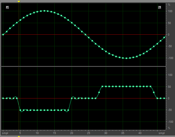

With a bit of in-depth analysis, I can now describe what the exact symptom is.
It looks like a numerical/math problem somewhere in the chain, most likely in the Windows mixer and related to dithering (please do the suggested checks with REW, 0.1dB headroom and WASAPI exlusive modes).
On average, the output file (recording of loop-back) is systematically 0.5 bit levels too low once the input file is beyond positive half full-scale (+0.5), and it is similarly 0.5 bit levels too high for negative values below negative half full-scale (-0.5), but with a 0.25bit intermediate offset at the transition.
(Bottom trace is the difference signal amplified so that 100% represents one bit level)
This now explains
a) the ever so slightly lower level of the output
b) the residual distortion
That's why we see both the fundamental and the distortion components in the difference signal.

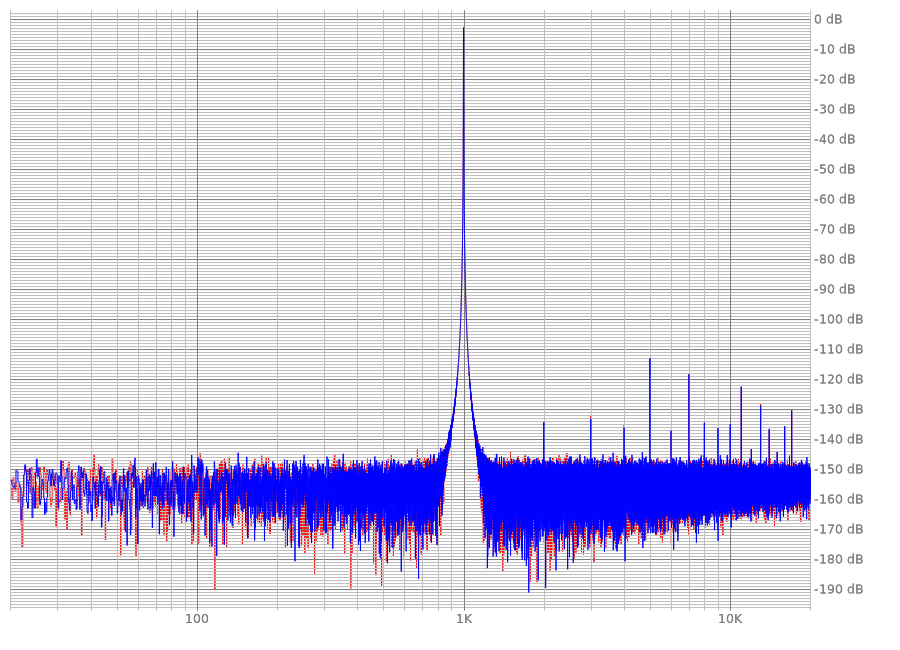

That certainly doesn't look right to me.Here is my FFT of in.wav (256K points, Hann window, and 1/64K-octave filtering). It is showing a small amount of harmonic distortion.
Ed
The full scale level does not reach 0dBFS, the noise floor is too high and the distortion components are too large as well (but at least match in relative levels)
Sounds like a float->int cast in C, which uses truncation by default rather than rounding. Very odd. Also wondering how you can have half a bit of error in a digital signal(!)This now explains

My FFT is filtered with a very narrow filter. I adjusted the gain to place the fundamental near 0dB. The noise floor is in the right place for 5 seconds of 24-bit audio.That certainly doesn't look right to me.

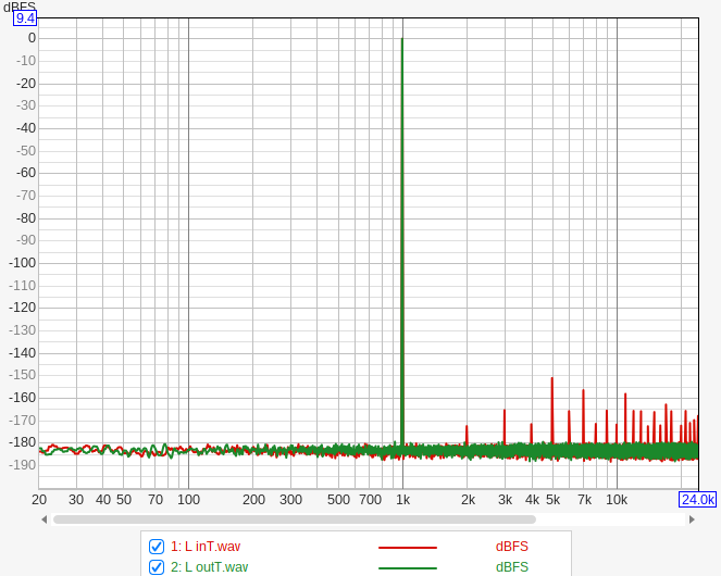

@KSTR >(please do the suggested checks with REW, 0.1dB headroom and WASAPI exlusive modes).
My results of trying REW unfortunately differs from
https://www.diyaudio.com/community/attachments/1732134971225-png.1382971/
The shelf produced by low points FFT with Hann is pretty reproducible, but I can't see the harmonics you observed probably because of the high noise floor even on the same WAV files (REW 5.31.3) What kind of FFT settings you used? I have tried almost everything without a luck. All the harmonics (if any) are drowning in the noise. Looks like I need to start from your results first. Specific averaging/smoothing?
Also I haven't found a way to combine/merge several spectra into a single image (to send to you for instance). I'm definitely missing something important in the use of REW. Could you please assist

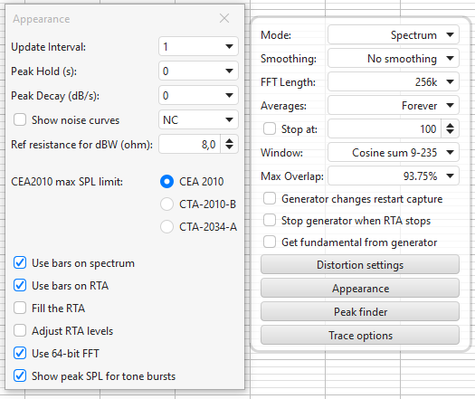

Thank you! "use 64-bit FFT" was causing the difference. My plan is checking -0.1db (or lower) level for the harmonics influence. And then I'll be trying to verify SRC presence. Eventually I'll be able to find an independent I2S source to use as the input for the SA9227. But it's still foggy for me to verify the finally received sample rate at the software side (i.e. after the driver). Any ideas? The datasheet is too weak/short/laconic to mention SRC or so, modern 51-family MCUs (not ancient 8051 exactly) are powerful enough, driver may perform SRC as well. Anyway I'll try to verify if you don't mind

But if I switch “Lock generator to RTA FFT” on, all the harmonics disappeared completely, pure noise at the low end. And no harmonics appeared with the input level variation.
That IMHO means there is probably something foggy in FFT windowing.
So FFT specifics is rather than SRC involved into in.wav spikes
Moreover while I was trying to reproduce FFT from in.wav with precisely your settings I observed a bit different result (the same harmonics of course, but different noise curve width below -180db) To get exactly the same spectrum I had to decrease FFT size to 8 – 16k from yours 256k.
That also confirms there is something strange in FFTs of different REW versions.
