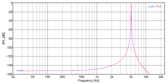

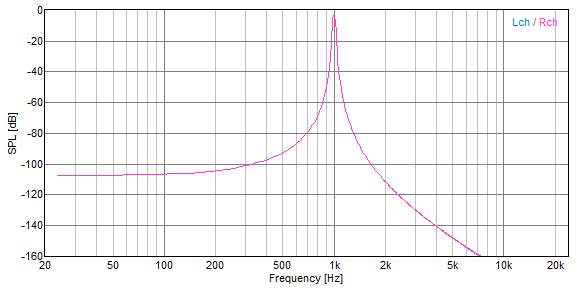

Hello,
Recently ordered SA9227 based USB ↔ I2S converter and decided to check distortions of the converter itself making I2S loopback.
The results look strange to me. I expected a symmetrical spectrum, but there is always a horizontal “shelf” on frequencies below the test signal.
I would admit the shelf on the both sides or downward curve on the both sides (of the test signal) as well, anyway a symmetrical curve.
The “shelf” goes down with the test signal frequency increasing and goes up with decreasing.
The “shelf” goes down with FFT size (quantity of points) increasing and goes up with decreasing.
What could be a reason/explanation of such behavior? The converter specifics? The measurement specifics? Something else I’ve missed?
Thanks in advance,
Serge

Hanning, other methods produce obvious artifacts. Size - tried various, that one was taken on 2048. Using 16384 shows the same shelf just at a lower level, the shelf level is signal frequency dependent anyway
That curve is definitely spectral leakage, perhaps you haven't accounted for the latency in DACs/ADCs and prematurely started sampling. You want to send continuous sample stream and only start reading samples say a few ms after it starts - my guess is you are seeing leading zeroes in the loopback which would produce spectral leakage like this.
Audio sigma-delta converters have dozens of samples latency each way, they are not like flash or SAR converters commonly used for other signal acquisition uses.
Can you describe the loopback in more detail. Does your board support both I2S output and input?It's pure digital (I2S) loopback.
Ah, is the signal generated isochronous to the FFT sampling? If not you might just be seeing the Hann window spectral leakage. Can you use a higher performance window function? Or up the size of the FFT considerably, like 256k points?There are no AD/DA conversions at all. It's pure digital (I2S) loopback. Also the FFT is alive, taken periodically/continuously, not momentarily, So it's still a puzzle
I find high performance window functions (very low side lobes) essential when analyzing high-precision audio signals asynchronously, I recommend reading this: https://holometer.fnal.gov/GH_FFT.pdf - it covers very clearly some of the issues glossed over all too often in material about frequency analysis using the discrete Fourier transform (i.e. FFTs).
The "big hammer" approach works well too. I run 4-32M point FFTs with a Hann window. A modern computer is a very big hammer. 😉

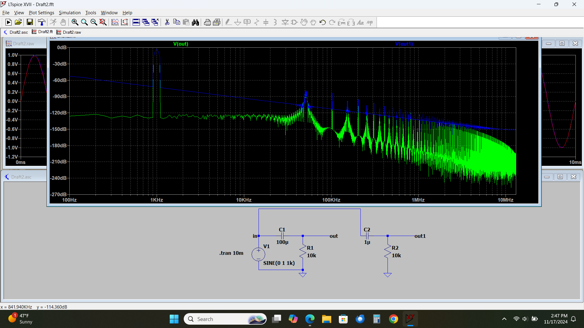

I have noticed a similar effect on simulations of circuits that have high-pass, lack of low frequency response.
