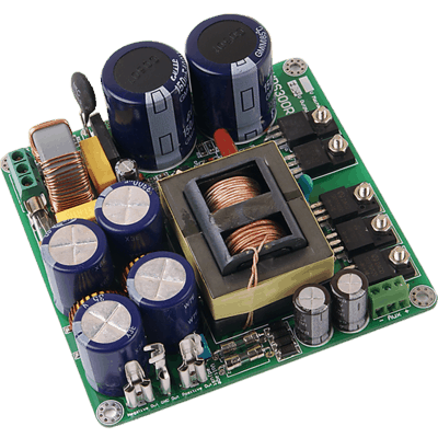

Right now I'm testing my second FetZilla with a 300 Watt SMPS.At high volume it stays at a steady +- 35Vdc.

Well, 2 years since I stuffed the boards, & then got stuck... Having some post surgery recovery time on my hands, thought it's time to kick along a few unfinished projects. My problem is that I'm too tight to buy a dual secondary transformer, having a shed full of otherwise suitable units. Has anyone built the amp using a 'conventional' CT transformer? I'm thinking a better way to go may be to use two transformers, with Full wave rectification on each - I can build the power supply off the PCB up to C15 & C17?
Any motivational thoughts appreciated...Cheers
Hi Peter,
You can buy a couple of the Altronics 160VA toroids, 2 x 25Vac secondaries. They are about $48 each as I recall. Alternately you could look around for EIs at the trash and treasure meets, but you have to have two separate secondaries since a CT version will not work.
The problem is that you'd have to rebuild the power supply for a CT trafo. I have been using CT power supplies for decades until I tried a non-CT system and then discovered it's much quieter.......
