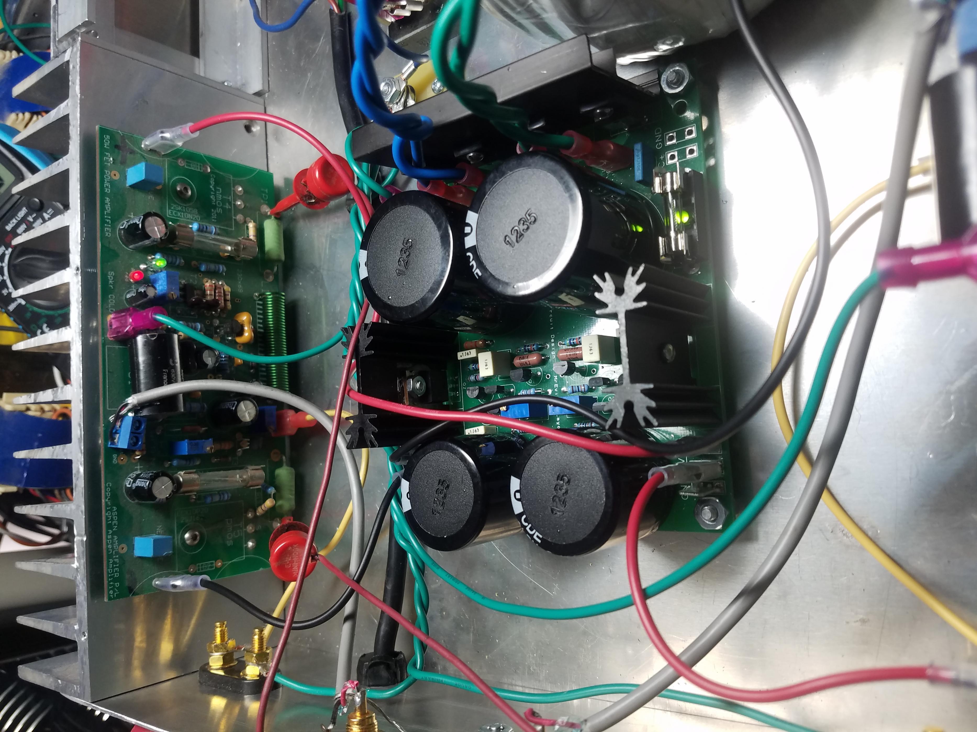

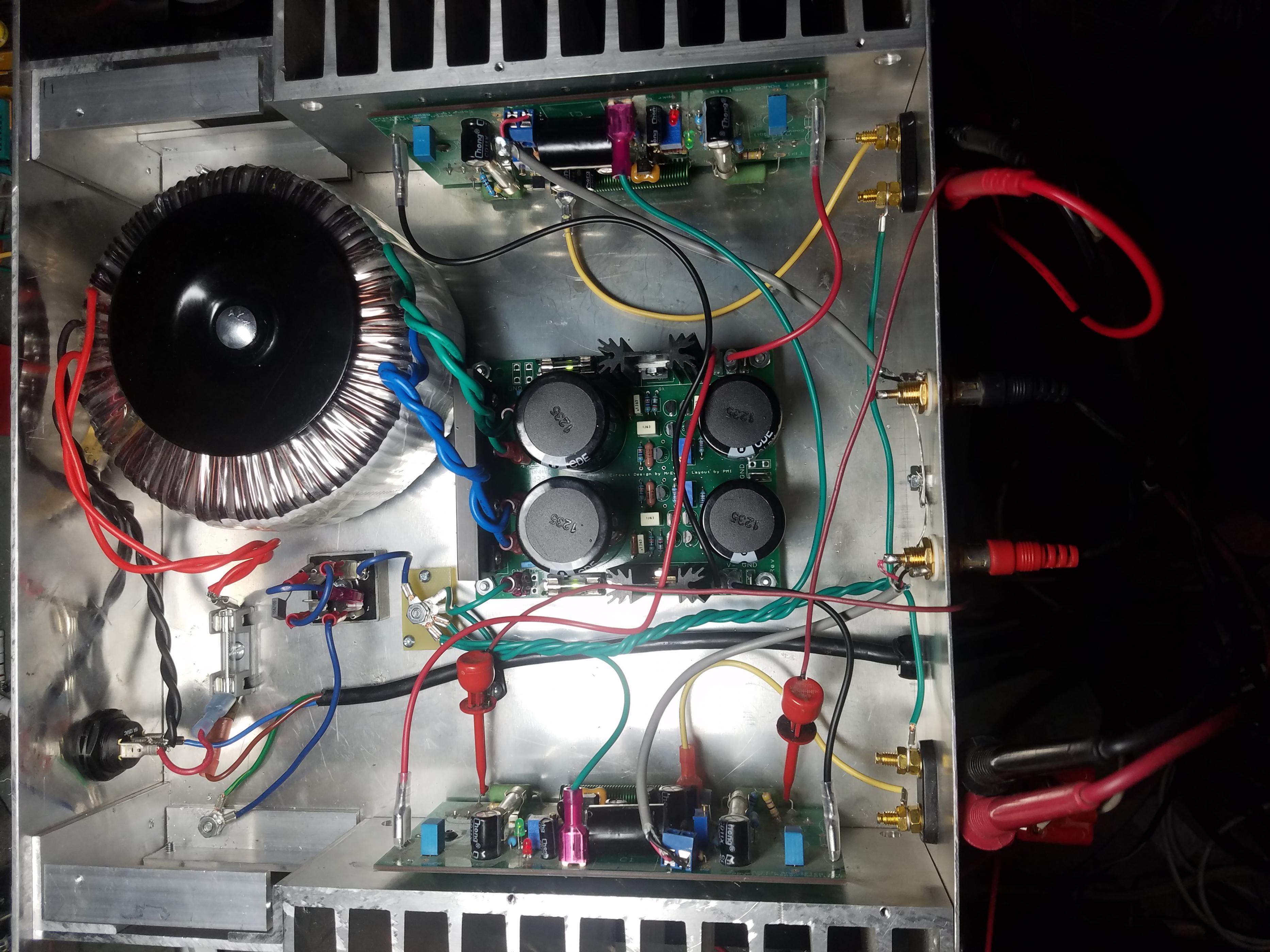

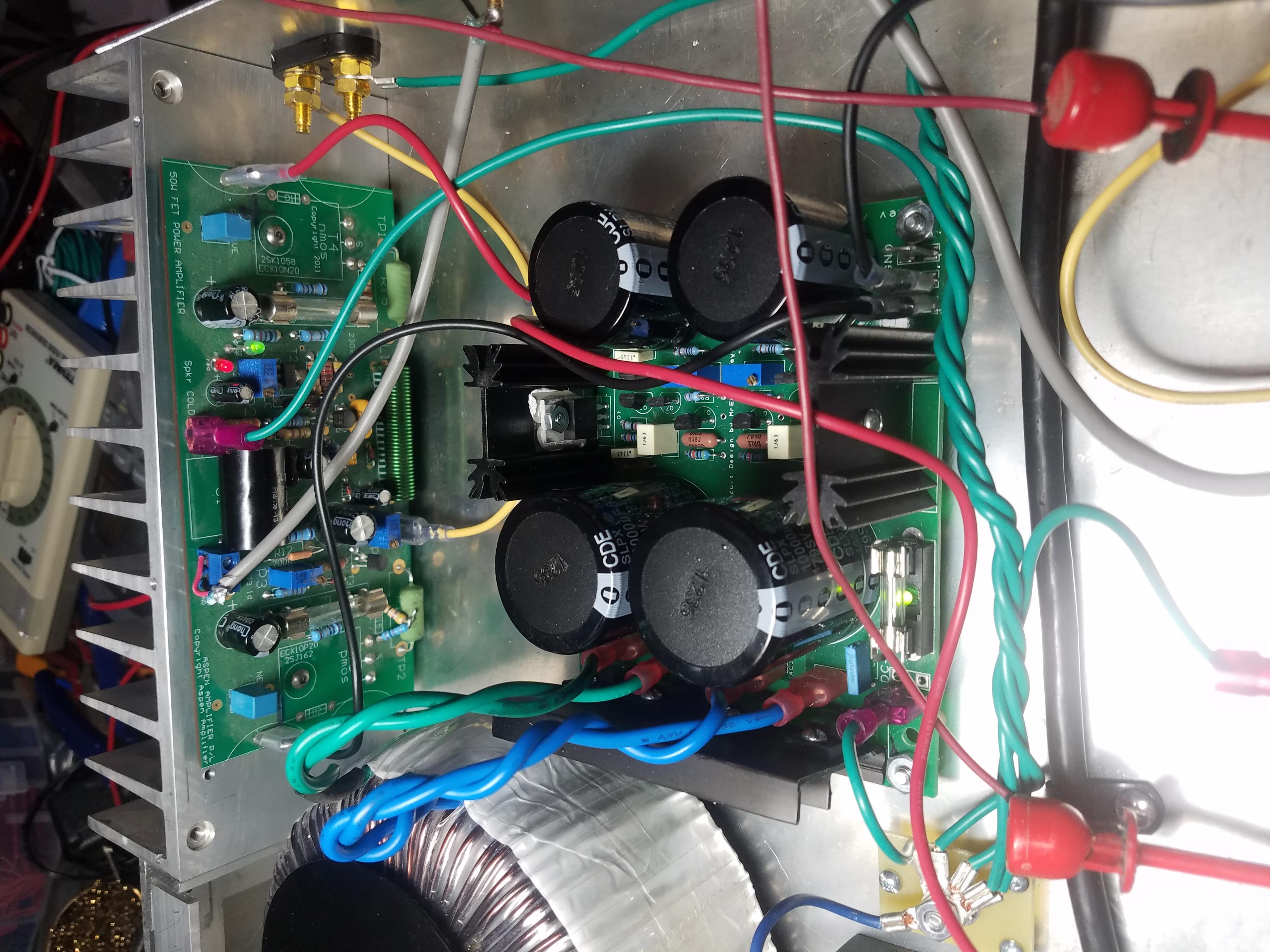

After all these years I finally installed the FETzilla in a case. I gave up on the idea of using an SMPS. I am using a 600VA 28/0/28VDC transformer and a Mr Evil cap multiplier for the PSU. It is outputting +-36VDC. I'm running it at 330mA bias. The heatsinks are running about 40c playing loud so I think I am ok even though they are maybe a little smallish.
The amp doesn't look great on a scope but it sounds quite nice actually. The offset is all over the place. I have been chasing it for two hours and it wanders quite a lot. If I zero it, a half hour later it will be at +-80mV. I know that won't hurt anything but it's just weird. I'm going to stop chasing it and just let it wander.
Does your cap multiplier get hot? Both channels sharing the same transformer secondary?
I'm not sure. I didn't stick a finger on it. I'll check for that tomorrow. It's only dropping about 1.5V. It's been so long now I don't remember how many amps it's good for. I'll have to look that up.
I looked it up and the Cap multiplier is rated for 5A so it should be fine but I will check the heat.

Hi Terry,
If the cap multiplier is fitted to the FetZilla and the quiescent is only 350mA, then two channels would draw about 720mA at idle and bounce up from there with music signals. I would not expect much heat from the cap multiplier because the total idle dissipation would be 0.72 x 1.5 = 1.08W, almost nothing for a large series pass transistor, maybe an average of about 3W passing heavy music.
Very different to a Class A like the Alpha Nirvana which will be passing and average of 1.7A and up to 4.5V across it. That is 7.65W and you'd really notice that.
The offset issue is a nuisance but based on past experiences with singletons and bipolars, it seems to be caused by the heavy tempco of the jfet input device and mosfet VAS device. Small temp changes there will cause big changes on the offset, and its origin is first and second stages, not the output stage. Understandably this could be improved; but to do it, and improve the depth of image as well, the best way would be replace the mosfet VAS with a bipolar, like a KSA1381. I believe a bipolar is far better for the VAS role; it has much more transconducance and therefore more accuracy than a small mosfet.
