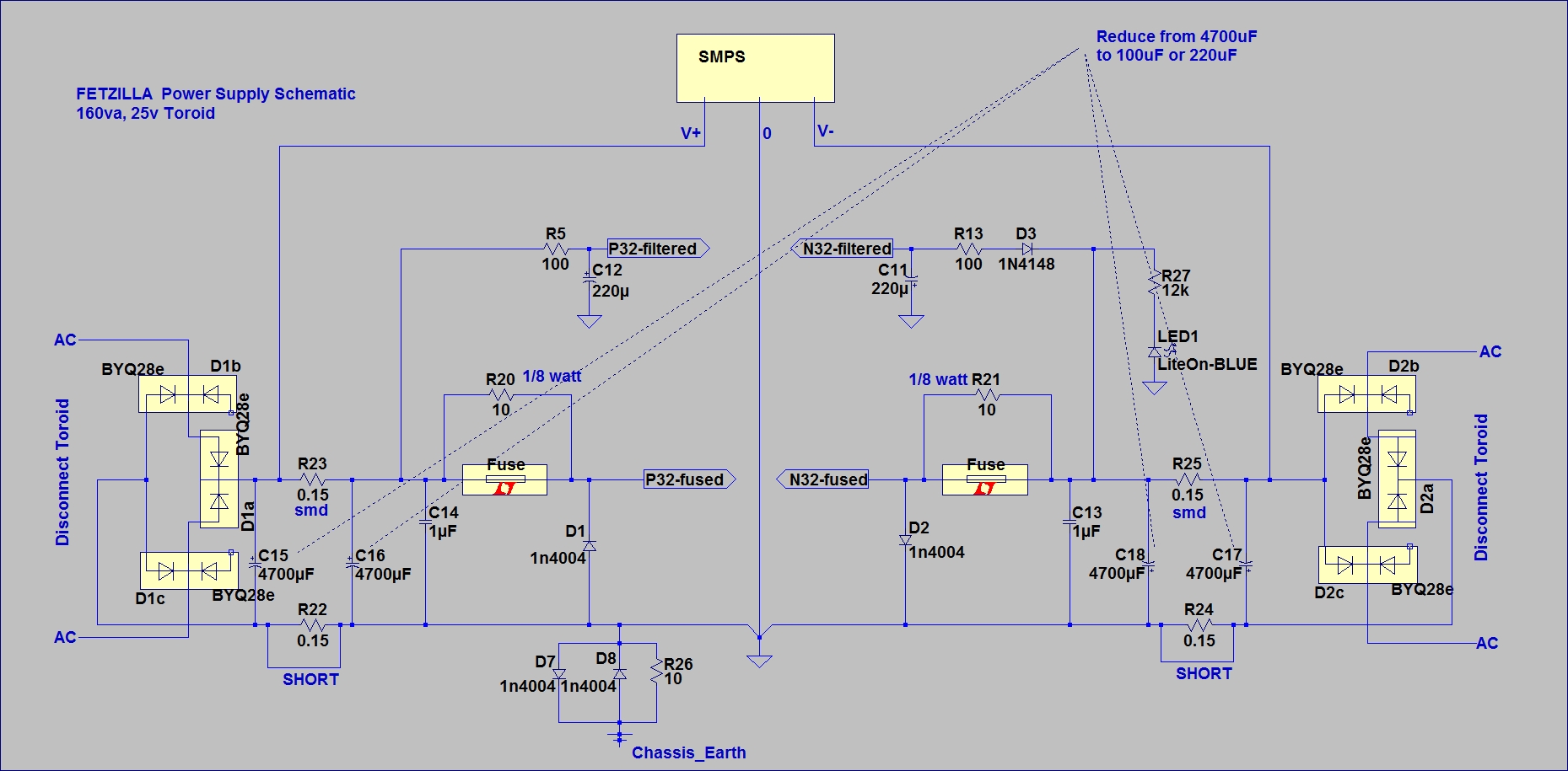

Has Patrick been the only person to use an SMPS to power one of these? I am planning to go that route and have one on order. However, if you guys think the sound will be better with transformers and the on-board supply I would like to know. Looks like I have time to gather those before I get the boards.

A number of people have raised some questions re the FETzilla, so I'll attempt to give my view on all of these:

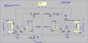

1 - If you want to use a SMPS, then I'd attach it as shown in the attached drawing. I wouldn't cut off the rectifier and capacitor section of the FETzilla PCB, but just reduce the size of the on board capacitors. As most SMPS have a common ground wire, this will need to be connected to the speaker ground connector, and resistors R22 and R24 shorted out. If the rectifier diodes are not fitted and diodes D1a and D2a are just linked across, then the SMPS can be connected to ONE of the AC spade connectors. Some SMPS will not start if they are connected to a large capacitor, so C15 .. C18 may need to be reduced in size, perhaps 220uF to 1000uF. Keeping C15 .. C18 provides some high frequency filtering between the SMPS and the two amplifier channels, so they are worth keeping.
Hi Paul,
Have you actually tried using an SMPS with your FetZilla or are you making assumptions?

Excellent answer on the SPMP
Cheers Paul for that comprehensive answer on the smps. I was reading this thread just then with the intent to ask the question you answered. Excellent!
I've a smps on order so I'll give these alterations a spin and report back in due course.

Regarding the SMPS I will perform a test my way and Pauls way.
