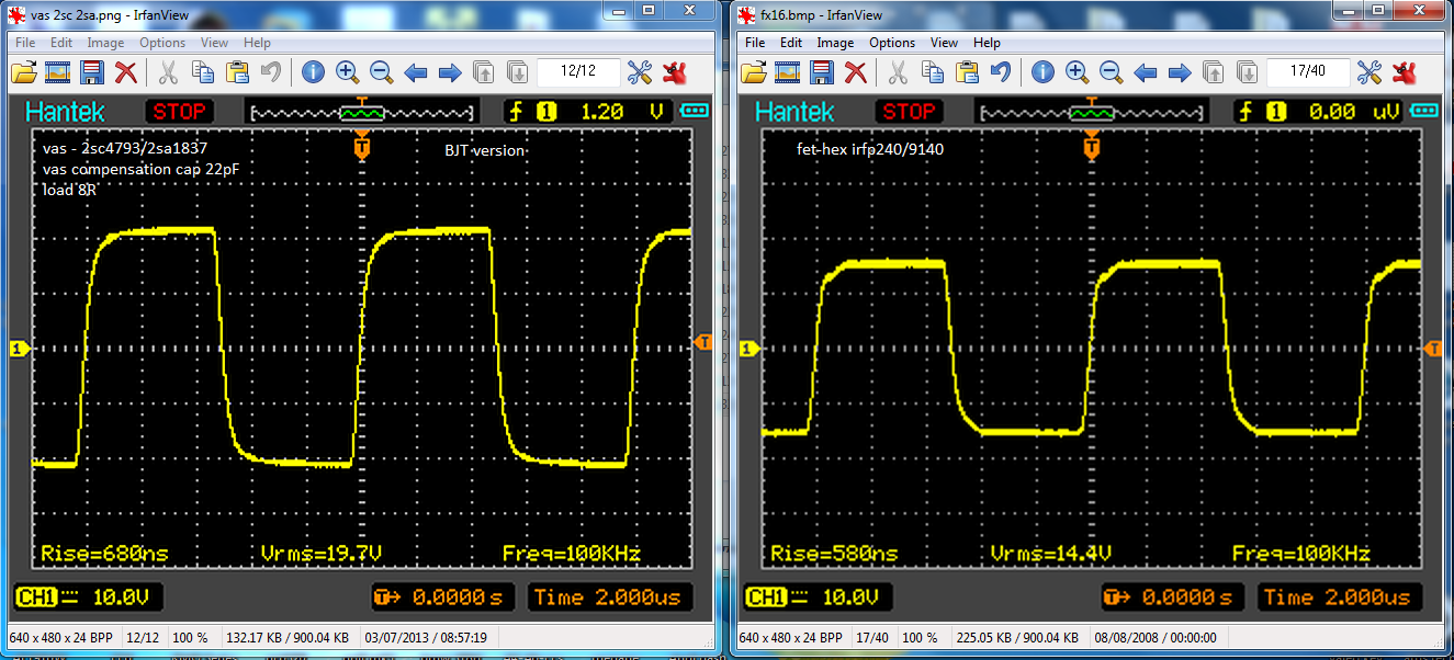

As I promissed. Prototype schematic bellow.
The C15 and C16 are not required (100pF), only the 33p are needed (reducing small overshoot on pulse response).
I have try some higher voltage transistors for vas and input stage.

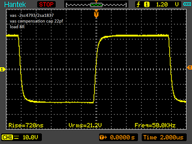

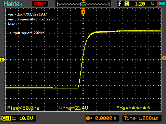

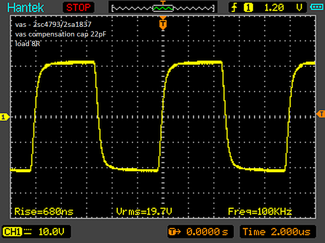

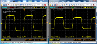

Today I have soldered vas - 2sc4793/2sa1837 with 22pF compensation cap, results bellow.

Yes instead off bd139/140, so I have putted same transistors in vas and driver stage
