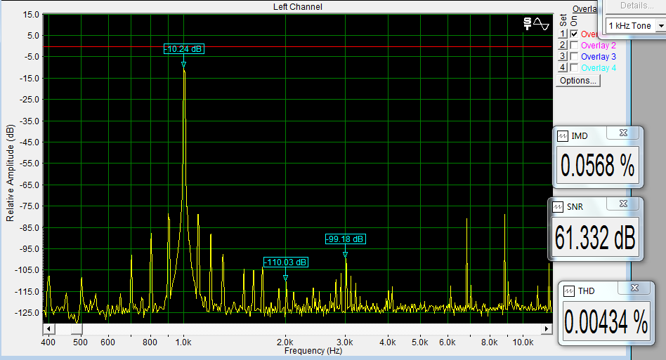

borys' FFT post for the BJT version, shows relatively high odd harmonic distortion, especially 7th, 9th, 11th and 3rd. This is the kind of profile that many Audio gurus try to avoid to get a more euphonic sound; Nelson Pass, John Curl, Dean Hughes, Hiraga are some of the examples.
Is there a way of either reducing the odd harmonics or relatively increasing H2? IIRC I have seen some techniques around here which load the input pair collectors with a resistor to ground.
Do not worry about higher order harmonics products, these are my sound card artefacts.
I have measured symasym apex ax14 and plenty vssa different variants. On all my measurements there are the same artefats present (all amplifiers at the same place).
I must upgrade or buy different sound card for measurements.

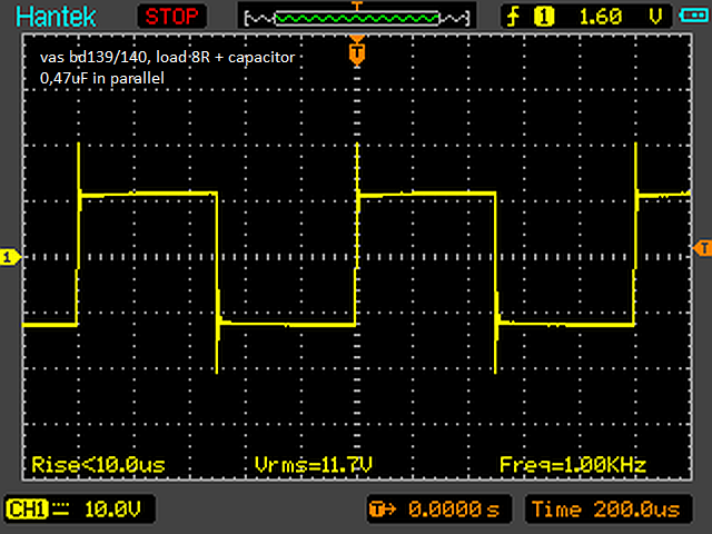

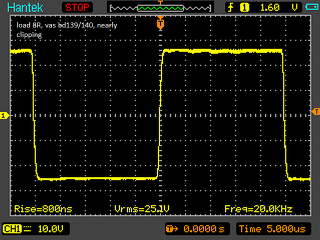

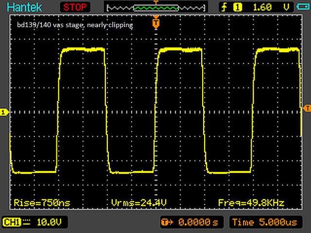

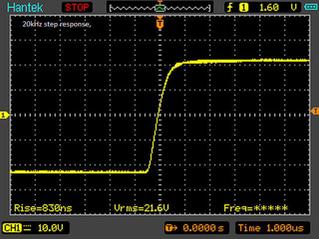

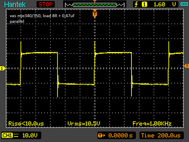

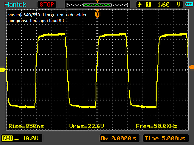

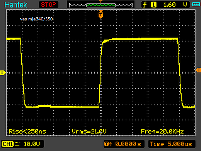

I have made some tests today.
Cause bd139/140 pair is not very high voltage friendly I decided to put mje340/350 (Yes I know that people do not like them), I only forgotten to desolder compensation caps (mje are slow enough to work without them).

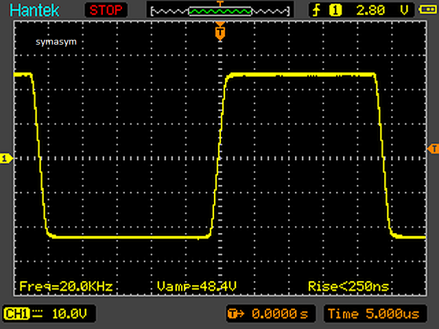

Bellow test results , 8R load. Just tu compare last one is symasym square at 20kHz.
I think this topology is wort to develop further.
