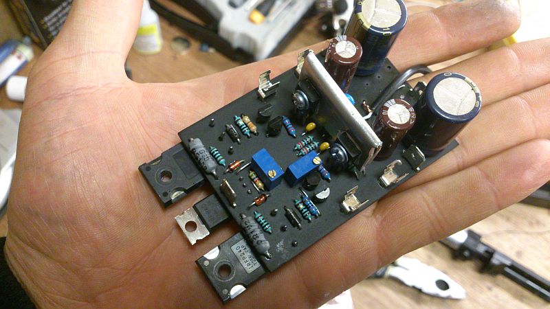

Presently I am making basic version form first post. Yesterday I made pcb, but I see it will be much work with drilling - I made 6 chanels for active speakers
I think amp is so simple i look so good on measurements so its worth it do it

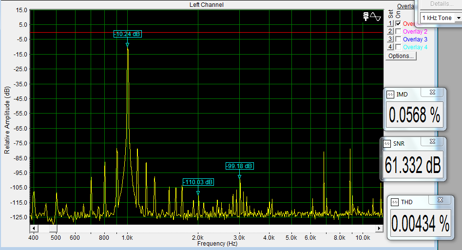

Bellow results:
THD
Measurement is allways with amplitude 20V just to compare ....
Artifacts notwithstanding these are very nice results congrats 🙂
20volts - is that rms, peak or pk- pk ?

20V is output amplitude (p-p voltage).

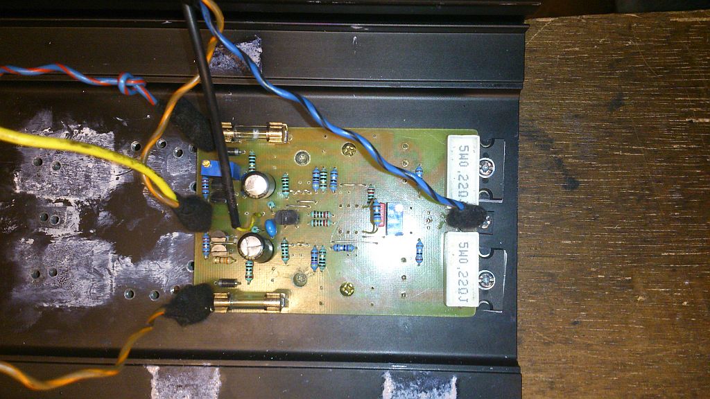

Hi Borys,
Can you share the layout version as per attached photo, i could not find the same version on the photo have been posted.
I advice you to build version v6.1.
But anyway there is board v2 (prototype from the first post).
Version v7.1 is with bootstrap and multiple pairs of outputs (just cutt one or two pairs off if you do not need more).
I didnt have a chance to build v7.1 board so far but it is upgraded v6.1 (few more pairs at output and bootstrap)
If you need higher supply voltage make sure that input pair is replaced with something else.

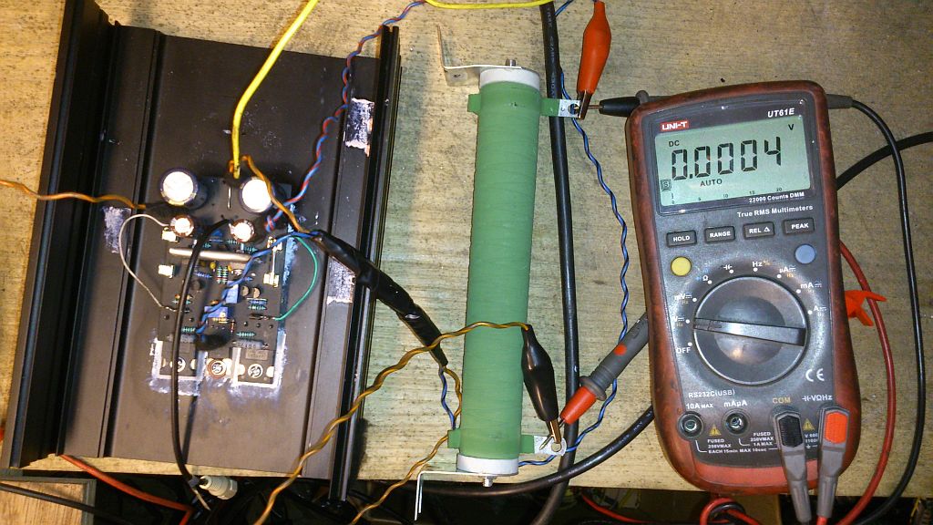

Very nice offset,...

Another version prototype board.
Outputs 2sc5200, 2sa1943, I have made some pulse response tests and must say this is the fastest bjt I have ever had.
I think I can make and universal board that irfp and bjt outputs can be used.
I have made one version with irfp and bd139 as bias compensation and this should work.
When I find some time I will post results.
The bd139 and 140 arent the fastest devices but cheap and availible everywhere. I might try somethink faster in vas stage.

There is no thumb plop on power on, amp is dead silent with input not connected (even if you stick the speaker into ear).
