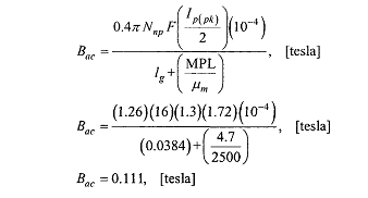

2) Can I use the equation given in McLyman for the calculation of Bac? the equation is.
in the attached picture file.
Hopefully I will answer these in order...
1) Yes... But since the fringing flux and air gap affect each other you will iterate the air gap until you reach the calculated Lp.
2) Yes that is correct.
