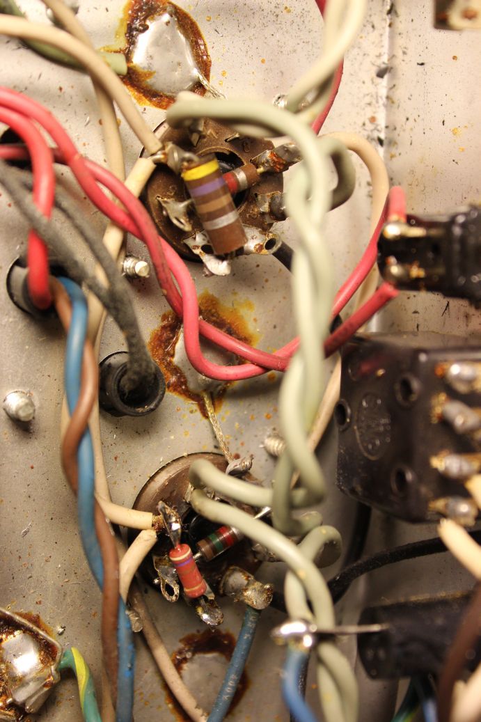

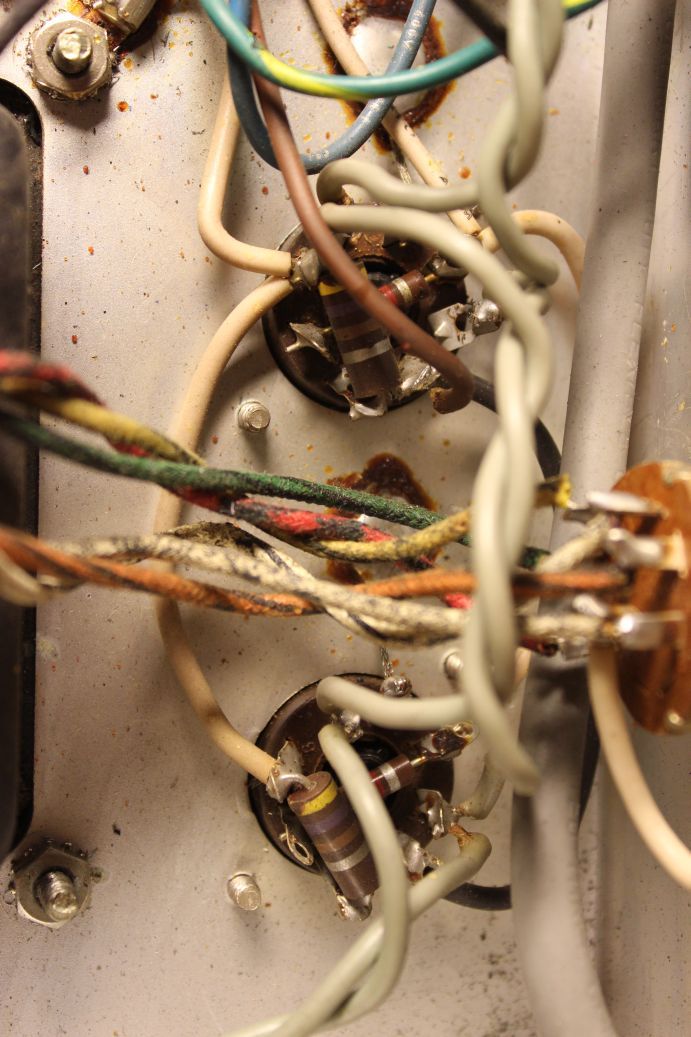

Can you take a nice clear picture of the power tube sockets (6L6)? Maybe even one picture of V7 V8 and one of V9 V10. The side with the wires attached of course.
If there is no voltage drop from the standby switch to Pin 3 it means there is no current flowing. Something is not attached somewhere on that side. Me thinks.
Yes, I believe the wiring is good.Thanks. Those sockets all look to be wired properly. The cathodes are certainly grounded!
