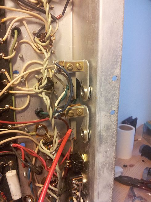

I mean connect the 8 ohm to where the red gripper is hooked, and to the other contact surface in the plug-socket (ground?) (Pic-1)

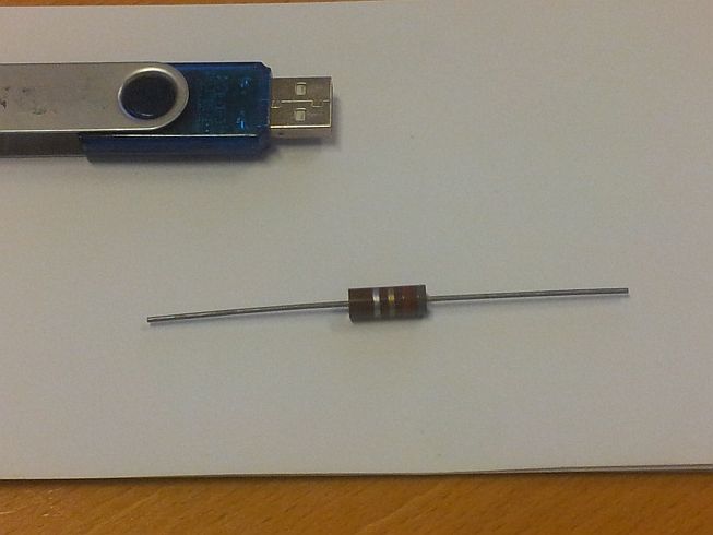

I found a couple of 8.2 ohm (gray,red,gold,silver - pic-2 USB-stick for comparison of size) - I guess it will suffice?

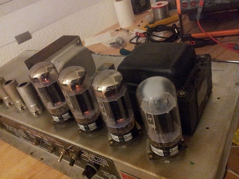

The new tubes (Tube Amp Doctor, 6L6GC-STR) were mounted, and power was switched on and after a short pause, out of standby. Tubes were looking good with same glow on all 4.
The amp was then hooked up with speakers and a Hammond and a guitar, and yes, we have sound...
But... not very loud, though, had to turn the volume dial way up to around 7-8-9 even to 10, and you were still able to talk, which I doubt is possible with close to 100 watts filling the room.
Also significant distortion is noted.

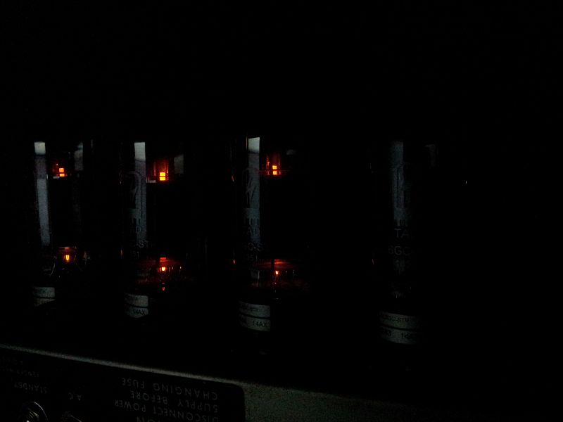

At one time after say 5-10 minutes of intermittent play, I took a glance at the rear of the amp - and holy smoke, or should I say light - the no. 8 tube was glowing like something out of Ghostbusters and no. 9 was like a sparkler ! Oooops - quickly pulling the plug - something is definitely wrong here.
No smoke or fumes.
What to do, what to do ?
We took a quick (<1 second) power-on just to verify the condition was permanent with everything disconnected, which it was.
Tube #8 has a very slight yellowish discoloration, but appears otherwise as the rest. #9 has no visual changes.
So the situation is now a little uncertain as how to proceed with regards to the proper path of troubleshooting, but I assume the tubes must be pulled, and then do some voltage checking, and perhaps test the relevant resistors connected to pins 4 and 5 on tubes 8 and 9?
But - since it was looking normal when we started playing, and then turned bad, that means there must be something wrong somewhere else in the amp, but where should I look?

Sounds like you have thermal runaway which is a bias issue. Valve 8 isn't getting it's grid bias voltage, this could be something as simple as the tube socket needing to be retensioned. First make sure you have negative bias at pin 5 for tube 8, then clean and retension the power tube sockets.
After doing the retension and negative bias supply check, install tubes and double check tube plate dissipation via voltage drop across DC resistance in output transformer primary. As you stated you had 2.3v for all 4 tubes, this if anything would bias them on the cold side at about 34mA each😕 A bad connection with pin 5 (control grid) would cause thermal runaway and no signal to pass through the valve which accounts for both your issues.

something wrong with #7, trying an old tube pair in #7 & 8.
now slight glow in all 4, equally looking by the two pairs.
switching new 7 & 8 with 9 & 10 , placing bad #7 in V10 socket.
noticing that the bad tube has much less "chrome" inside at the top, compared to the good 3.
power on:
slight glow in # 7,8 10 - not in 10
out of standby - same
(pic)
All 4 tubes are hot - not smoking hot, but too hot to hold - the 3 good ones a little hotter than the bad one - I consider this within normal.
Now something is happening in front of my eyes - the sorry remains of "chrome" inside the bad tube is changing from "chrome" to greyish color - it's being eaten from the inside.
I might as well stop here - this tube must be really hurt.
(pic)
The poor tube was really glowing when we testet last saturday, and apparently it was doomed then.
Maybe I can continue testing with a pair of old tubes together with a new pair, until a new tube arrives?
