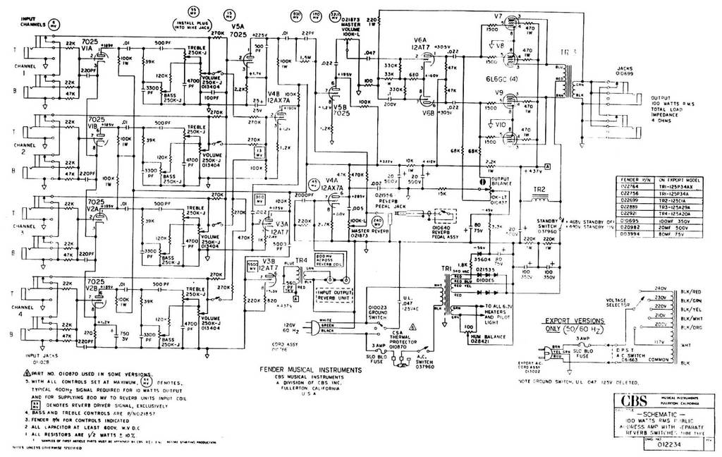

Ultraspark did read the bias voltage with respect to ground correctly. I have him reading plate current on pin 3 (plate) via voltage drop across the DC resistance of output transformer primary, which he is doing correctly.
Ultraspark,
Good job! The problem followed the tubes which I suspected, try and decrease bias voltage (make it more positive with respect to ground) for the old tube pair. So measure on pin #5 with respect to ground while adjusting the bias balance pot, this can be done with the amp in standby.
This was your readings:
reading pins #5:
V7: -49.9 V
V8: -49.9 V
V9: -49.4 V
V10: -49.4 V
Try and get them to look something like:
reading pins #5:
V7: -42 V
V8: -42 V
V9: -52 V
V10: -52 V
You might have to increase that 1k resistor to something like 2.2k and rebalance but this might be not worth it because you plan on using new tubes. Just try and use the bias balance for now.
If decreasing bias voltage to the old tubes doesn't help then they might be toast.

OK, I can't make bias for the old tubes meet any "solid" reading - it's consistant in the 0.00x area, and for the new tubes bias can only be adjusted between 0.8-2,3V.
Targeting:
V7: -42 V
V8: -42 V
V9: -52 V
V10: -52 V
for pins #5 (and ground):
If I make V9,10 meet -52V, then V7,8 is -44V or :
for V7,8 at (circa) -42.0 V, V9,10 is circa -53.1 V - not sure if this is OK?
Reading bias for this last setting:
V7: +- 2 mV.
V8: +- 2 mV.
V9: 0.83 V
V10: 0.84 V
All tubes look normal (to me), with a faint orange glow, and are warm.
Swapping V7 with last of the old tubes made no difference in bias (both pairs), which I read as all 3 old tubes are in identical condition, that be toast or not...?
Thought I had some 2.2 KOhms, but they were just 2.2 Ohms, so I'll try and get a 2.2 KOhm tomorrow.
I'm thinking it's better to continue when we have a full set of new tubes again? Or is there still a fair chance we can get a good result ...?

This is the voltage drop across the 35R primary DC resistance.
The increase in bias voltage to -52 lowers the tubes current draw.
.83/35=23mA which is for two tubes. I was trying to have him give less bias to the old tubes to see if they would conduct but they are not. .002/35=57*10^-6 or .000057mA for two tubes.

That's too bad. It was a shame to have broken a new tube but we learn from these things and knowledge is priceless. I would still just use two tubes in the output......if you have them why not, you only lose a few decibels of power and actually a lot of guitar people prefer it, I have friends that run their 100 watt Marshalls and Twin Reverbs with just two output tubes.
What killed the new tube was probably a bad connection at the socket (pin 5) and the tube without bias went into thermal runaway...this is a common problem. The retension you guys did seemed to have fixed it or else you would have had a high bias readings in the last few posts. I am actually quite positive the amp is fine except for the need of a new tube, but as I suggest if you are using it for guitar try it out with just two power tubes.

In my case with this Fender the cathode would be pin# 8 and the anode pin# 3, I believe. This amp has a jumper from pin #8 soldered to ground, so the 1 Ohm resistor would replace this jumper in your setup?
