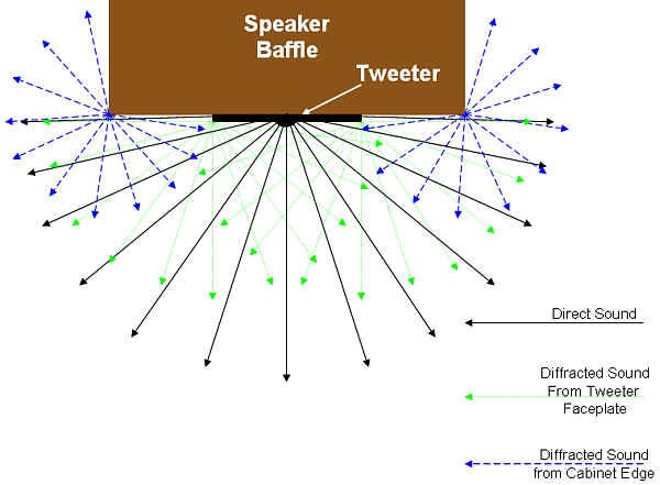

I can only speak in general, but I believe all the following are valid.
1. Any hard edge that is greater than a fraction of a given wavelength (usually 1/4 wave) at a given frequency, that is in the direct radiation path, is likely to cause diffraction.
2. Most felt treatments -- probably -- are insufficient to adequately address the issue of diffraction at all, or at the most important, frequencies. Consider that the human ear is most sensitive at the range (approx) 300 Hz to 3 KHz. At lower frequencies, those longer wavelengths are into the 6"-12" range. This, in part, explains the extreme rounding that some cabinet makers use for their speakers. Sorry to break the news to you fellas, but even a 1/4" ring of top quality felt made from the hair of unicorns won't do very much for you. On the other hand, such tweaks are rarely all or nothing; it's more likely that some incremental improvement might result, but it might be far from the optimum.
Corollary: adding felt on the surface of a flat cabinet, or on edges not in the direct radiation path, are probably of limited value. Even if they were, the wavelengths involved dictate that the felt would need to be rather deep (inches), not a fraction of an inch, to have much effect.
For further reading: although the application is quite different, consider some of the issues and proposed solutions with horns/waveguides: the "towel mod" and the Geddes foam plug. There may be some overlap in potential application with direct radiators.
Note the even flush mounting your drivers won't save you; you still have a sharp edge (transition from "horn" to open air.)
Although it will definitely work against neat cabinet appearance, I hazard that smaller versions of the "towel mod" may have a beneficial effect: a "fuzzy" ring around a midrange or tweeter would be a prime candidate for experimentation. Note that it "should" partially extend into the open space and thus the direct sound path. Even though a typical direct radiator is not normally thought of as a horn, most of them are in fact cone shaped and thus will have some undesired resonances. One of the arguments for the towel
mod is that it provides a smoother transition than the usual hard termination at the horn mouth. Strictly speaking the towel mod alleviates the cavity resonance issue of a horn. I see no reason why this wouldn't work on a smaller cone speaker.
I suspect this may be one of those trade-offs: You can have a nice rectangular box with an attractive grill on the front, or you can have something that looks like a mouse nest glued onto the front baffle, but you probably can't have both 🙂

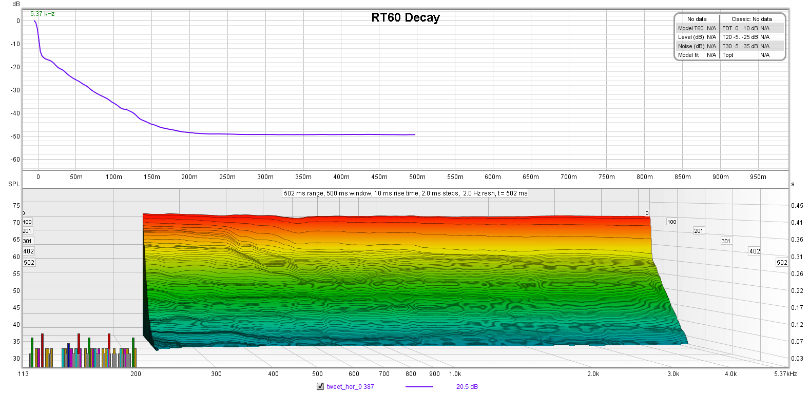

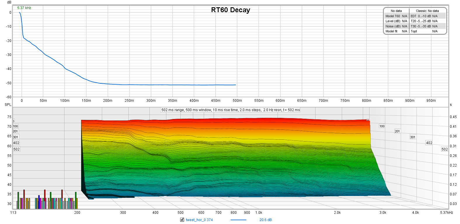

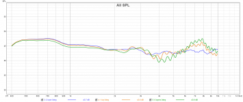

Felt will show up in the decay more than the power:

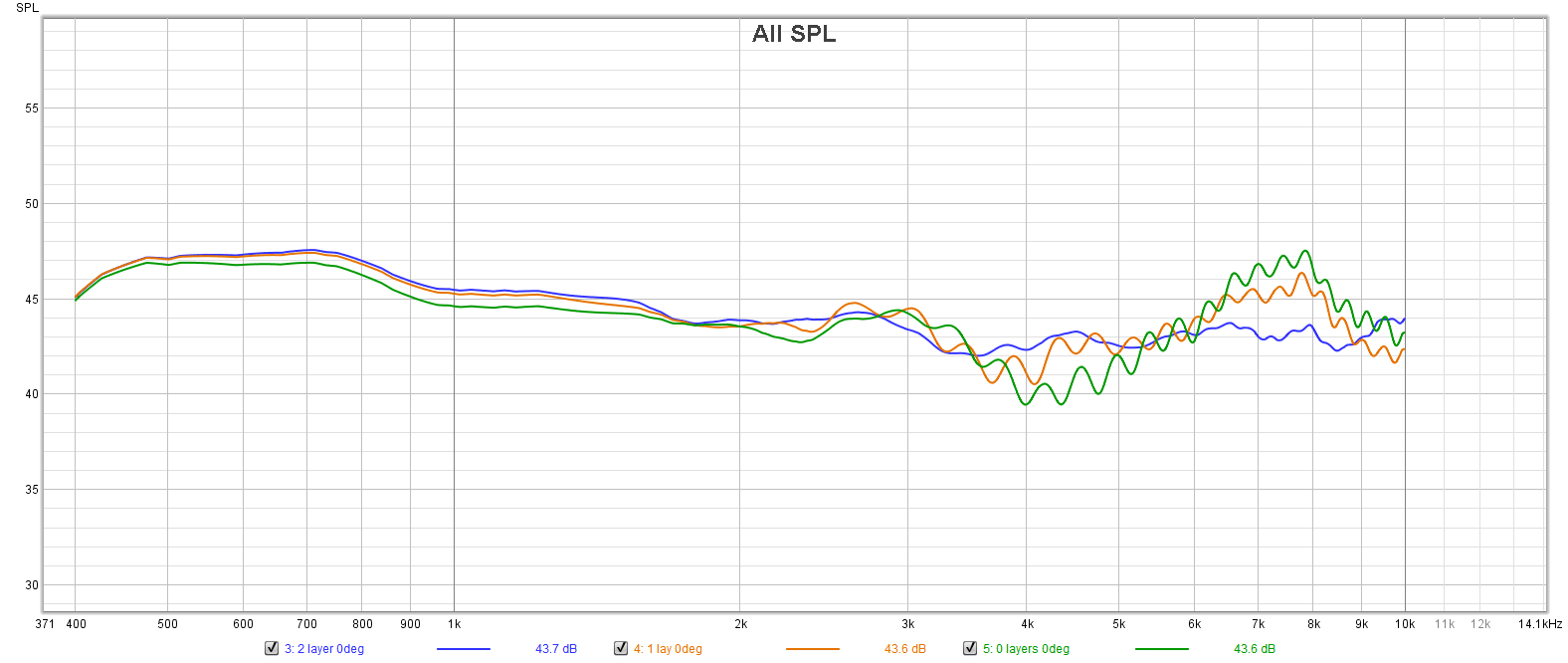

Here is a baffle with many layers and EQd to 3 layers. As I remove each layer you can see how the shape is changing the response.

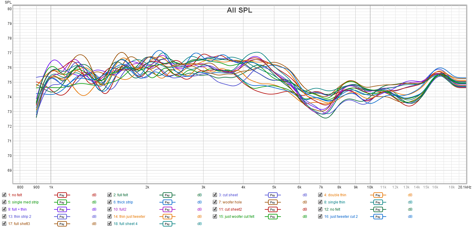

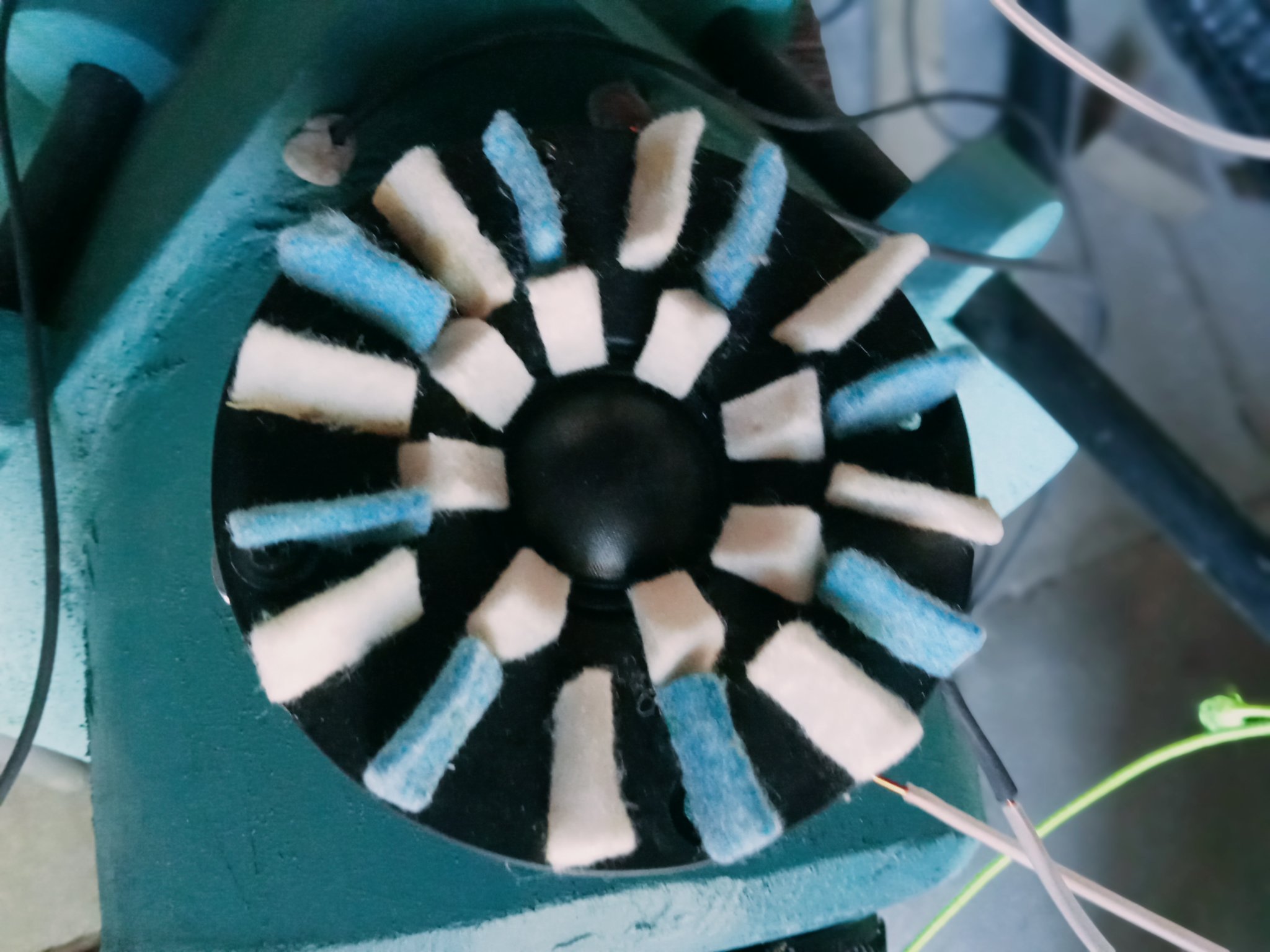

Next is the same baffle with many diff. felt shapes on it and layers.

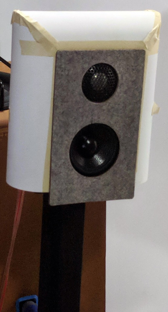

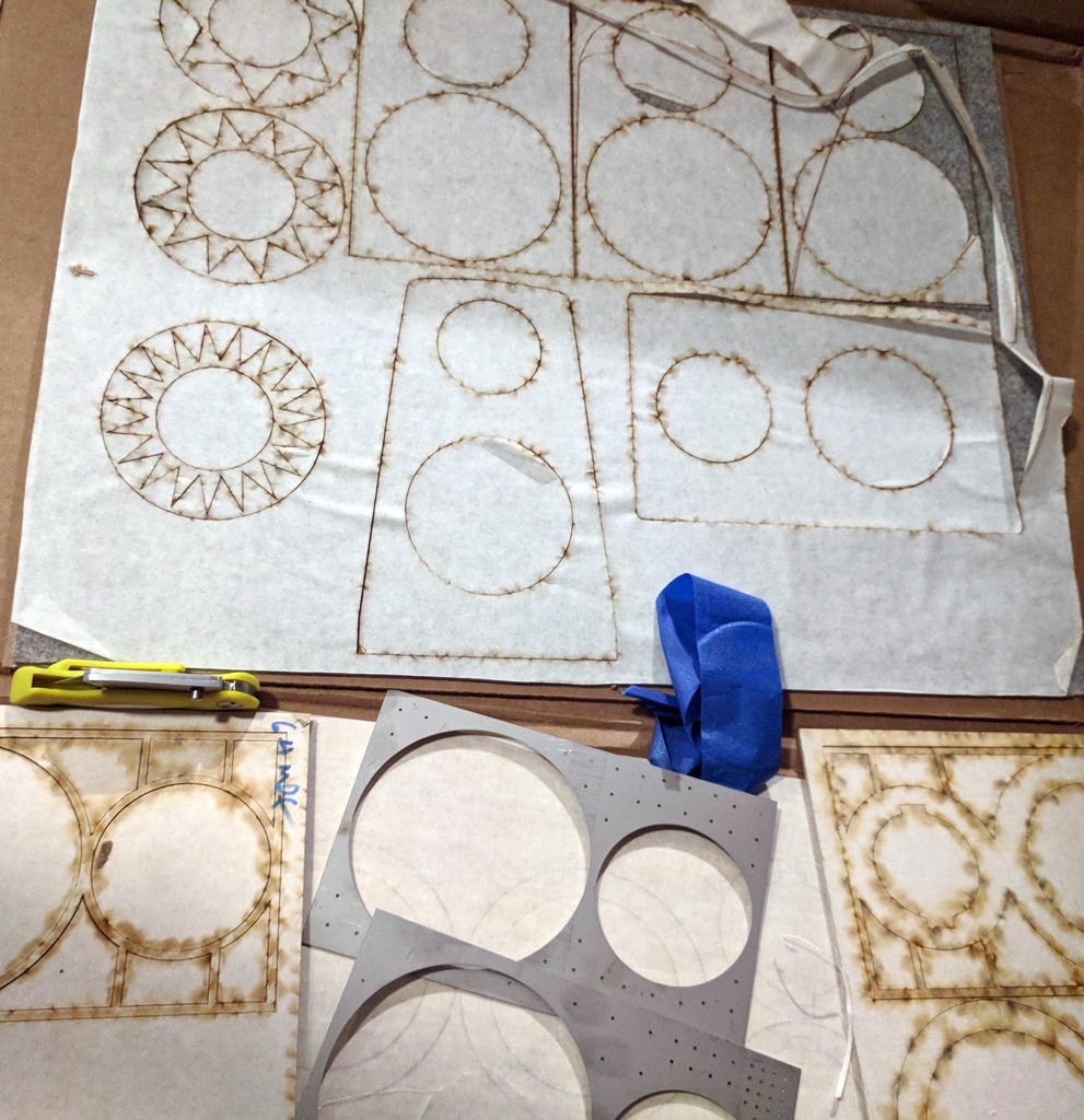

I got felt from ponoko. It is all acoustic grade and you just need to send an AI or SVG file to make a laser-cut part.
The image shows some random experiments plus the base felt layers and the layers that go past the tweeter.
