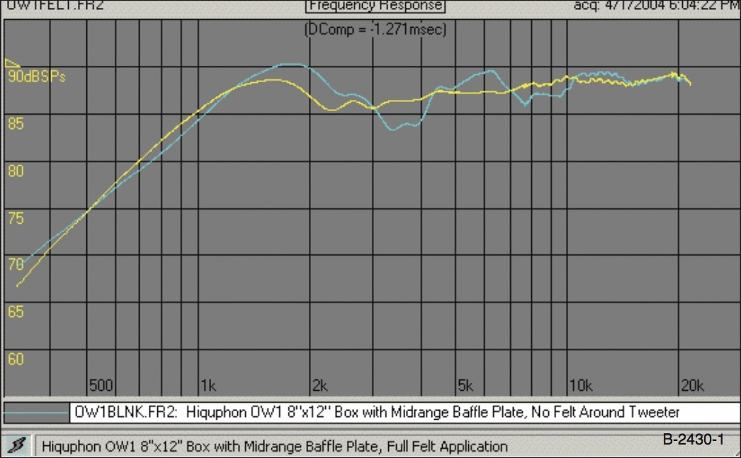

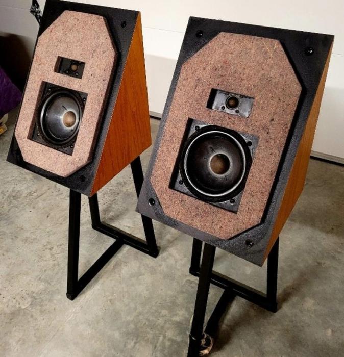

Felt to help with baffle diffraction
Yeah, waveguides and roundovers 😉
Exactly! The deeper I go into this it seems that waveguides are really one of the only ways to go if you really wanted to control it. The whole "if you can't beat em' join em' " strategy. At least this way you get to control the narrative. But I still am looking for some very indepth information on this. I just came across the
Huygens Principle which is likely the origin of science on diffraction, though it was for light it is likely used for audio as well. Interesting to find this. Compression drivers likely use something like this to tune their drivers.
Yeah sound is wave like light. Impedance changes, part of wave transmit and part reflects back. Simplified, rounding of corners ease out the impedance change and more transmits, less reflects. Cant get rid of diffraction (wave going aroubd corner) but the reflection, aka back wave, is the problem and gets reduced in amplitude and bandwidth.
Also felt makes impedance change, part of sound transmits to it and part reflects.

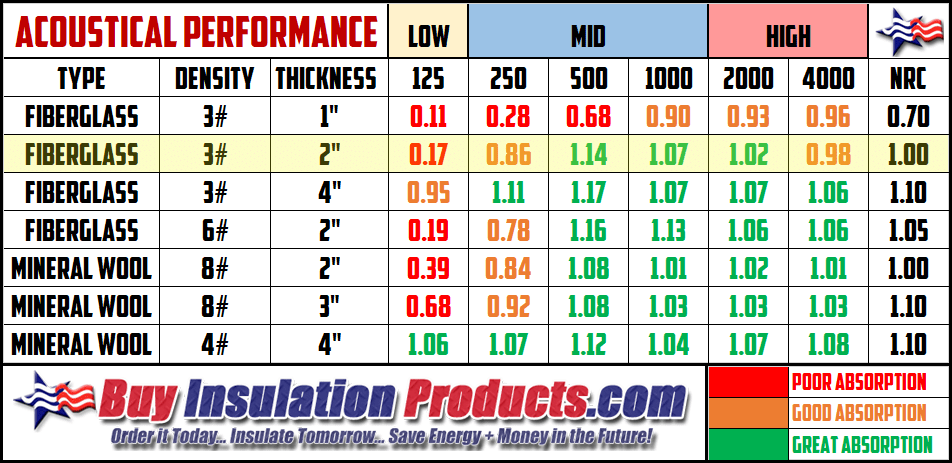

I'm building a HT / family room where in-wall speakers will be installed in infinite baffles fabricated out of "Tecktum" or similar rigid sound attenuation board, speaker fabric wrapped (& felt where appropriate). I'm thinking this eliminates edge diffraction while the also diminishing pitfalls of infinite baffle speakers by fabricating virtually all walls and ceiling surfaces out of material w/ sound reduction coefficient of .75 - .80 and most importantly contributing to WAF.
Do any contributors have direct experience with any of the above (other than WAF issues)?
Add some diffraction panels too?
Inquiring mind wants to know!

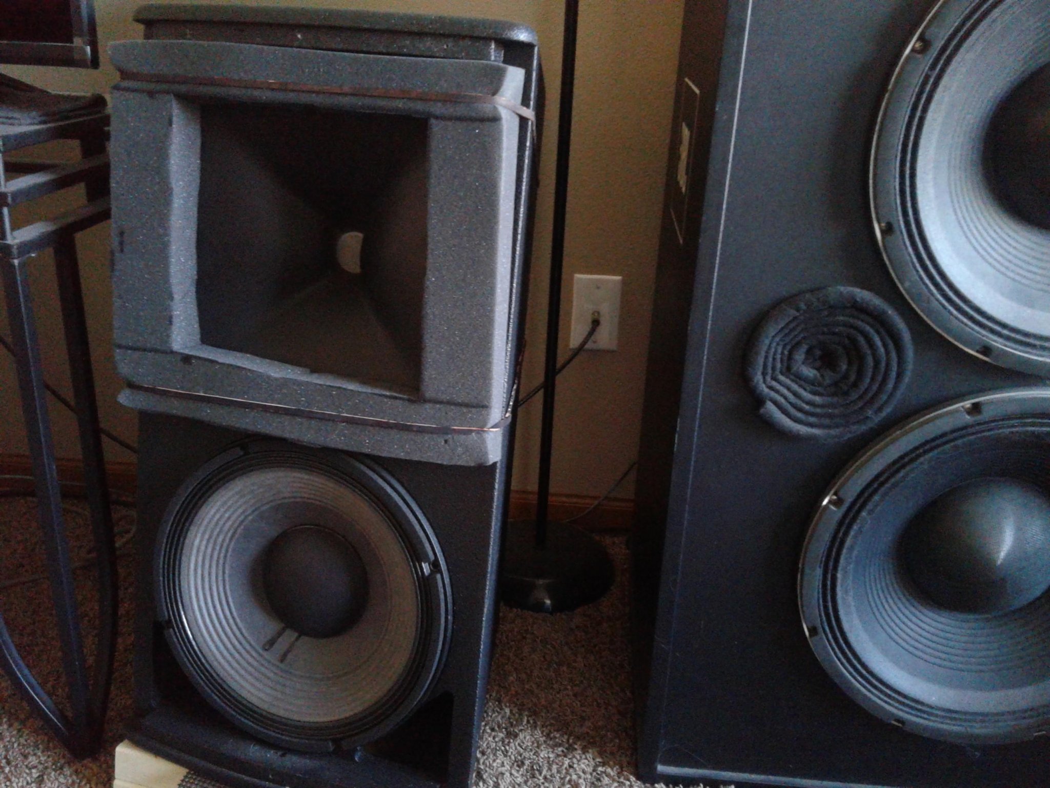

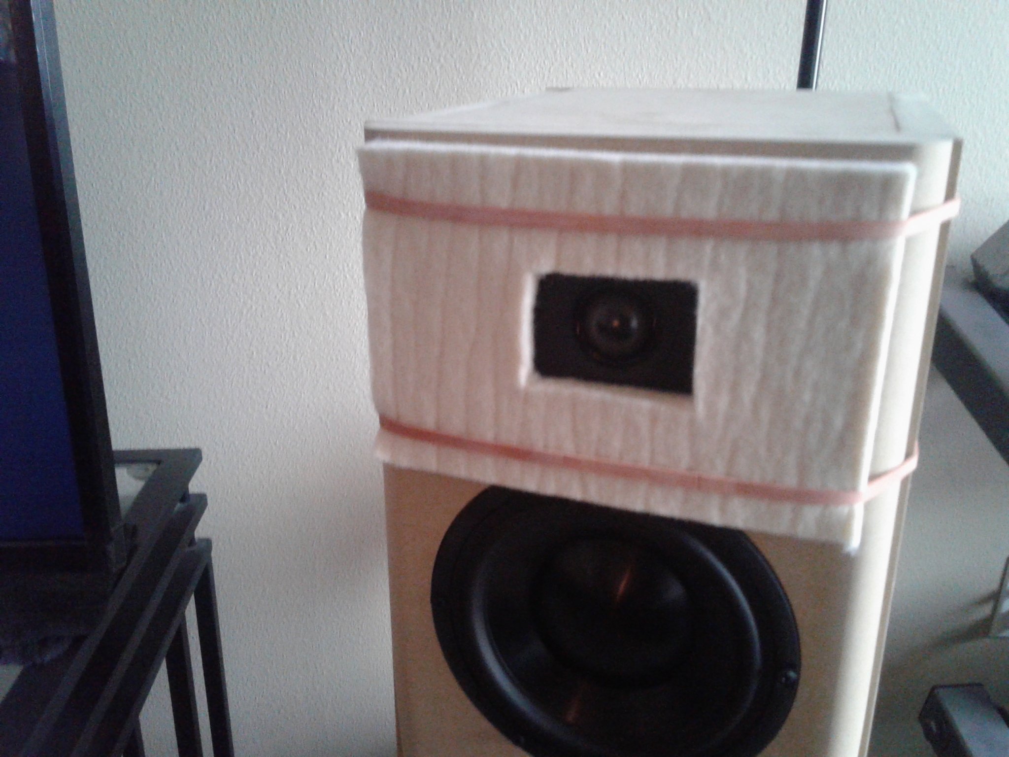

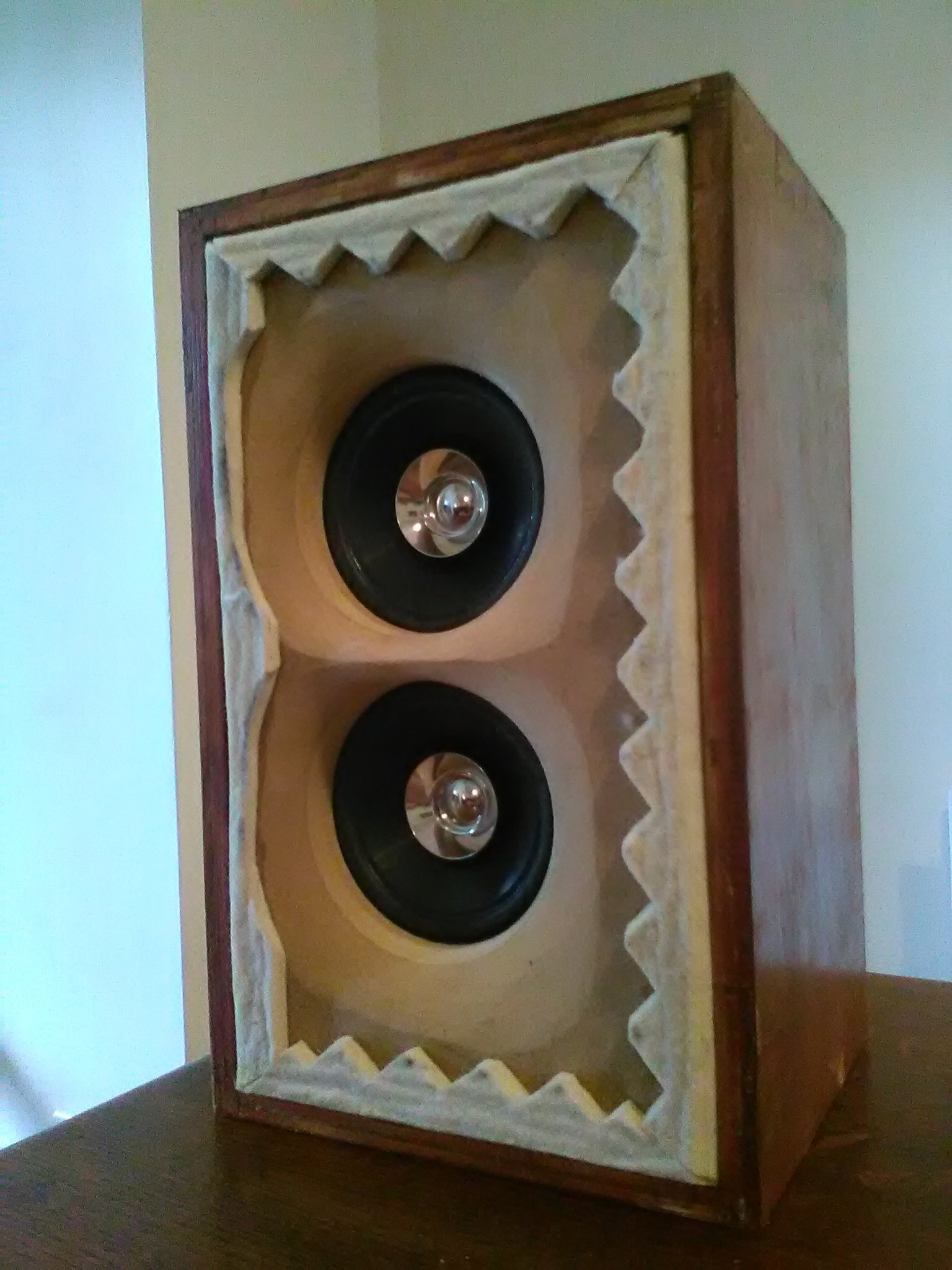

I was looking at how Wilson Audio adds felt to the baffles of there speakers and it got me thinking about my Martin Logan's that have these "wings" on either side of the panels. Would there be any benefit to adding felt/absorbent material to these areas?
I figured this would be the place to ask instead of wasting space creating a new thread.
hmmm.............
a parallel surface sticking out on the back, you can measure a something there.
Is it audible sitting 10' away ?
No clue.
But, to me, it can't hurt.
Maybe try rolled up towel.
90% wool or f10 felt, think I paid $30 for a 1/2" thick,
Or even a foam "box" completely around the back side if the speaker is less than 5' from the front wall.
Your ears, your preferences as to what you think is good !!!!!!!!!!
