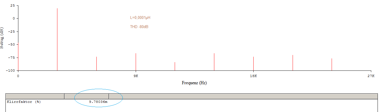

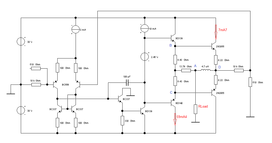

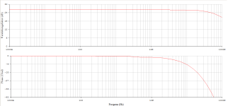

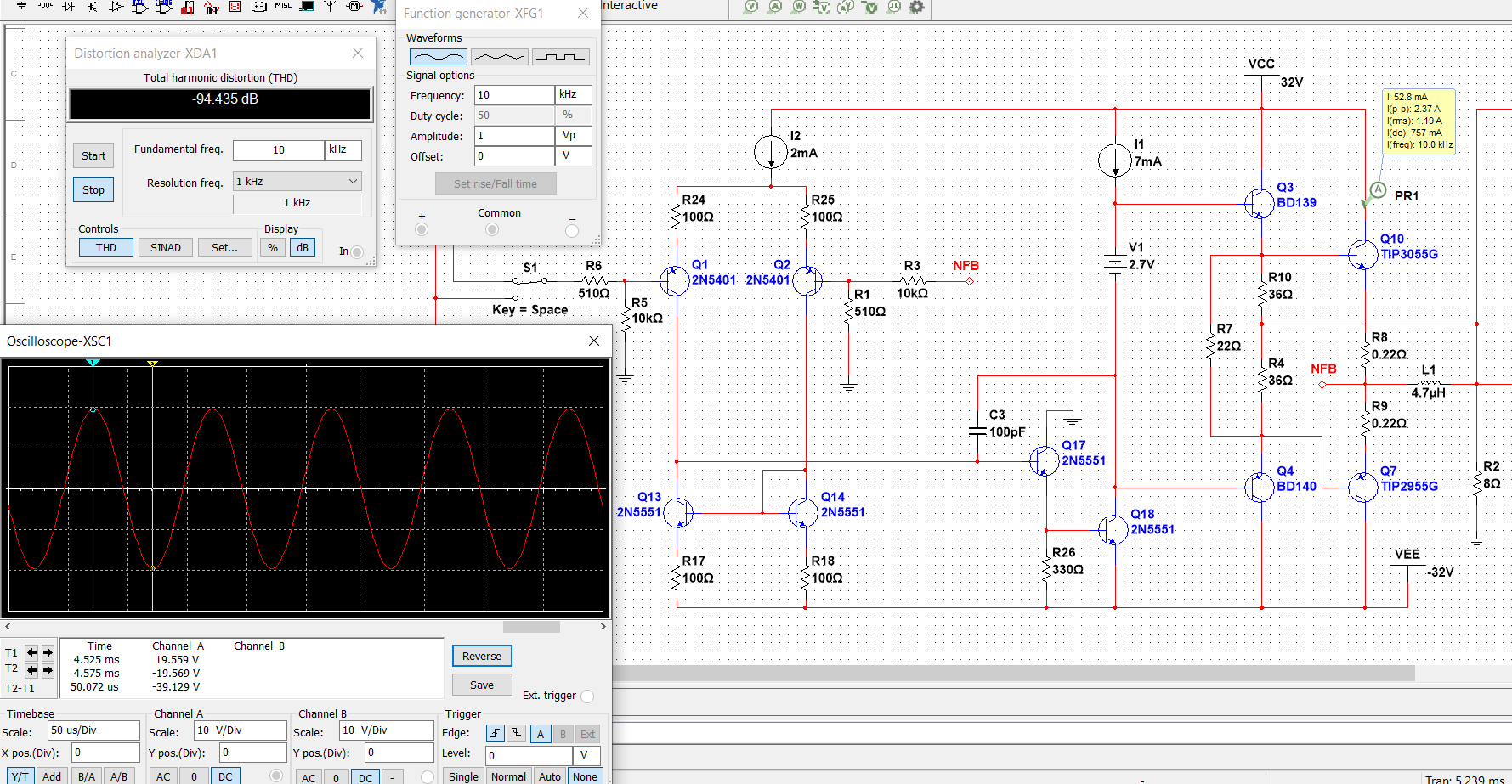

For further simulations, I have stored this schematic as a model.
I had mistakenly transformed your triangle 22 - 36 - 36 with 39 ohms instead of 36 ohms, but this will certainly not be so decisive. Rather, the pair 2N3055 & 2N2955 will now also cause a little noticeable transfer x-over distortion in the spectrum.
I am curious.
There is the MC12 64-Bit wonder ...
I still prefer LTspice VII 64 bits too, simpler to use and more intuitive.
How did you find the corresponding resistance values for your triangle?
You still owe the reader this answer 😉.
I mentioned in the OP.

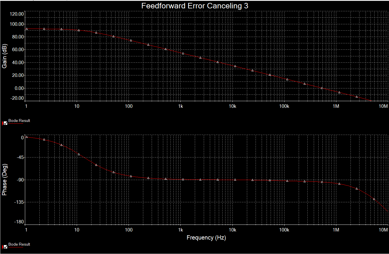

When the corner frequency of the "Forwarding Resistor" and the "Inductor" equals to the "Unit Loop-Gain Bandwidth" (or the close loop -3dB bandwidth, they are same), the circuit is balanced.

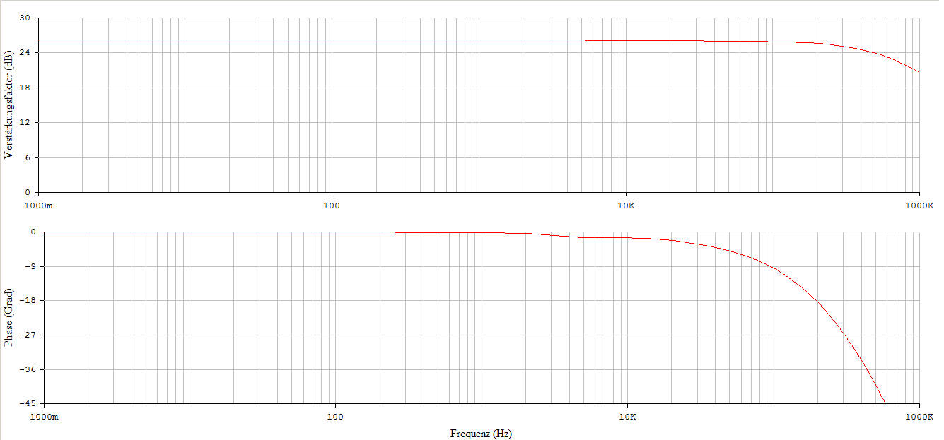

Here is "Loop-Gain" bode plot of the circuit in #6. "Loop-Gain" means it includes the voltage divider from the feedback network.
You see it cross over 0dB at 600KHz.
You know the inductor is 4.7 Ohm. It is not hard to calculate that the resistor should be 18 Ohm. In the post #6, there are 2 resistor in parallel. Thus, they are 36 Ohm each.
You can also hand calculate the "Unit Loop-Gain Bandwidth" without simulation, if you can.

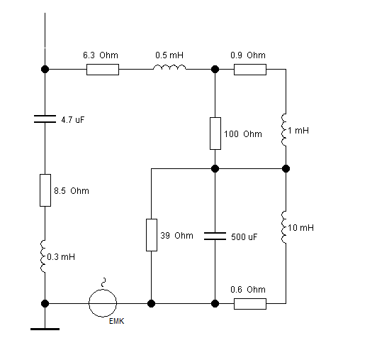

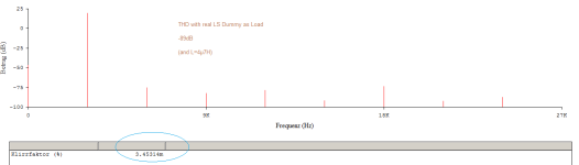

What about into a more realistic speaker load, instead of an 8R resistor?
If the complex load is still made of ideal resistors, caps, and inductors, it is still a linear load. As long as the load is linear, it should not affect THD much.
The real concern regarding the large inductor at the output is the non-linear load. The extreme example is a 8 Ohm resistor series with 2 diodes in reverse parallel. That will throw off THD if they are driven through an inductor.
The question is how much non-linearity the speakers usually are. I don’t have the answer. For now, I won’t let the inductor go above 5 uH.

There is no such thing as the QUAD405 pseudo bridge here, there is an EF2 and that's it .. (no balanced)!
Perhaps you didn't understand my question?
The starting point is the famous IP - VA - OP - Stage topology; and now you suddenly think, "I like to put a tiny inductance in series with my load".
Now I kindly ask you again: how do you split the resistance between the bases of the last stage - how do you arrive at your triangle?
By the way, you don't have to answer this question for me, but perhaps for one of the other readers. Let's assume that this R is greater than 100 ohms but less than 330 ohms. That would be the standard.

This gives you omega and then you can equate R4 (or RA + RB||RC) with jOmega * L. Unfortunately, this still does not solve the "so-called bias problem". Namely VBaseBase' or V(BC) if you prefer.
The correct solution is not so obvious, as McLoughlin pointed out back in the 1970s.

I have some superficial questions~
1. If I can't simulate an existing amplifier, how do I measure the bandwidth? Input a small signal to the amplifier, measure the output, and observe at what frequency the gain of the amplifier decreases to 0?
2. If a 0.1uf capacitor is connected in parallel on resistor R7, will it affect the normal operation of error correction?
3. How to place 0.1R+0.1uF? Place it to the left or right of L1 (4.7uH)?
Thank you so much:cheers:
You have to know the schematics of the amp to do the mod. Knowing the schematics, you can calculate the loop-gain bandwidth without simulation. I don't recommend to sweep frequency response without knowing the schematics. There might be input filter which can easily give you false reading.
Just a resistor. Cap will make it worse.
If you really want to know how it works, you might be interested in this paper. It is the same principle.
https://www.diyaudio.com/community/attachments/current-dumping-analysis-pdf.1386102/
How to calculate the feedforward resistor value.
I would say, just remove 0.1R+0.1uF. If you really want to keep them, put them at the speaker side of the inductor.
