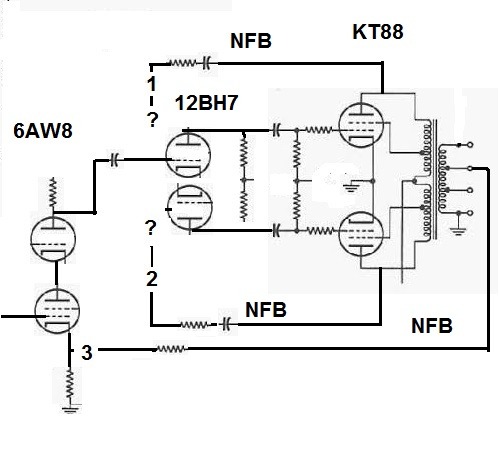

In the picture, three lines are used for feedback by Ken Shind. Number one and two are feedback from output tubes and number 3 from output transformer .local and global .Does anyone have an opinion?

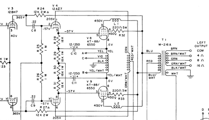

Post # 6 schematic:
Output Stage Feedback circuits:
Local feedback of the output stage:
Positive feedback from plate 1 to screen 2 (not Ultra Linear)
Positive feedback from plate 2 to screen 1 (not Ultra Linear)
Negative feedback from output transformer plate 1 to cathode 1
Negative feedback from output transformer plate 2 to cathode 2
Local and global negative feedback paths from output stage to:
Positive feedback from output transformer tertiary winding 1 to 12AZ7 1 (Bootstrap)
Positive feedback from output transformer tertiary winding 2 to 12AZ7 2 (Bootstrap)
Negative feedback from plate 1 to: plate 2 of 12BH7 (AC and DC), and grid 2 of 12AZ7 (AC)
Negative feedback from plate 2 to: plate 1 of 12BH7 (AC and DC), and grid 1 of 12AZ7 (AC)
Positive feedback (AC) from output cathode 1 to 12AZ7 cathode 1
Positive feedback (AC) from output cathode 2 to 12AZ7 cathode 2
I hope I got them all, and I hope I got the Positive and the Negative senses of the feedback correct.
If you like Positive feedback, and Negative feedback, this amplifier has it!
(10 feedback loops, or 12 feedback loops depending on how you look at it)
Post your corrections, please?

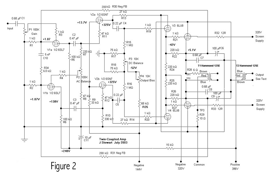

I used UL as well as the Unity Coupling of the McIntosh in my build of Crowhurst's Twin Coupled Amp.
Crowhurst covers a number of final stage topologies in one of his papers.

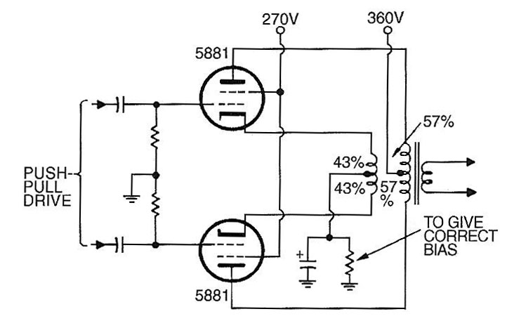

OK Walter, it isn't obvious on a detailed schematic, So here it is simplified, alto for 43% UL.
43% was simply a magic number put to use by Hafler & Keroes of Dynaco after they did a bit of research.
It was still reasonably easy to drive but the resulting Damping Factor before full loop NFB was good.
Quite a few people built 20% UL back in the day. UL could be anything, just find a OPT winder that would do it for you.
The winders will tell you every time the machine is stopped to bring out a tap or start another winding the price climbs.
Somewhere in Glass Audio / AudioXpress there is an article covering an amp with 57% UL, the builder has connected
the OPT primary windings opposite to what is normal, He used Menno's OPTs.
For several years Menno's high performance magnetic were built
here in the Toronto area. At 601 Magnetic Drive...................imagine that.
Stuffed into Crowhurst's version of his Twin Coupled Amplifier the UL is 50%.

The McIntosh, the N. Crowhurst and the Circlotron are all the same framework, with different degrees of difficulty. The McIntosh requires a minimum of two bifilar primary windings, each with both polarities (for the usual push-pull versions, and Mc's were almost Class B, so push-pull only). The N. Crowhurst cheats a little, coupling the ends of two separate transformers' primaries, to get nearly as good coupling at the low impedances resulting from the framework. The Circlotron really cheats by making both windings the same piece of wire, but requires floating B+ supplies. All are gain-of-two output stages and need heroic driving voltages, commercially meaning bootstrapping the driver.
We probably shouldn't say that there's feedback to the screens - it'd be better to say that the screens are kept at the same signal voltage as the cathodes, making it full pentode operation. In the McIntosh and the N. Crowhurst, if the screens are instead connected to B+ (or some lesser zero-signal voltage) they operate at 50% partial triode ("UltraLinear").

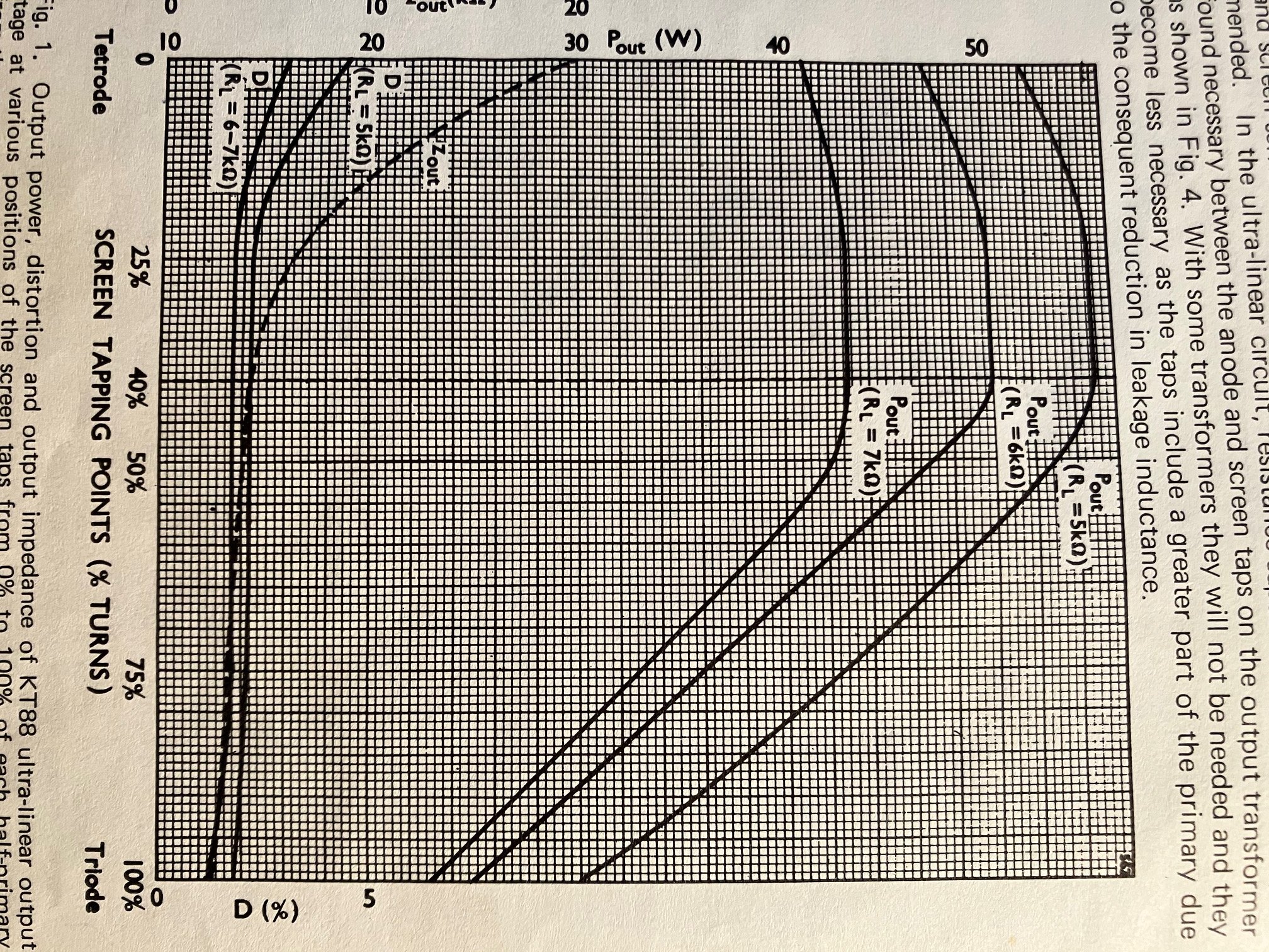

Reading Radiotron ( as reference) the UL is treated separately and in the paragraph of Mac nothing is written about UL operation.
So are different things
In attach a front page of MOV valve Application Report no.3 ( it is an original book)
Then the diagram where is possible to see that the 43% is not casual . In fact the Zout and distortion stay constant even you increase the % (from 40) of UL feedback, while the power goes down in the same shape with different Rl.
It is for KT88 tube but can be taken as general rules
And I take this informations as reference around the UL circuit.
Walter
