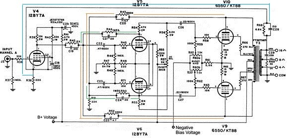

original circuit of AP-80 Mono Block 6550
Same internal negative FB hookup as seen in several of the later RCA Receiving Tube Hand Books.
For example in RC30, refer to schematic 29-11. This on also has a small amount of Schade FB included.
Who knows why the extra, just another unnecessary frill. 😀
It's very tempting to include DC blocking capacitors in these two-stage feedbacks, but it probably shouldn't be done automatically. The extra zero complicates things for low frequency stability, so needs to be somewhere far below the dominant pole. Even more challenging, the dominant pole needs to be somewhere else than at the clipping point, the output valves' grids (where it would ideally be for best overload recovery time) because clipping changes the open-loop response in a less stable direction.
All good fortune,
Chris

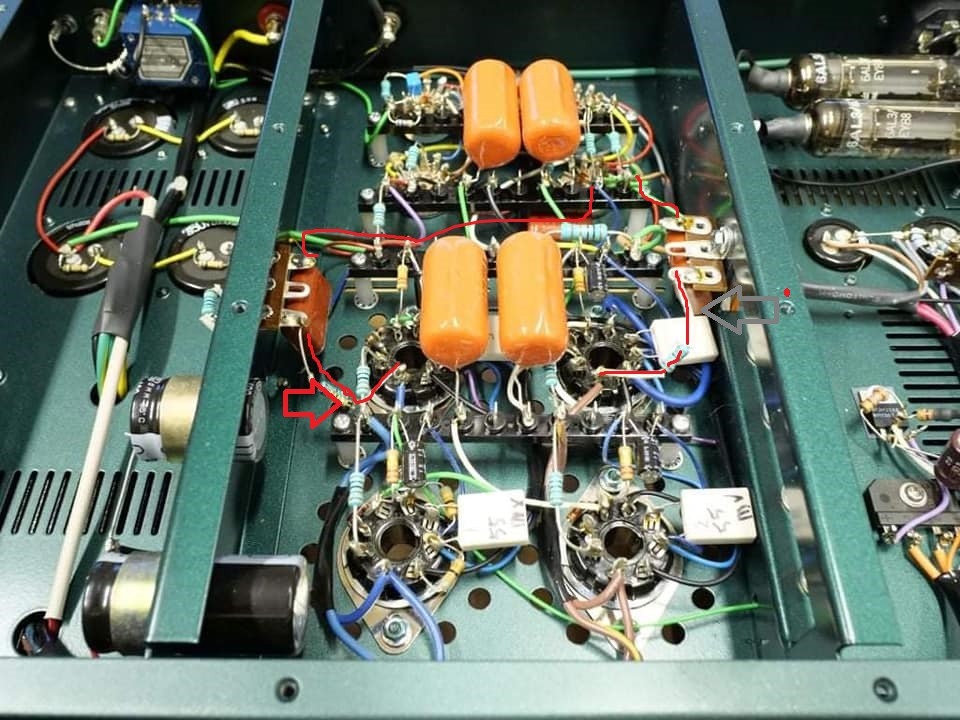

The point is .... simple. But there is a big difference between a professional amplifier and the things that everyone makes. Unfortunately, there are no schematic from Shindo amps. The difference is not only in output transformer and capacitors... it is in the type of feedbacks. When There are two local feedbacks on 12bh7 as a phase splitter... do you know how its circuit is? I am looking for someone who knows.

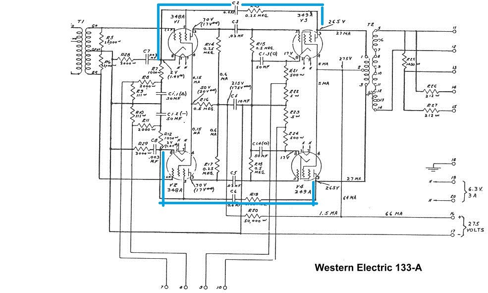

It's easiest to visualize the way 50/50 anode/cathode loading can be 50% partial triode with G2 at signal ground by making two drawings.
Would that be similar to a split-load/cathodyne/concertina phase inverter circuit with a gain of 2? That's how I visualize it whenever plate and cathode have same resistance value and, in this case, same inductance value. Due to the low gain in the power stage, is that why most Mac amps have high driving voltage?
