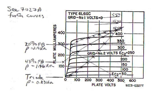

I was suspicious of that finding from the get go. For starters the output toobz used were 6L6s.
Any other tube such as an EL84 has a different mu g1 g2
I built me a graph of several UL percentages as well. The plate curves as a function of G2 voltage at G1 zero is a very
useful piece of information. When loading pentodes G2 curves are always worth a look.
Many people built PP partial triode at 20% as well as 43%. I also built SEP at 50%. Anything goes!

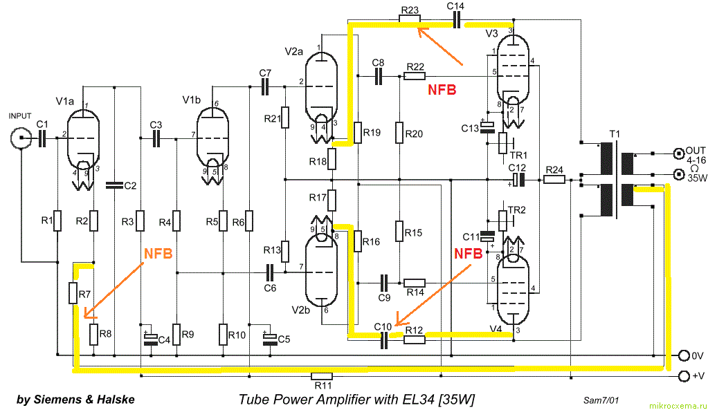

Post 26 : which Siemens model could this be ?
FB taken from the output tube plates was quite common in german pp studio amps.

SIEMENS EL34 AMP SV410 / 1 ....Post 26 : which Siemens model could this be ?
I think it is an internal positive feedback circuit thamed by an external negative feedback secondary-to-input to avoid oscillations.
If the positive feedback level is too large, then . . .

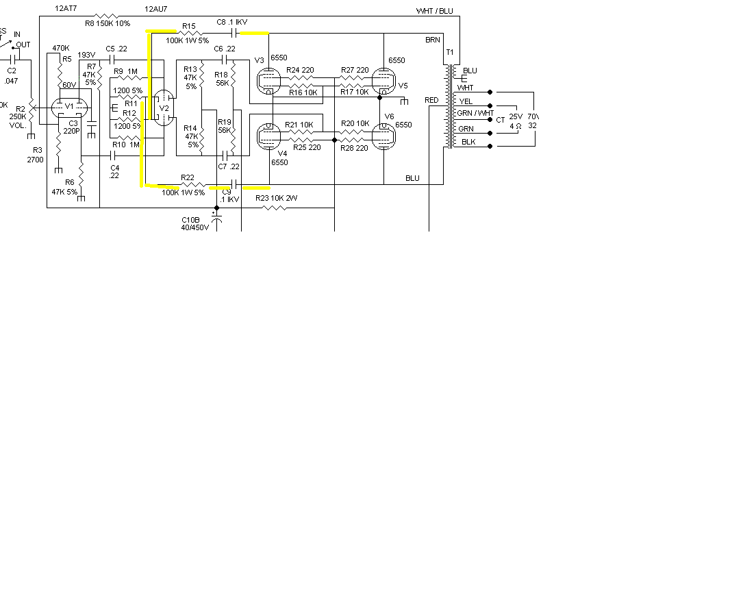

For the schematic in Post # 33:
Two sets of RC coupling between the stages, AKA ~ Williamson (those two RC couplings are inside of the global negative feedback loop, and the 3rd low frequency pole is the output transformer).
And positive feedback from the output tube plates, through a 0.1uF cap to 100k series resistor, to the low impedance driver cathodes. Estimated frequency where the relative positive feedback is about -3dB at 15.9 Hz, less positive feedback at lower frequencies.
The fixed bias parallel 6550 tube pairs have common 56k g1 return resistor to the bias, plus 10k grid stoppers.
I calculate that as effectively 56k x 2 + 10k = 122k Ohms per g1 grid.
6550 spec for fixed bias is 50k Maximum.
That circuit is asking for OUCH, broken, run-away current on most 6550 tubes.
And, there is no individual bias for each output tube pair (use extremely well matched pairs, or one is certain to run-away).
