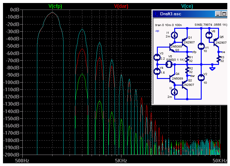

i might as well toss this in...
I think this is a more or less “apples-to-apples” comparison of ce, ef, and cfp performance – the devices and loads are due to my interest in headphone amplifiers; the levels are matched for similar load v and i with identical output Qs
The darlington trace should be essentially indistinguishable from the single ef (which I didn’t do) and I believe it can be seen that the distortion spectrum follows the oft criticized negative feedback distortion characteristic of reduced low frequency distortion with the higher order distortion components eventually exceeding the no feedback ce distortion – just think ef = dar in most of the discussion
The cfp case however shows that with enough feedback the distortion crossover can be pushed way below the noise floor – in this sim it is obscured by the resolution of spice calculations and while model inaccuracy certainly renders the absolute values of the lower distortion numbers irrelevant, the relative distortion with varying feedback around identical devices should serve to illustrate the point that just because a little feedback may be “bad” (the “evil” 5th, and 7th harmonics just = in ce vs dar and the 1st higher dar harmonic is @ –120 dB), it doesn’t mean a lot of feedback (in the cfp) can’t be very good
a quick shortcut for how much more feedback does the cfp have vs the ef:
how much more current flows into the load/Q3_emitter junction due to Q1?
ic_Q1 = h_fe * ib_Q1, ib_Q1 = ic_Q3; therefore the cfp has h_fe (of Q1) more gain than Q3 would have as a single Q ef
so why isn’t the distortion of the cfp -46 dB ( h_fe of Q1 is ~210 ) vs the darlington trace?
Because a major distortion source is the distortion of v_be (of Q3 in the cfp, largely Q2 in the darlington) and it is “outside” of the loop and is only indirectly reduced in the cfp by the gain of Q1 reducing the current swing in Q3

Re: i might as well toss this in...
Thanks for the comparative analysis, jcx!
My particular preference for the CFP over the Darlington is limited to its use as a single-ended follower with an N-channel JFET up front and a PNP bipolar for the output.
Have you done any comparative analysis of this combination versus the all-bipolar CFP?
I've been somewhat curious as to what it's basic behavior would be seeing as the two devices are complimentary in terms of their polarity and in their own local loop, yet one is a square law device while the other is exponential.
By the way, the issue of how much feedback was with respect to the CFP versus Darlington, not CFP versus a single device emitter follower.
