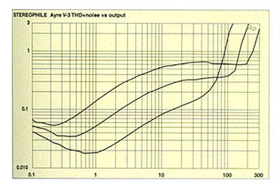

John,
but it was not about clipping. Distortion vs. power plot shows the 0.3% THD+N for power from 20W to some 110W (middle curve, 4 Ohm load). 0.3% THD means -50dB which corresponds to the spectrum shown.
Pavel
BTW - log scale is used in audio because of the nature of human ear perception.

john curl said:
By the way, PMA, have you seen MY power amplifier curves in 'Stereophile'? Check it out in FEB 2003, or you might look at my earlier design in JAN 2000. I don't have to apologize for ANYTHING!
Well, the results of Mark Levinson No.32 preamp (Stereophile January 2000) are that what I would expect from a very good preamp. Excellent job, John.
