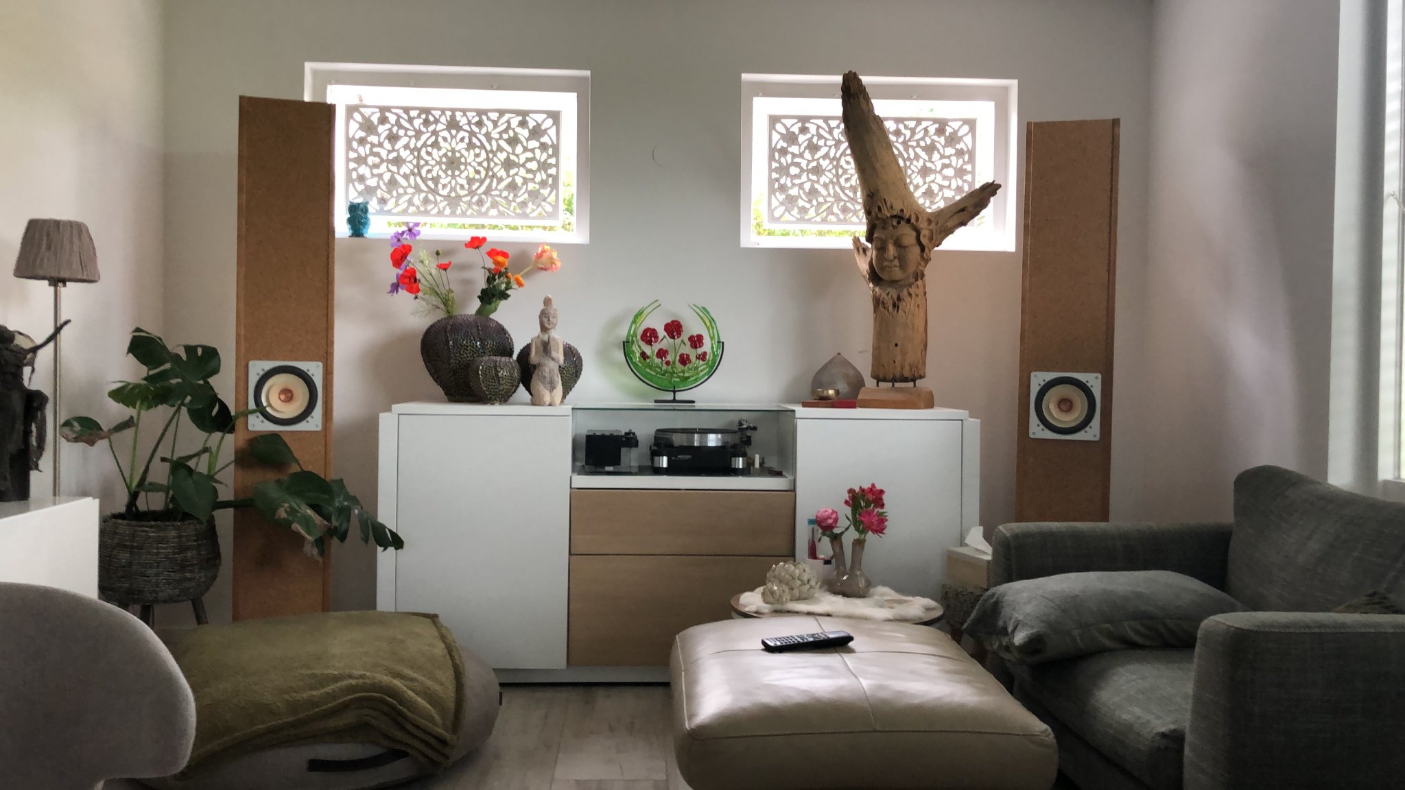

At the moment i'm using a vulcan with the Cube Neo speaker. I heve the impression that the front panel is adding output in the 150 - 300Hz region.
i have 2 questions
Would love to hear your thoughts
i have 2 questions
- Could this be solved by adding a thin panel with constraint layer damping?
- Is the Vulcan a good case or is there a better option?

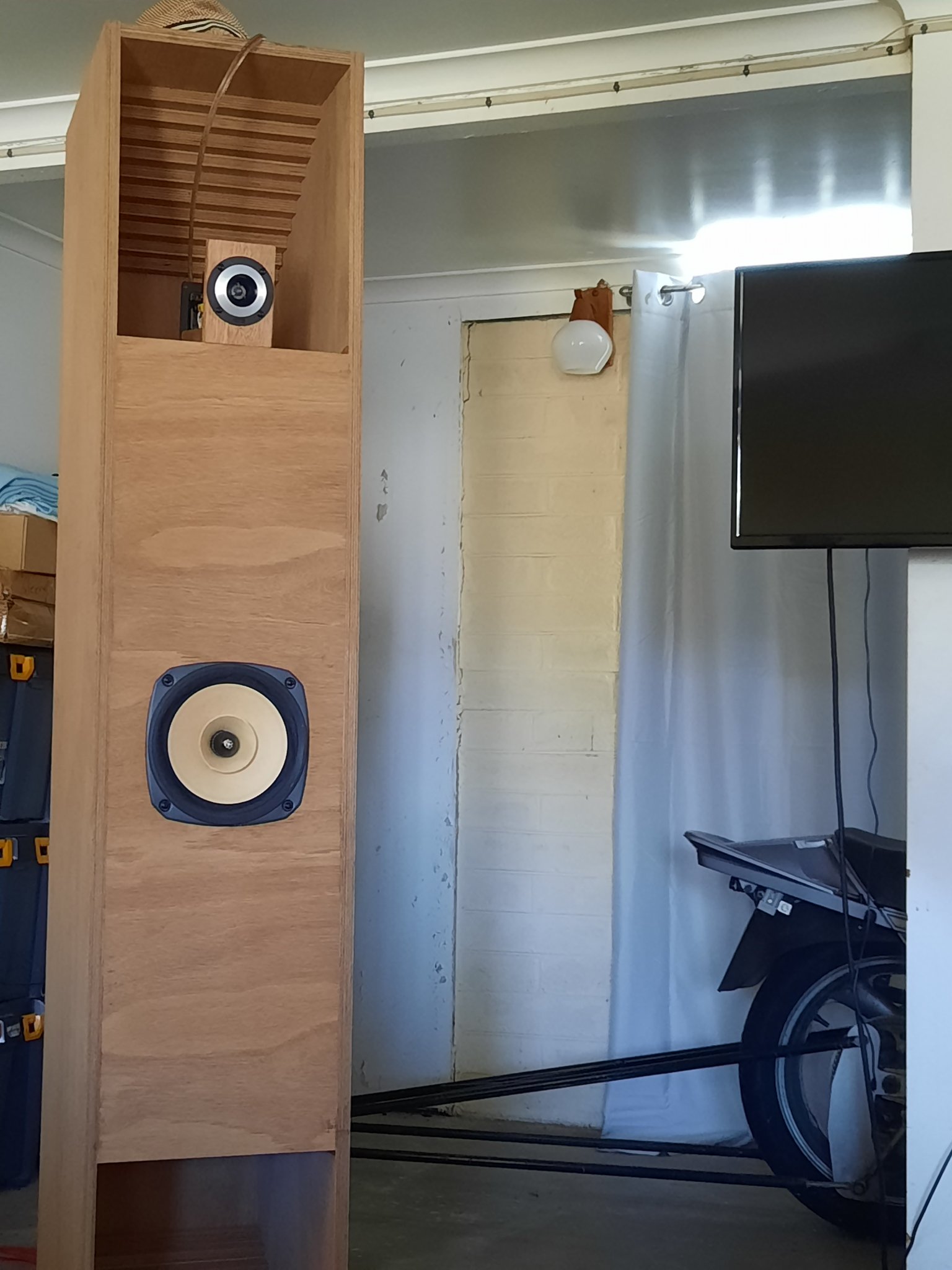

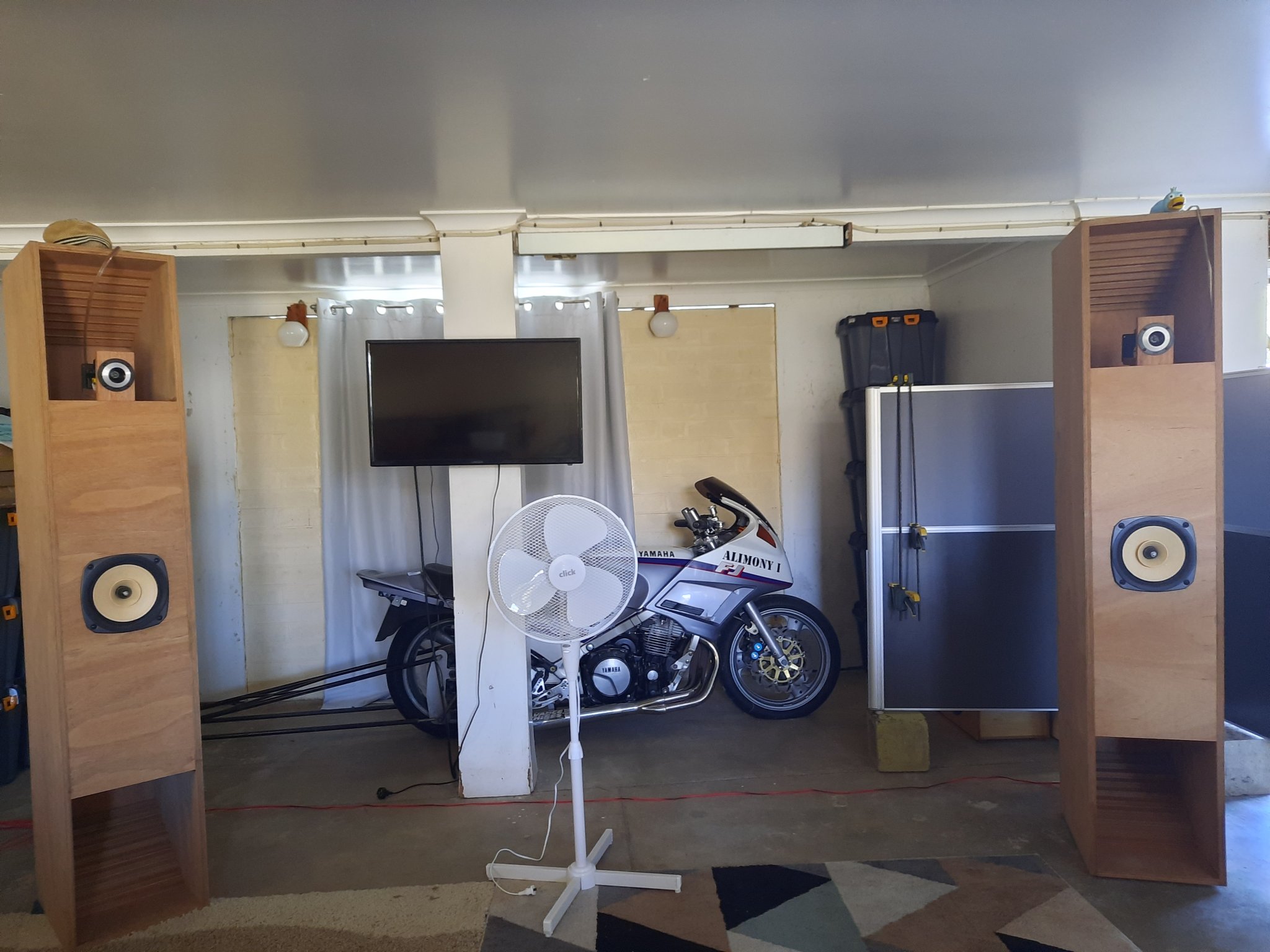

Hi all,
Been a while, and a couple of updates since my last post regarding fe206 in Kirishima.
Built some class A stereo (in mono mode) dual amp Camp Amps.
Was ok, but did not have the punch I thought they might deliver to the 206's
Slowly putting together components for my Nelson Pass M2 clone (25W into 8ohm)

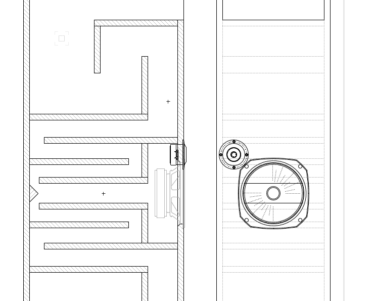

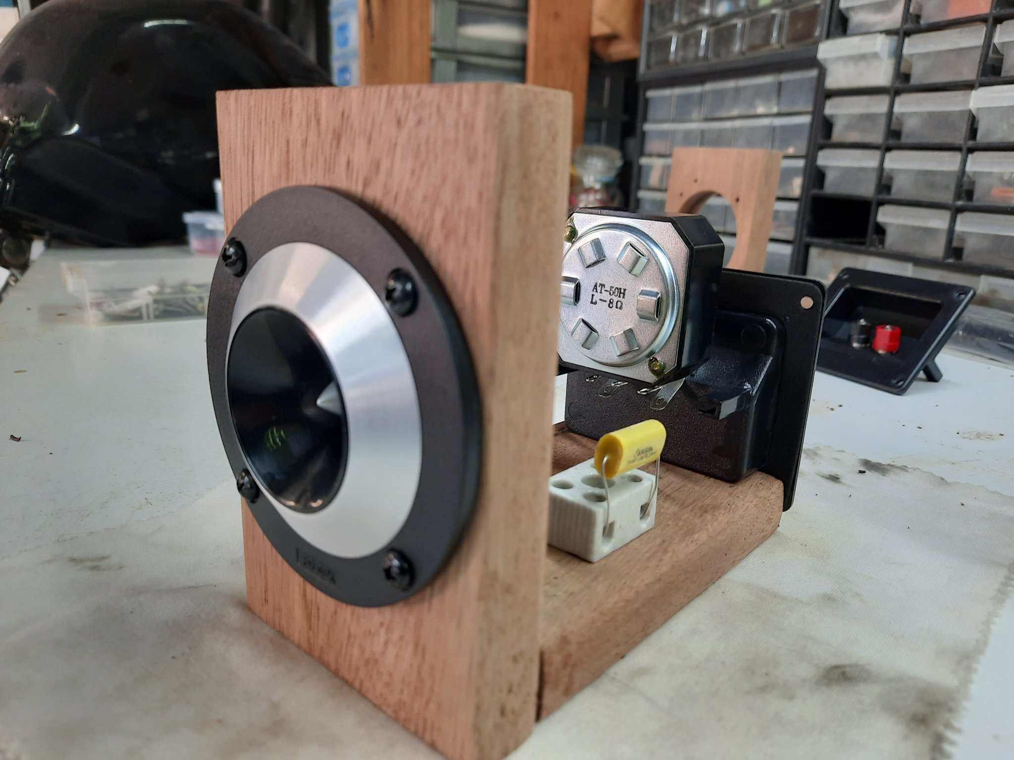

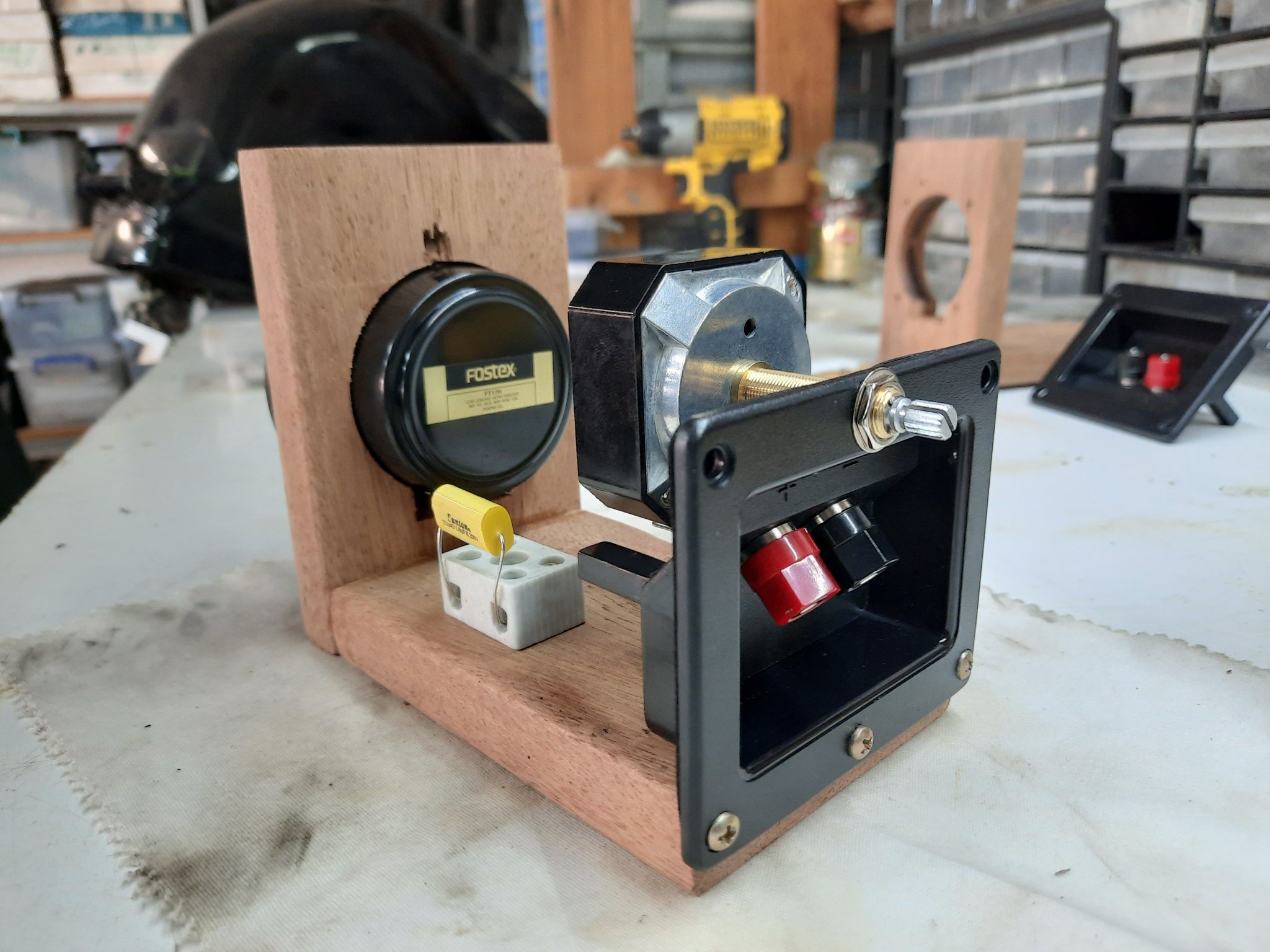

Also been looking at tweaks to the speakers, and one possibly upgrade is to integrate a super tweeter.
Check out the options and simplest and workable solution is the fostex ft17h supertweeters.
I picked up a pair of fostex ft17h from fleabay.
Dave did post an option around mounting the tweeter in the box, see image attached in post.
Just wondering if any one has done this yet, and what was the results?
Cheers, S.
