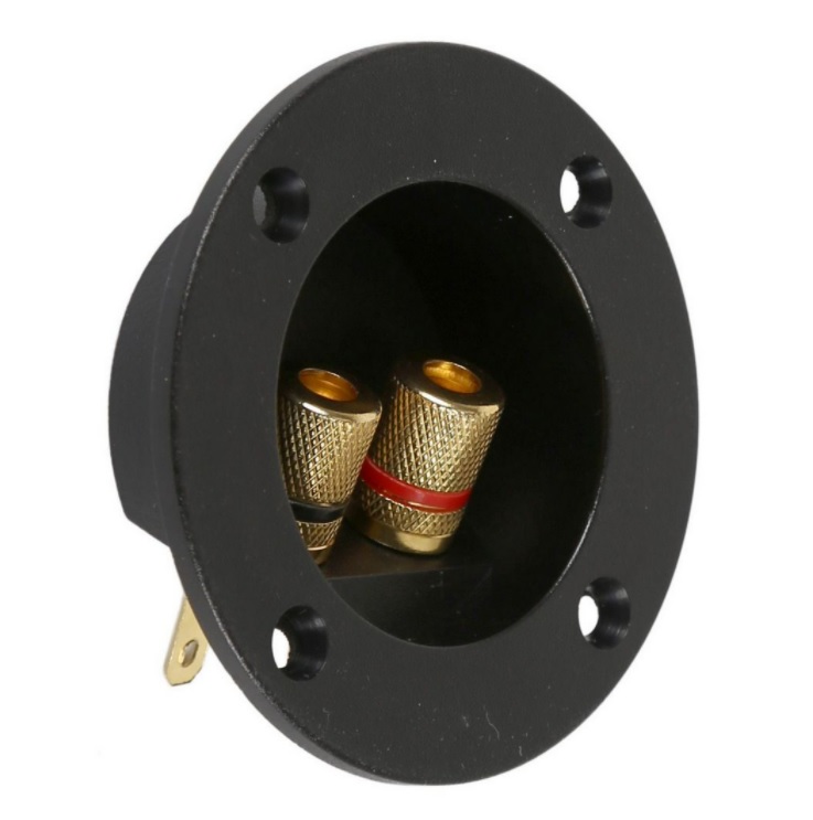

on another note,
how would I go about installing binding posts on these, as the area directly behind the speaker is going to be most difficult to mount anything, and for future maintenance, will not be able to get to the back area through the speaker hole!
I'm thinking on the side near the driver.
alternatively, run the cable from the driver, through a small hole in the back directly to the amp.

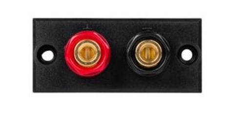

If you use a removable plate/cup for the posts i would mount them on the back (below the triangle)

Kike Zia shows. I do like one with a smaller cutout and IMO the cheap plastic capped postssound better than the the cheap metal posted ones and better than some of the more blingy al metal posts.
PE used to have some that had the plastic nutted posts and a small plate and one only had to drill 2 holes, those would be ideal for the speaker.

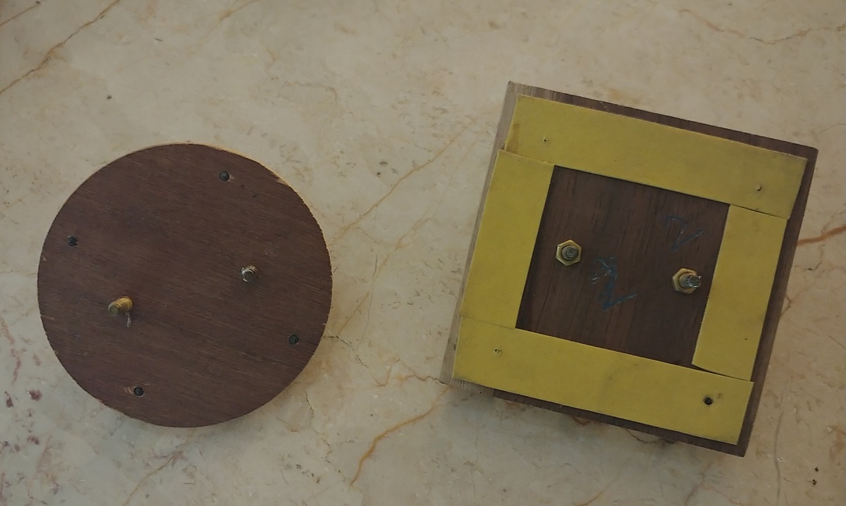

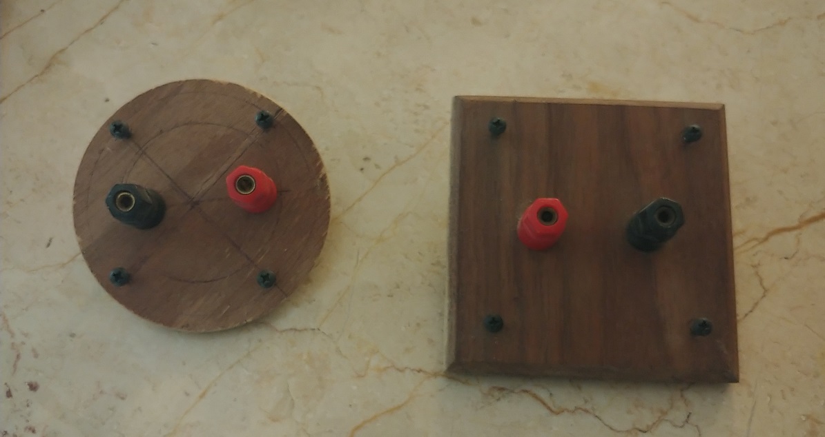

Stevodude,
You are right, these will be hard to access after gluing up the cabinet.
Do you have 3 mm - 6 mm acrylic? I am suggesting to make a DIY terminal cup.
The idea is to have a 3-3.5" circular piece of wood and insert the binding posts within a 2" diameter are (from the center) of that piece; then fix that piece of wood to the main speaker body like any other terminal cup type post.
It's also possible to make with 6-12 mm plywood/MDF.

What Zia said. It only needs to be a flat plate large enuff to hold the posts (standard spacing is ¾”) and 2 screws at either end to hold it in place. But you can get as exotic as you’d like.
His example is exactly what i was thinking of.
You can undo 2 screws, pull the works out of the box, solder or unsolder, then reinstall.
