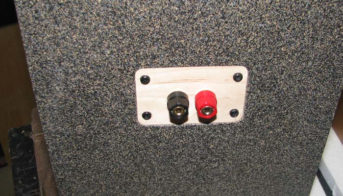

Made 2 binding plates out of some scrap alluminium I had floating around.
Going to look pretty sweet.

stevodude,
That's looks really nice. Just make sure that there is NO possibility of any electrical short happening. Can you check with a multimeter please?

Thanks, I'm pretty happy with the outcome.
tried a few options, wood looked too agricultral, and plastic, well, it's plastic...
These Posts are isolated front and back with plastic, with inner plastic sleeve.

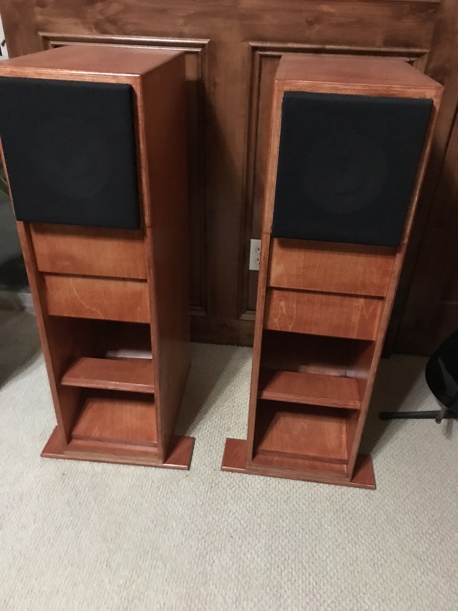

installed and opperational!
They sound really, really good.
Hooked them up Saturday night, and could not stop playing record after record.
Currently there is no finish on the wood, and I'm torn between 2 finishes that are polar opposites, clear coat lacquered, OR 2 pack shiny black.
Shows the height of them, I'm not that tall, 175cm
All the photo's of the build here -- > Kirishima - Google Photos
Note: The final weight of each speaker is 95KG so be aware if you build these, how you are going to move them from shed to house will need careful consideration. 🙂

Very nice!
Is there a genre of music the speakers sound better with or are they good across the board?
so far I have thrown some radio Kaos <- this was absolutely stunning record, player is a JVC with an at95en to a NAD 3020 to the speakers, Pink Floyd, JJCale, Sade, LedZep, oxygene, john williams musical scores, Velvet underground, so far it's just been lovely on all of them. I do need to do an alignment on the cartridge. 90's Yamaha CD player through the NAD has also been delightful on anything I've thrown on the player.
Listened to a pair of Yamaha NS555AV's and NS700x's last night, and while those yamaha speakers are great, and very accurate repoduction, they are a bit on the shrill side compared to the Fe206s in the Kirishimas, but obviously the Yamis can have way more grunt chucked at them. while the Fostexs are happy with the NAD's 20w and I haven't even gone past 1/2 volume on the NAD.
