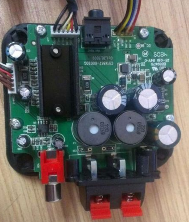

In our case, a turbo switch would switch the amp between SE or bridge mode.
In SE mode, the gain and output power is much less, in trade for fantastically increased audio quality for relaxed listening levels that we would use most of the time at home. In SE mode it doesn't amplify all the annoying noise from your PC/phone loud enough to hear it. In SE mode the gain is lower, also resulting in lower noise and impressive audio quality. This mode does require output caps, and for audio quality a simple array of two paralleled caps is entirely suitable.
Really, the switch to bridge mode is just there in case of beer and party needs. I'll be trying that directly. In that case, this amplifier's ability for cheap loud concert tickets is suitable.
Here's how I arranged the turbo switch.
I put 6600u (that's 2200u*3) 35v caps with the stripe-side pointed at the power ground.
I put a SPDT switch (3-way switch) with the center pin (the switch constant) going to the speaker jack negative. The other two contacts of the switch, the outboard contacts (the either/or). . . one of them goes to/through the caps for SE mode, and the other pin goes to the negative amp for bridge mode.
In se mode, only one amp output contact is used (that along with the caps series to ground makes up the speaker connection). In bridge mode, at the flip of the switch, then both of the amp outputs are used.
For a stereo implementation, use a DPDT switch so you can switch both channels simultaneously. And in color? But, no, that is just barely beyond the scope of this post. 😀
Instead of my negative/groundside example, the datasheet's positive example can be used just as well. If you need a sketch for either, just mention it. I'm just accustomed to doing it groundside, because that is also compatible with split-rail amplifiers, aka just about universally compatible. I just wrote about what I actually used. I'm enjoying it right now. Basically, what really matters is that you put capacitors in series to the speaker whenever using SE mode. You can put the capacitors series to either speaker contact.
The 6600u is for biggie size speakers; however, a 4" could use 940u (parallel 470u. The paralleling is for quality, a great timesaver) to maximize it and the amplifier by eliminating waste loading (pitches below speaker capacity). Smaller size 4 ohm speakers can use this method and result in higher efficiency, since removing waste loading results in a lighter load (a more powerful system, effectively). Custom size this capacitance to YOUR speaker in order to maximize effectiveness.
Results? This did not work exactly as expected. It didn't run much cooler in SE mode, and that means I need to reduce voltage and/or explore heatsink means. Also, I went hunting the bass booster because it did too much for its own good--Yes, in SE mode, I had to re-eq closer to flat. The apparent output power had not been cut by 4x in SE mode, but rather less than that, perhaps 2/3rds or less. Some datasheet deciphering is needed to figure that one, albeit clues do exist; and, so far, I'm in agreement with the datasheet despite different language to describe matters. Thanks to NXP/Philips for that; and, in that they are uniquely beneficent.
Homework: According to the datasheet, the TDA8932BT that I have, is incompatible with high voltage fun, and I'd actually need the TDA8932BTW for that. Oh darn! Will this maintain its really high end performance in SE mode despite using much safer lower voltage for longevity? I couldn't find a likely ideal 24vdc or 25vdc SMPS, so I'll try 19.5v and report back directly. Let's find out.

Well, the Dell 2-wire supply that I had found didn't help audio quality. SO, I plugged in that 3-wire NEC supply, 18.5v used earlier. Apparently, SMPS do vary on quality. It does help to have the sensor lead go all the way to the amp board rather than cut short at the SMPS enclosure. Who knew?
As it turns out, a direct comparison (same supply) as previously used in bridge mode, is even more appropriate. It will be more meaningful. I do so wish I'd have though of it rather than doing things correctly on accident. Gosh.
Anyway, in SE mode, with the same supply, the results are significantly different than bridge mode.
What I was expecting to happen is a whole lot of clipping. I was enjoying the output and didn't change the volume level. Then I lowered the voltage. Theoretically, that should not go well. But, no. Ixnay for making sense. The thing didn't clip at all. I think that the audible quality went up, rather a lot.
For sure, if you're after quality, try single-ended, SE mode. There wasn't any shortfall on quality. None whatsoever.
Problem! I does not boot up in SE mode, as I have implemented it. I had to disconnect the speaker and then re-connect the speaker to get it to play.
Also, I tried the output caps series to positive side. No dice. Then I also had to disconnect and reconnect the speaker before the amp would play. That is not convenient!
So, I also tried the opposite amp. Same behavior. Halp!!!

Turned up last night. I whipped off the covers and soldered a twisted pair to the power socket. Although I ordered the power supply, it didn't have the matching plug so was useless without hacking. The unit has a 3.5mm audio input which works and the front knob is a digitally controlled volume. I couldn't find the Bluetooth with my mobile phone so I used the wired input. Pleasant enough sound from the phone, no major annoyances so definitely a bargain.

I don't think its the BTW variant - there's a heatsink bar strapped over the top though. Why is the SE mode 'higher resolution' ? I plan to convert mine to BTL via a transformer....

SE mode with 24v actually has enough power for me, so I didn't end up using that Turbo Switch idea to kick it in to BTL mode for approximately three times the power at the cost of halving the quality, because that wasn't needed. I didn't need either the increased power or half the quality, so I didn't need BTL mode.
What the Chinese manufacturers might have missed is the speaker level DC filter cap quality and size. There's two big caps of the same size. They need to be low loss and either 4700u for a big bookshelf speaker or 6800u for large cabinet speaker, and, optionally you can add a 4u7 bypass cap under-board for treble quality (I used a nichicon ES for bypass cap). Other filter sizes are possibly optimal, depending on the speaker, as for example a 4" woofer with a compact enclosure is likely to want a 1000u filter cap, and the board may already have that. What size does that board have? There is an excellent sport to customizing the filter cap size to maximize your speaker, within your application.
If these caps are too big so that the amp doesn't start up, the 47u cap at pin11 (standby delay time) might need to be increased to allow more charge-up time.
