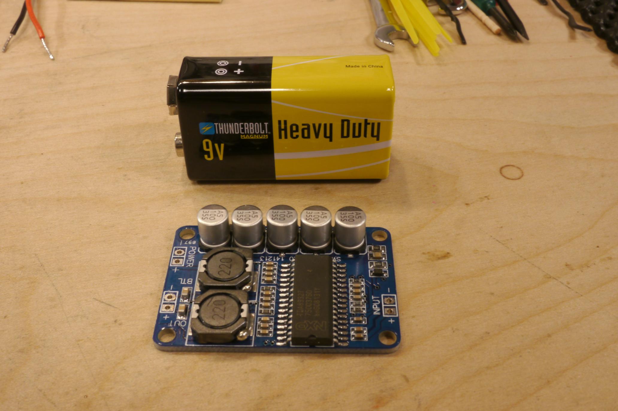

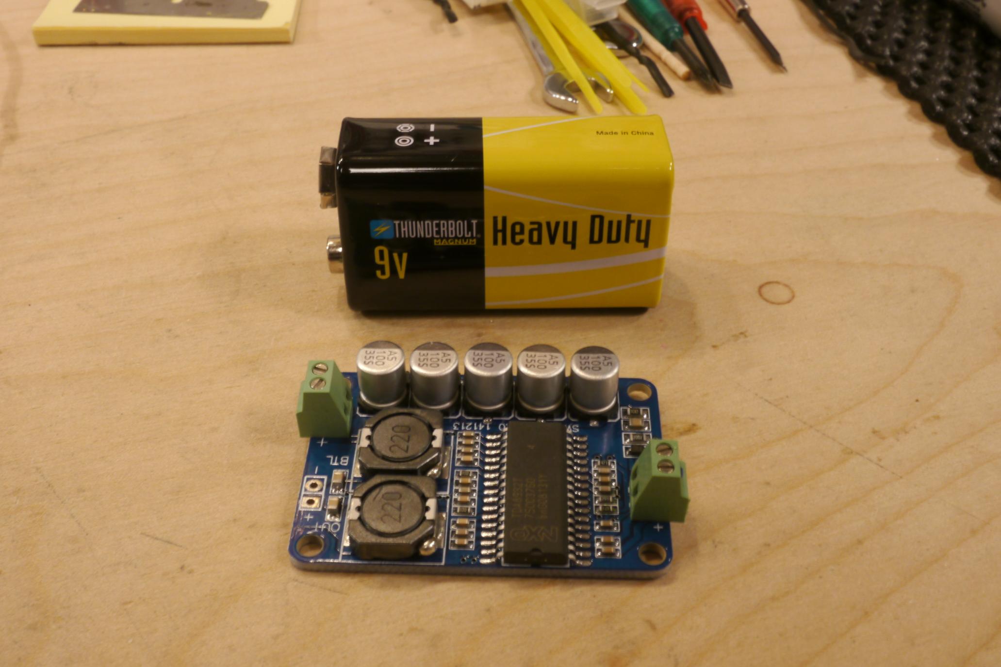

My amp boards arrived today. This thing is stupidly small. It's the microAmp! Here are couple of pics with a 9V battery for some perspective. I was expecting something a little bigger. The little green connectors work great, but be careful on the speaker-out. You need a little strip of insulting material over two SMD caps/resistors that the connector will rest on. Otherwise you run the risk of shorting them out. Not good. Amazing sound from such a tiny device. Cool. :)
I really like the sound myself. Two of them give me plenty of volume.
I recieved mine and i have to say that i'm really impressed with what i got for less than 6€.
The strong bass is very audible.
When i first listened to the amp i had to check the eq.... but no extra boost was set.
The amp gets quite warm and so do the inductors.
In my experience the class d amps with small inductors (like the cheap blue TDA7492 or the sure TPA3116) get hotter than others.
thanks for the pics. I've bought those green things before but I don't know exactly what they're called. Screw terminals? I don't know. I need to buy some more, know of a good seller? Or what keywords I should use to search? Thanks in advance.
Also- are you going to use separate power supplies as recommended earlier in the thread? Seems like that would significantly raise the cost of a stereo project. And did you go with 19v?
Also, are you going to use separate power supplies as recommended earlier in the thread? Seems like that would significantly raise the cost of a stereo project. And did you go with 19v?
1 supply with 2 schottky is cheaper.
left v+ <- 19vdc -> right v+
The diodes (shown ->) are serving as a "Y" splitter.
They'll work best if situated as close to the amplifier board as possible (on the amplifier board if possible).
MBR1645 works good, and is very efficient.
MUR can also be used as can almost any diodes rated at least 3a, like 1n5405.
