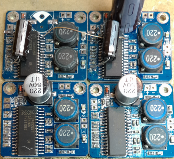

I've gotten some of the Taobao PCBs, they need several mods to get the best from them. Pic attached to demonstrate, some of the mods are hard to spot so I'll spell them out in a little more detail.
1) The input on the PCB is only single ended, but as the IC has a balanced input its best to make use of this functionality. I lifted the cap shunting the -ve input to 0V and installed my own cap, in series with an input attenuator as I don't need quite as much gain as the chip provides natively (36dB in bridged). Also added a shunt cap to turn the attenuator into a LPF - these are being used in an active speaker (Swan D1010) - there's a separate tweeter amp.
2) Get rid of that next-to-useless 220uF/50V SMT cap. I measured its ESR and it was shockingly poor. The NCC KXE (2200uF/25V) I've replaced it with is about 20dB lower resistance and 20dB lower reactance.
3) Decouple the virtual GND (pin12) with a bigger cap (470uF/10V) for improved bass.
4) Since I'm using a pair of these, I've made one master and the other slave in terms of clocking. Pin 31s are joined together between the two amps, the slave amp needs its clock freq determinining resistor (to pin10) reduced to 0R.
"shockingly poor" is not a number, so what did you measured?
20dB better specs - not a surprise when comparing a 220uF/50V against a 2200uF/25V. 🙄
Oh, well, NCC's KXE series is actually starting at 160V, so there's no 25V parts avail. 🙄
Beside this, those caps are totally different sizes.
So what about some true informations with right specs? 😕
No disagreement there, its definitely not a number. I wrote it because I couldn't recall the precise measurement but I did recall being shocked. So I've just been back to the LCR meter and pulled a cap out of my recycled caps box. Here are the measurements of those SMT caps :
220uF/50V : ESR @ 20kHz 0.26ohm
2200uF/25V : ESR @ 20kHz 0.009ohm
My poor memory again, thanks for pointing out the error. The parts are KZE, not KXE.
You have to be kidding me, no?
No i don't kidding. It is no suprise that a way bigger cap with more uF measures way better than a smaller low uF one. Those SMD/SMT caps are always (more than) a decade behind their through-hole/wired cousins.
May i ask for the resolution/accuracy of your LCR meter?
The KZE datasheet states 0.015R at 100kHz. As ESR is normally higher to lower frequencies i wonder about 0.009R at 20kHz. 🙂
Well it was a surprise to me that for its physical size the 220uF/50V had such a poor ESR. I have much smaller case size 220uF/16V caps (non-SMT) and they're about 0.15ohm ESR. Bigger cases normally correlate with lower ESR.
I don't know the accuracy of my LCR meter as its never had a cal, but I've no reason to doubt the measurement. I did do a zero check (probes shorted sets zero) before making the measurement. The measurement is easy to explain - the DS gives the worst case and most caps beat the DS by a fairly wide margin in my experience. I agree that ESR goes down with increasing freq, but the portion 20k-100k is pretty flat in my experience, with less than 10% decrease typically. Whereas going from 20k down to 50Hz the ESR might well go up by an order of magnitude.
The resolution of my LCR meter is 100uohm on ESR, it has force-sense probes.
Alright then. Their might be some increase in ESR due to thermal stress at the SMT cap because reflow at first and hotair at second. What actual case size do these SMT caps have? (10x10.5) ?

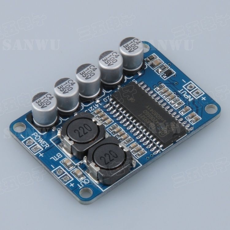

I have two of these on the way, ran across it when researching for a small portable mono speaker. Has anybody actually listened to one of these with 12v input? The size and form factor is near perfect for my application (small mono battery powered bluetooth speaker).
Bluetooth ? Check here http://m.aliexpress.com/item/32527695215.htmlI have two of these on the way, ran across it when researching for a small portable mono speaker. Has anybody actually listened to one of these with 12v input? The size and form factor is near perfect for my application (small mono battery powered bluetooth speaker).
Sent from my ONE A2001 using Tapatalk
There's no vias under the caps. On that board, the 5 caps paralleled is already low impedance and low inductance too.Daniel does that board have alternative options for those SMT caps? Mine has footprints for both through-hole and SMT. If there are two options, definitely replace the SMT caps with some through hole low impedance types.
There may be a caveat if one of those caps is significantly different from its peers (the Achilles heel of array decoupling); but otherwise, it should work perfectly.
