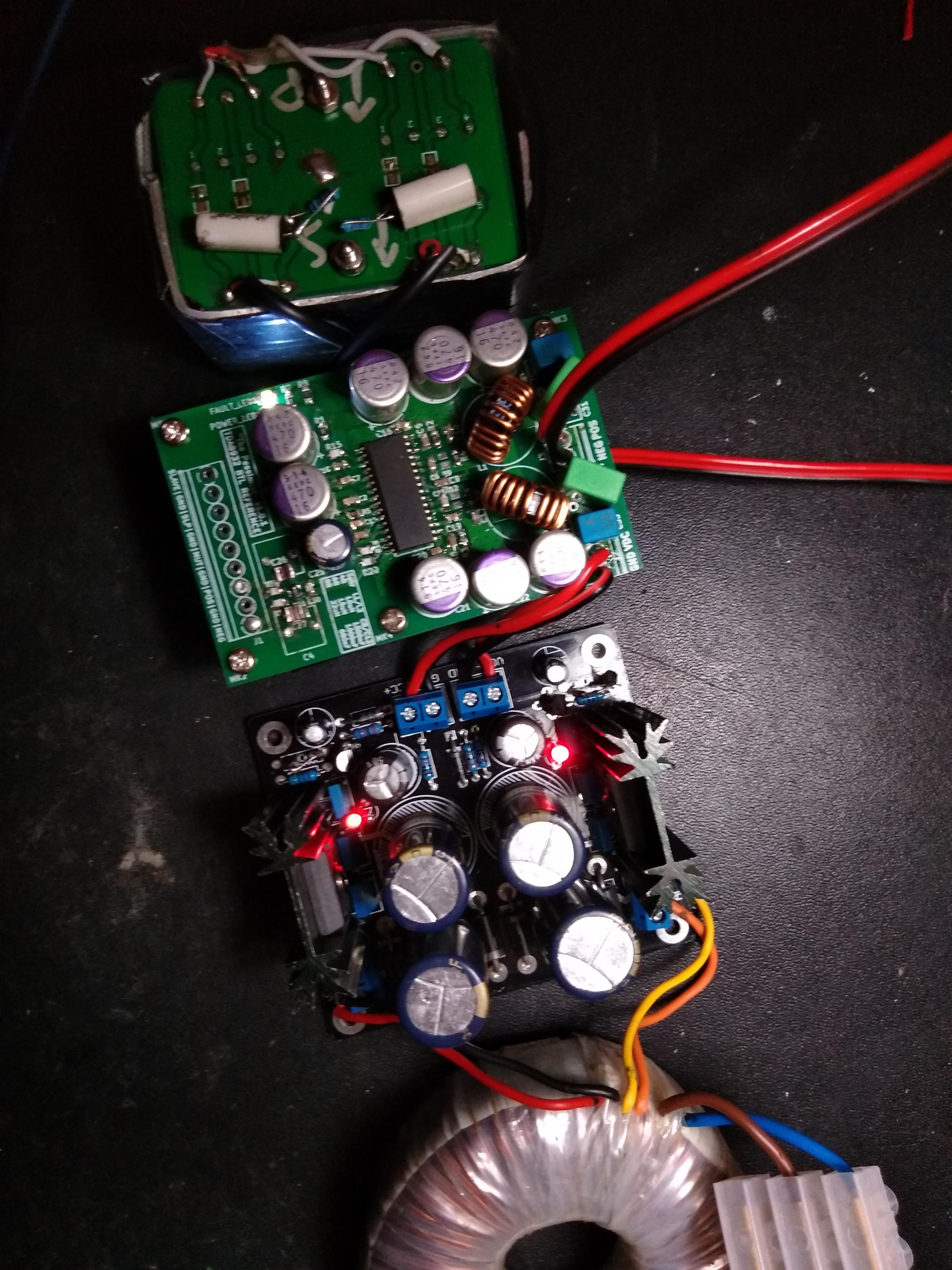

Matt's amps are doing well 🙂 these two are a stacked pair of fully isolated mono amps with independent 14V psu each and 10K:10K transformer input - centre tap to pin 12.
The input transformers are a mere 35H so they sound a little bright - 12kR + 0.022uF across the secondary has mitigated that. They live in homemade shields since they didn't come with any.
14V psu is 50va 2x 15-0 trans, with each regulator having 6600uF smoothing, LT1083 with 12v zener + 1N4007 diode at the base. Although the PCB has two regulators on it, they are not connected at all and work independently.
Amp pin 12 has 220uF Panasonic FC. The other caps are Sanyo 470uF solid polymer. The output filter is designed for 6ohm with Sendust toroids. Sound quality is hard to fault 🙂
Some loose ends - the fault light comes on briefly at startup and shutdown since I started using the input trans, and the background is also a tiny bit noisier with trans than with caps - I've yet to do grounding/earth so everything is floating.
So, she's ready for case so then I can do the earth/grounding. 🙂 Not sure when that will happen tho - work kicks off next week so Christmas hols seems likely.
