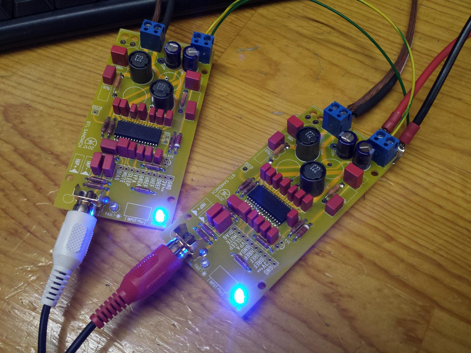

My TDA8932-
https://goo.gl/photos/NeTGW3yKBvwEHDzG8
I wanted to create a TPA32xx board, but wasn't sure I could deal with the pin spacing on the ssop parts, so found the TDA8932 which is in a size I can deal with, and used the datasheet as my guide.
The board has the taller parts 'mirrored' so 2 can be 'sandwiched' together with the parts facing inward. I'm not sure why I did that, but I did. There was only one mistake (that I know of)- I used a Wima cap footprint on all the 0.1in spaced caps but I didn't realize the hole size is too small for the normal/cheap caps, which means I had to use all Wima caps. Which also meant my 'sandwich' was not as compact as it could be since I didn't plan on the taller caps in several locations.
So, I assembled what I had and hooked up the pair to my speakers (Fostex Fe167 in a decent sized MLTL(?) box (http://www.mtcnet.net/~henryvm/fe167e/P6230517.jpg). Since I wasn't thinking too clearly, I just hooked everything up, set the power supply to 12v, and turned them on. My expectations were low, but I had music playing a few seconds after I turned on the power- very nice surprise.
I made a few voltage checks, checked the mute, tested my diagnostic led by undervolting, then turned up the power supply to 19v (what I expect to run at with laptop power supply). Played music for about 30 minutes (loudly)- sounds pretty good to me. I checked the heat of the tda's, they were quite warm but could still touch them. I decided to see what 24v would sound like, so cranked up the power supply. I discovered my power supply current limit was set too high- how? When one one of the amps started to smoke and the power supply went crazy. I destroyed my first tda, but had a few spares so I replaced it. Works ok again, but I keep voltage below 19v until I figure out what may have happened.

I forgot a 100nf cap on the board that had the tda smoke/internally short out- a bypass cap for dref. I only noticed the missing cap after trying to figure out how much space I had to fit some kind of heatsink (and its now obvious when looking at my pictures).
I'll assume the internal regulator did not like the missing bypass cap. I think if it was heat related, the tda would go into one if its many error modes of self-preservation.
I tested the pair of boards for several hours, running at about max volume and at 19V (I have gain reduction per datasheet to about 31db). The tda's get quite warm but I can still touch them without losing fingerprints. I would still like to jbweld something to the chips, though. I wish I had paid more attention to the thermal sections of the datasheet, but I mostly skipped them because of the 'no heat sink required' in the first part of the datasheet. It appears the four corner ground pins are designed to move a lot of the heat, so maybe some 'end plates' soldered on the end pins would help also.
I don't have a lot to compare with, but these amps sound very nice and with efficient speakers can get quite loud (more is always better it seems, but its probably a good thing to have hardware that keeps one from listening at levels louder than necessary).
I would also add that NXP does a good job with their datasheets (their microcontroller datasheets are good, too). I followed the datasheet example pretty closely and ended up with a nice amp.
