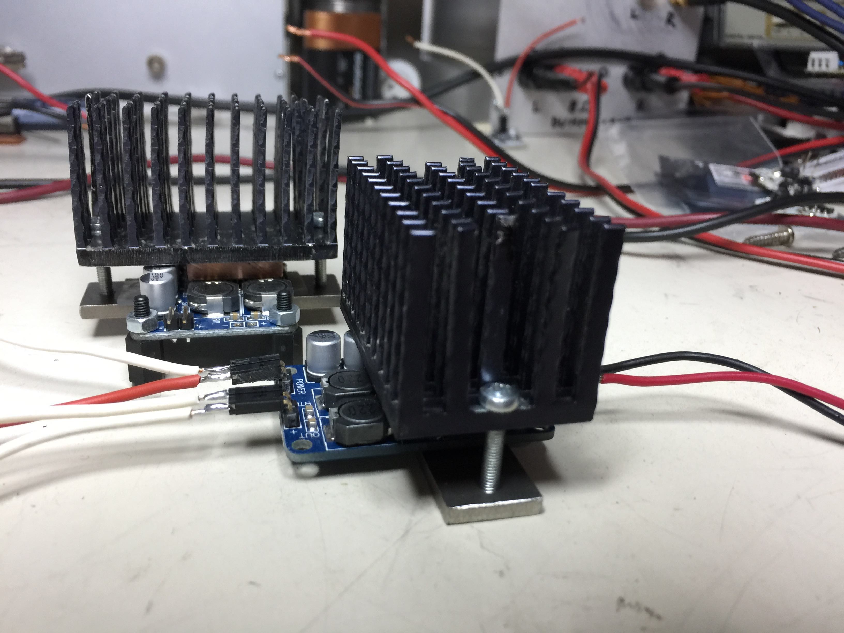

TDA8932 plus Heatsink
Got two of these nice amp board same as OP.
I've run both trough their paces : 24V DC supply , 8Ohm Load , Sinus stimulus.
No big deal here they perform as advertised; pending more accurate test, that i will post on the forum as soon they are completed, I left them idling with no signal input , after an our or so i did find them too hot, so I decided to put an heatsink on them . Included are the pictures of my hack to put an heatsink on the board that is not really meant to have one.
The heatsinks are from old cpu coolers and a small copper block, cut at dimension, is used to ensure good thermal contact plus enough elevation not to touch the capacitors near the chip.
The finned part is screwed to a metal bridge tab insulated trough a small plastic insert that keeps everything together.
TEST : after an our at 25.4 V supply @Tamb 26.5c , Theatsink is 35.5c.
not bad from too hot to good .

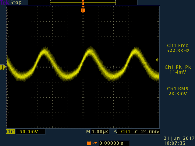

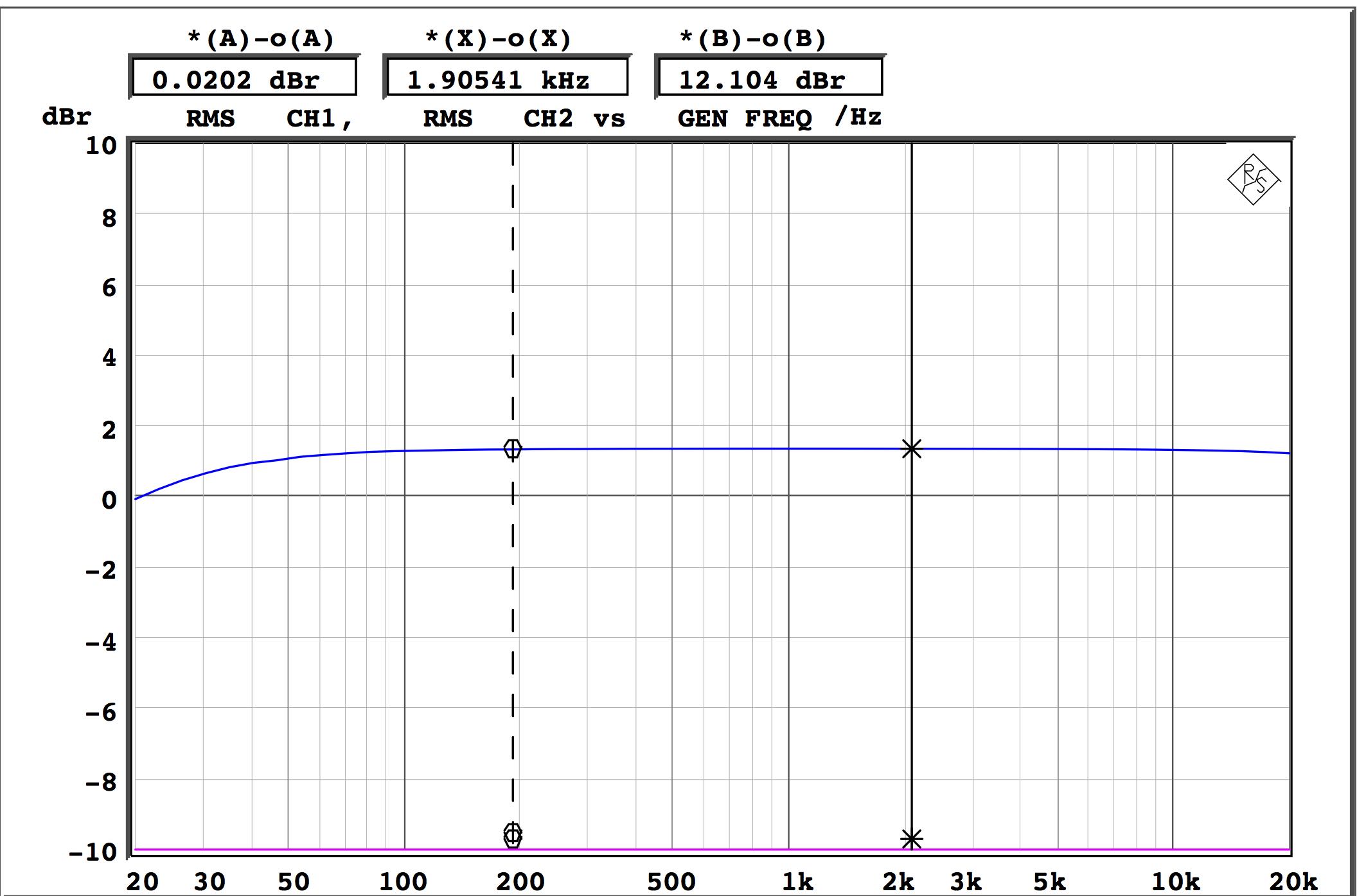

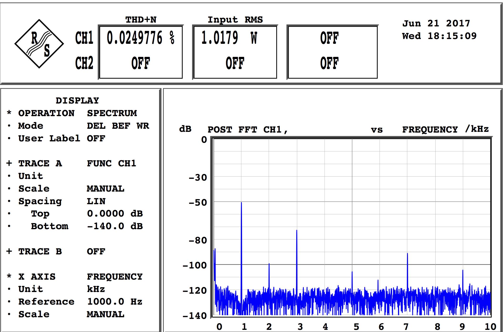

TDA 8932bt Test
Hi all
In the end I managed to do some testing of the board today and here are the results.
Test Parameters
Power supply @ 25,4VDC stabilised
Load @ 8 Ohm
Pout @ 1 W
Tamb @ 26°C
about the graphs
Residual is a snapshot of the output without input it shows that the internal pwm oscillator runs at 522 kHz well above the audibility human threshold and also above the tweeter possibilities.
THD is pretty clear, it's total harmonic + noise @1kHz @1W plus a graph of the spectrum of the firsts 10 harmonics
freqresp is simply a graph of the frequency response @1W 20Hz-20kHz.
it shows that there is a small loss at lower than 100Hz but nothing really dramatic, just don't use the amp to drive a super-duper subwoofer as it probably is not so great below 20Hz
While I will not call them Hi-Fi, they are nonetheless, for the price they cost, not bad.
Pending more tests will post here when ready.
