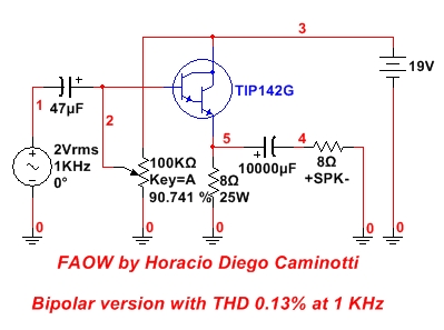

This is what I came up with, with what I have lying around. Output cap is 1000uF, positive towards the circuit, negative to speaker (+). Hope I got that right. MOSFET is IRFZ44N. Input cap is 47uF/25V. Thanks for the design, inspiration, and wealth of information.
I have read that output cap is a high pass function in relation to speaker impedance. If I use 8 Ohm speakers, 1000uF is theoritically flat to ~200Hz and -3dB at 20Hz. Is that correct? If so, I am thinking of increasing the value of output capacitor. Thank you very much.

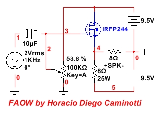

This circuit has some advantages over the circuit that opens this same thread.
The advantages offered by this circuit may not be easily visualized under simulation software, since they are mainly due to the reduction of the static voltage to which two elements of the input circuit are now exposed. It is a known fact that every element exposed to a lower static voltage, shows lower levels of distortion (mainly at low frequency). The difference could be marginal and inaudible, although that could be measured to know in particular if that is the case in this circuit.
There is another advantage that would be a marginal reduction in thermal noise.
The 10 uF capacitor is now exposed to around 4 Vdc of static voltage (assuming 0 Vdc in the output of the previous stage), when it was originally close to 15.67 Vdc. That marks a reduction of 3.92 times in the static voltage. We know that the distortion also manifests differently according to the static voltage between the capacitor plates.
The resistors arranged in series connection (see the 10K value and the 47K value) were exposed between the extremes at 19Vdc. Now, the ends of the 100K trimpot are exposed to only 9.5 Vdc, so the dissipation is much lower and, in some way also, the thermal noise.
Regards

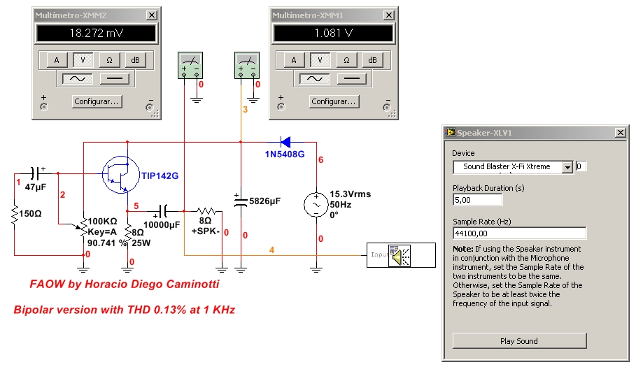

attachment.php

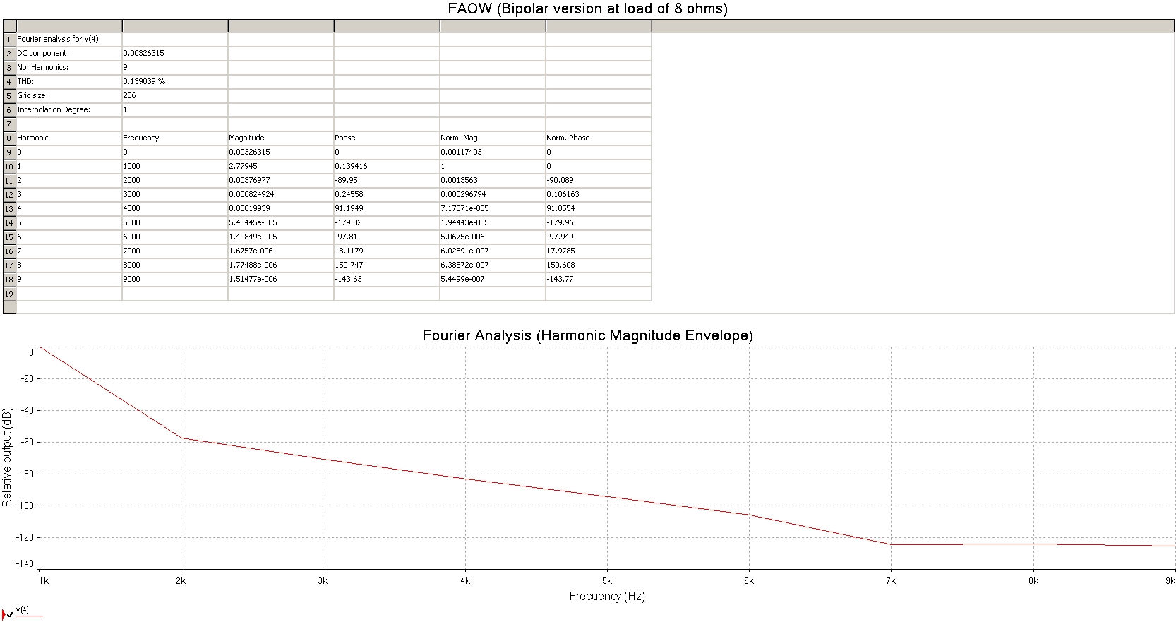

0,483 W RMS at 8 ohms and THD 0,13 % at 1 KHz (0,966 Wp) 😉
0,945 W RMS at 4 ohms and THD 0,48 % at 1 KHz (1,890 Wp) 🙄
Like headphones buffer:
0,122 W RMS at 32 ohms and THD 0,047 % at 1 KHz (0,245 Wp). Output cap of 3300 uF only.

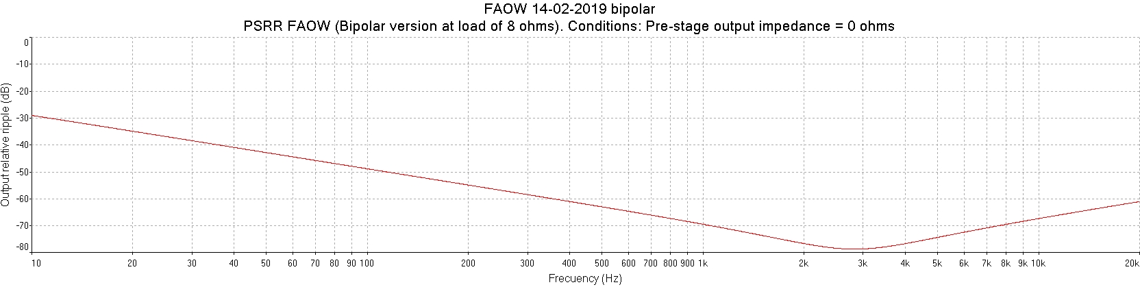

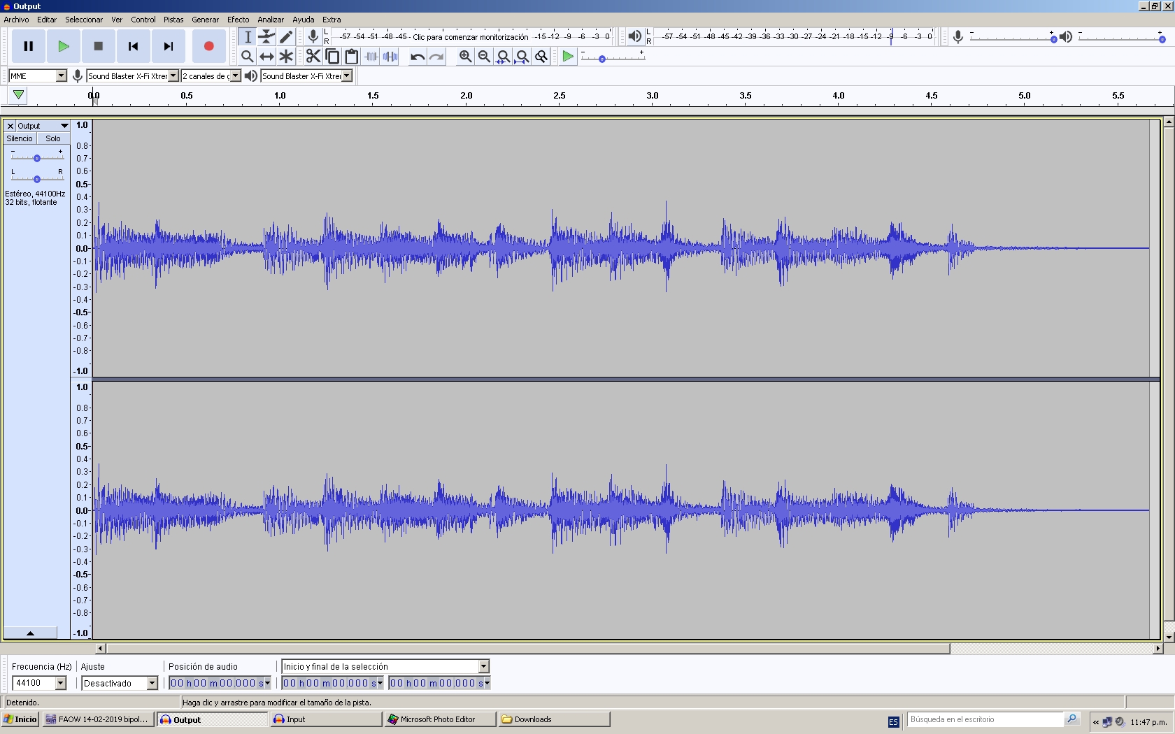

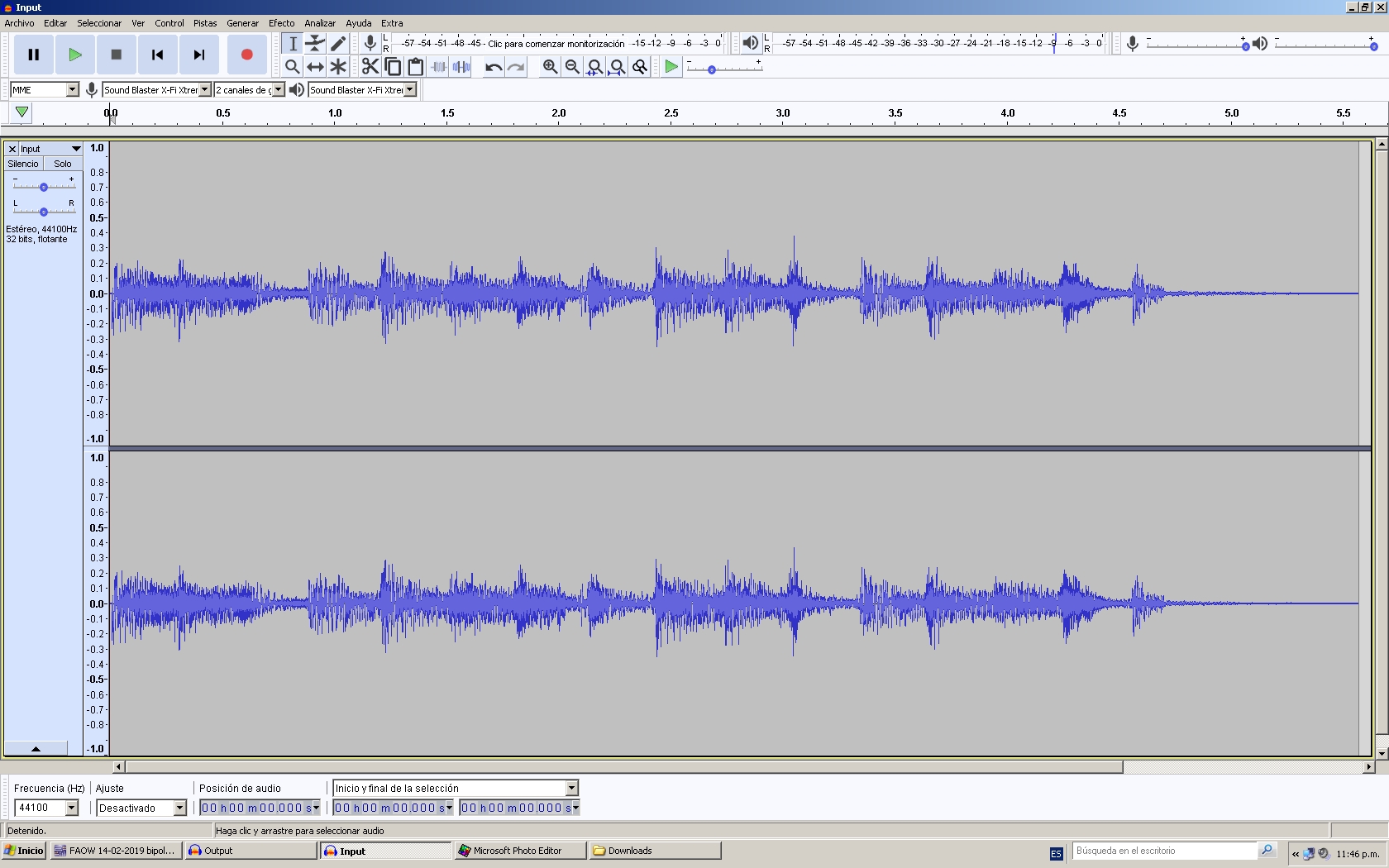

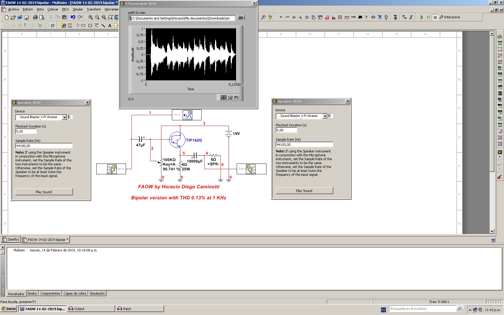

Next, with the help of LabVIEW tools within the simulation environment of the Multisim 14, I carry out a virtual test to compare the sound that is injected into the input, with that obtained at the output of the bipolar buffer.
As you can hear, under resistive load of 8 ohms, it is not possible to find appreciable differences.
Sampling was 44100 Hz. The duration of the .wav files is approx. 5 seconds.
I upload additional images of the captures of the two waveforms with Audacity (Input and Output).
The sound files are in .wav format, so you should change the termination of the .asc files by .wav, in order to reproduce them and make the comparison in your sound equipment.
In the same way, a PSRR test could be carried out with real values ​​of filtering in the power supply, to hear how intrusive the ripple of the power supply line would be in the output of the buffer.

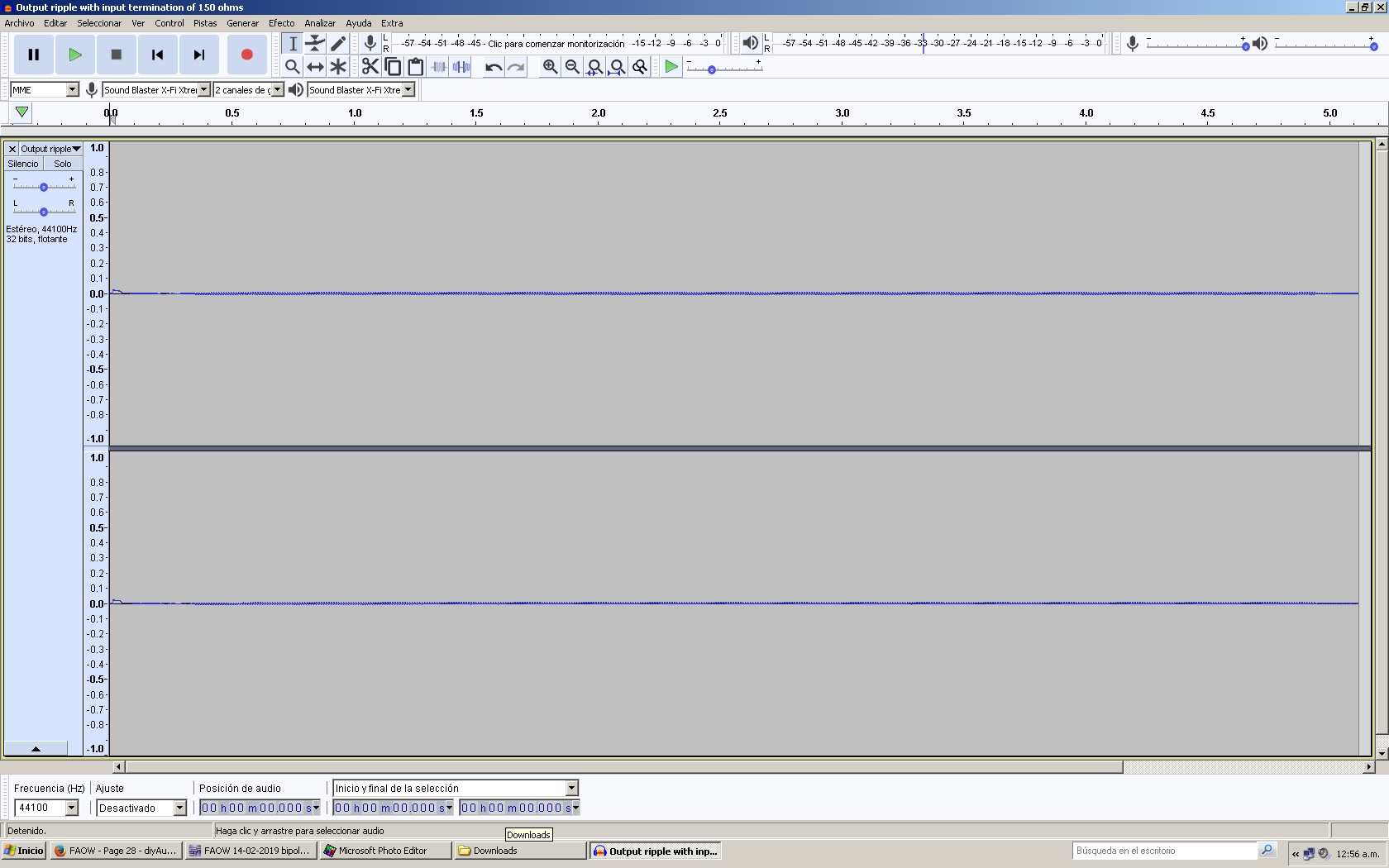

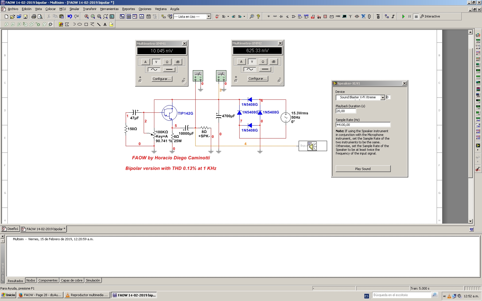

With input termination of 150 ohms (Zout of a conventional opamp, for example), the PSRR is around of 35,88 dB at 100 Hz. Remember to change termination .asc by .wav.
Then, with a filter capacitor of only 4700 uF (somewhat mediocre for the typical consumption of this buffer), the maximum signal-to-noise ratio would be around 45,98 dB.

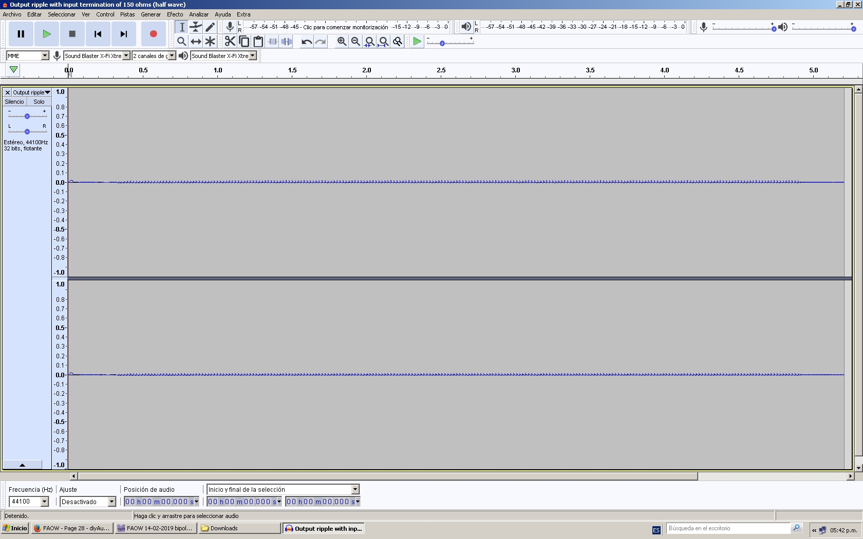

This is just out of curiosity. What would happen if we feed the same circuit from a half-wave rectification, maintaining a similar average voltage value of the power supply?
Would the background noise due to the ripple be more or less intrusive in the audible spectrum, compared to its full-wave counterpart?
In the example, it has been compensated with the value of the main filtering, to maintain the 19 Vdc.
