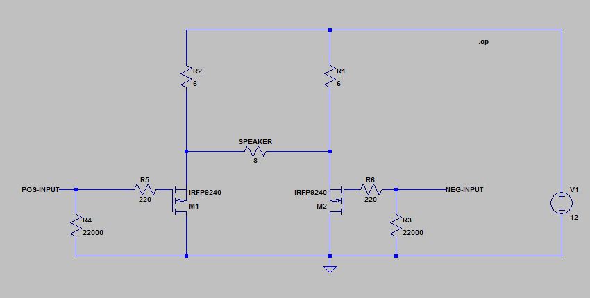

And the balanced version. Fully DC coupled for the brave.
Closely matched P-channel FETs is important to minimize DC-offset.
This amp with bulbs instead of 6R resistors.
Can it be fed at pos input and neg input from the DAC without connecting the gnd of dac do the gnd of amp?
As the DAC has 3V DC on each output, if I don't connect the ground, I could go without coupling caps...
you can , but changing what's needed for compensating 3Vdc output level
circuit shown is on concept level , needing perfectly matched mosfets and even then speaker is not safe from Big BadaBoom
yes matched mosfets to have near zero ofset.
So DAC GND connected to amp GND is not mandatroy with balanced signal?
directly connecting GNDs isn't a problem (and it is recommended btw. ), and you'll have real ones , if using said circuit

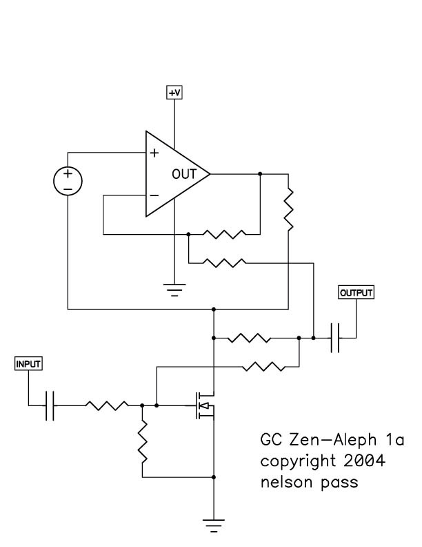

Build flea class A with Texas Instruments LM3886 chip for Aleph CCS purpose. Mr Pass solutions are " my cup of tea ".LM3886 THD+N <0.002% from 1 to 10W.

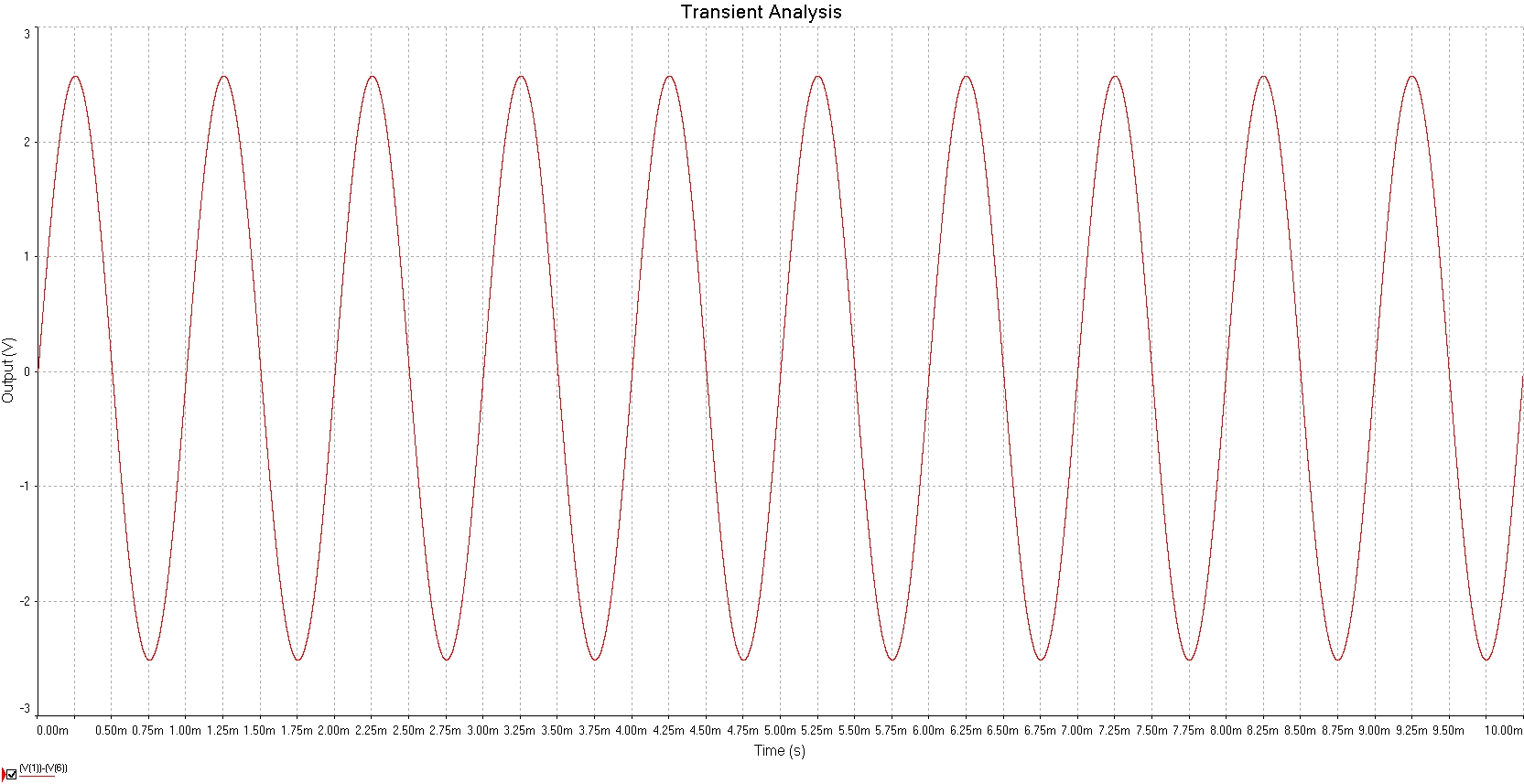

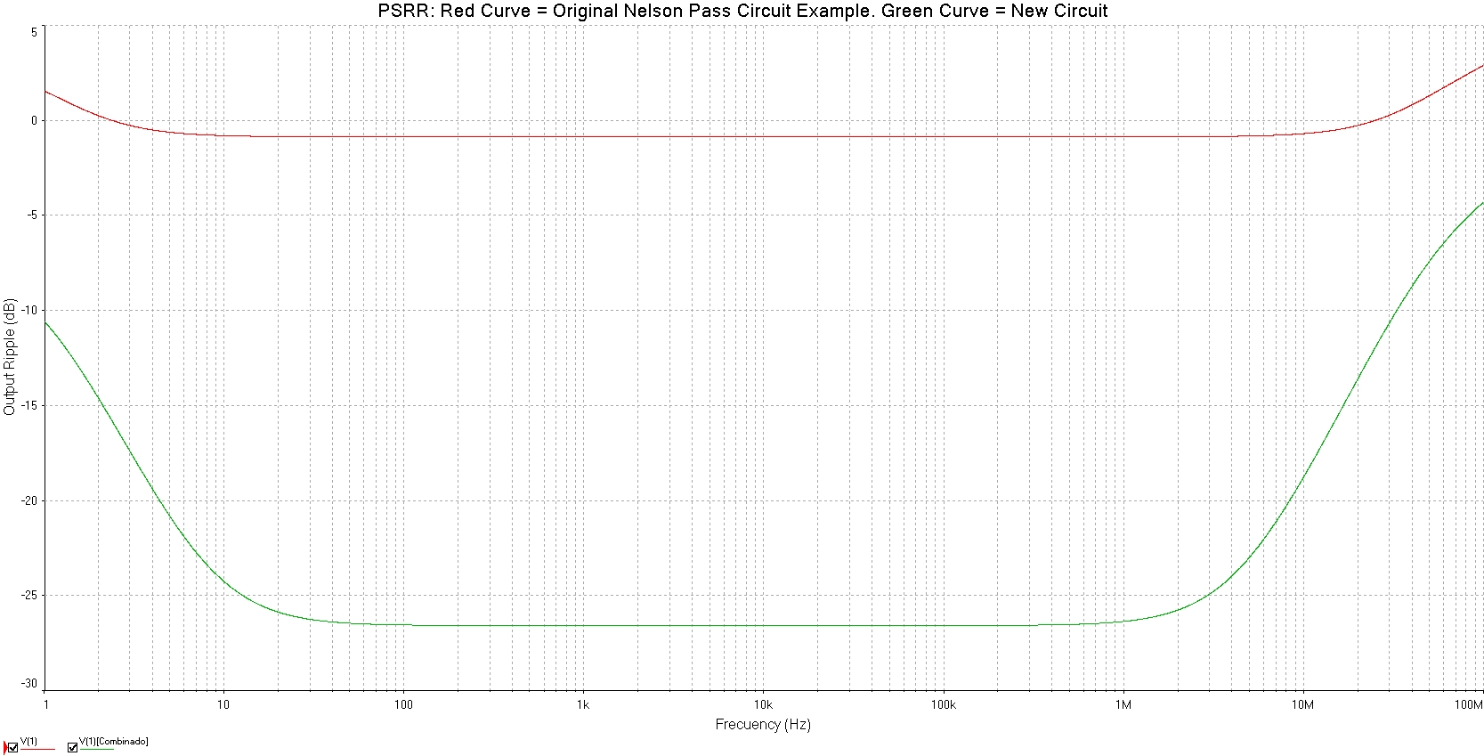

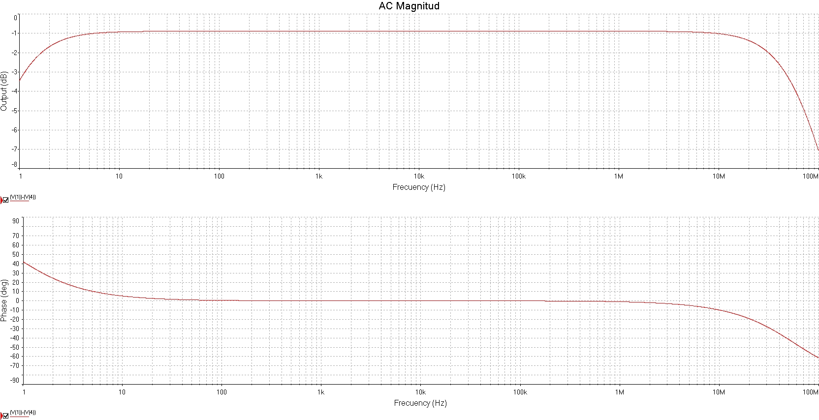

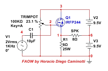

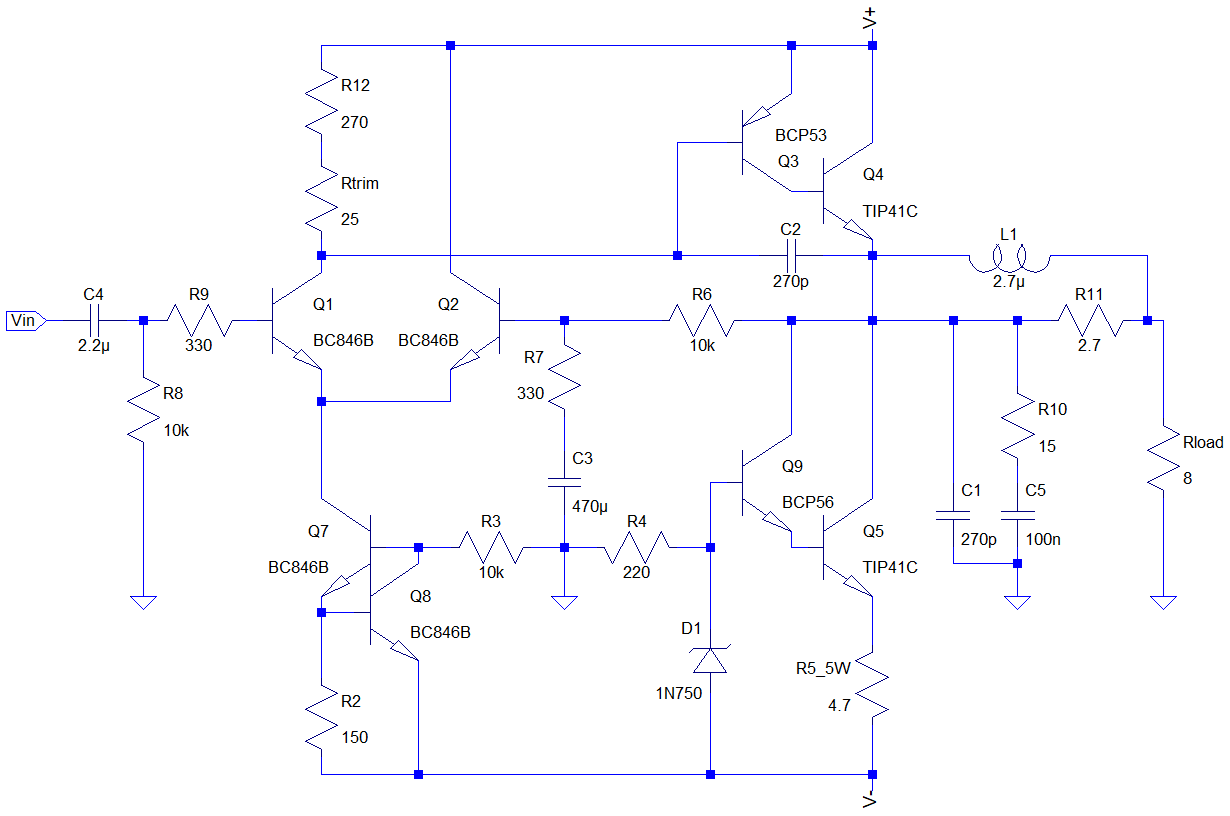

My personal response to this entertainment provides two peculiarities: the output capacitor is eliminated, so that the lower cutoff frequency is partially defined by capacitor C1 and the attenuation slope at low frequency of the buffer becomes 6 dB per octave and not 12 dB per octave; another parameter that is very favored with the changes is the PSRR, which increases significantly within the audible band (for example, the difference reaches 25.72 dB at 1KHz).It's a slow day. Time for a little entertainment - a micro project!

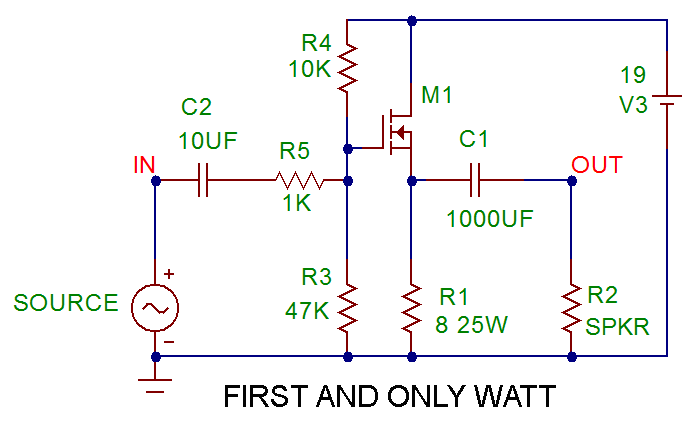

Someone sent me a request for a simple 1 watt amplifier.
How could I resist?
My answer:
Assuming that your preamp can put out 2 volts (and it should),
a 1 watt design would be the easiest thing in the world.
Attached is an example.
I will put it up on the Pass Labs forum at diyaudio and see
what kind of suggestions it gets for construction and improvement.
Feel free to post questions.
"Zen Mod" will likely be the first to take the bait.
The following draws 1.5A off a 19V computer desktop supply and gets
1 watt into 8 ohms at about .5% THD.
C1 simultaneously defines the lower cutoff frequency and the low frequency PSRR (together with the impedance of the previous stage), so it is necessary to define which value finally we should choose as a compromise solution.
My strategy was to connect the speaker between two almost equally noisy points, so that they tend to be suppressed 🙄 (See Nodes 1 and 6 in the schematic, both with respect to Node 0). In this way, we avoid filtering additionally the polarization of the gate through the 100K trimpot, if the aim is to use as few components as possible.
Regards
Diego

Nice work Diego. The improvement in PSRR comes from dual rails which have balanced ripple that cancel out?
