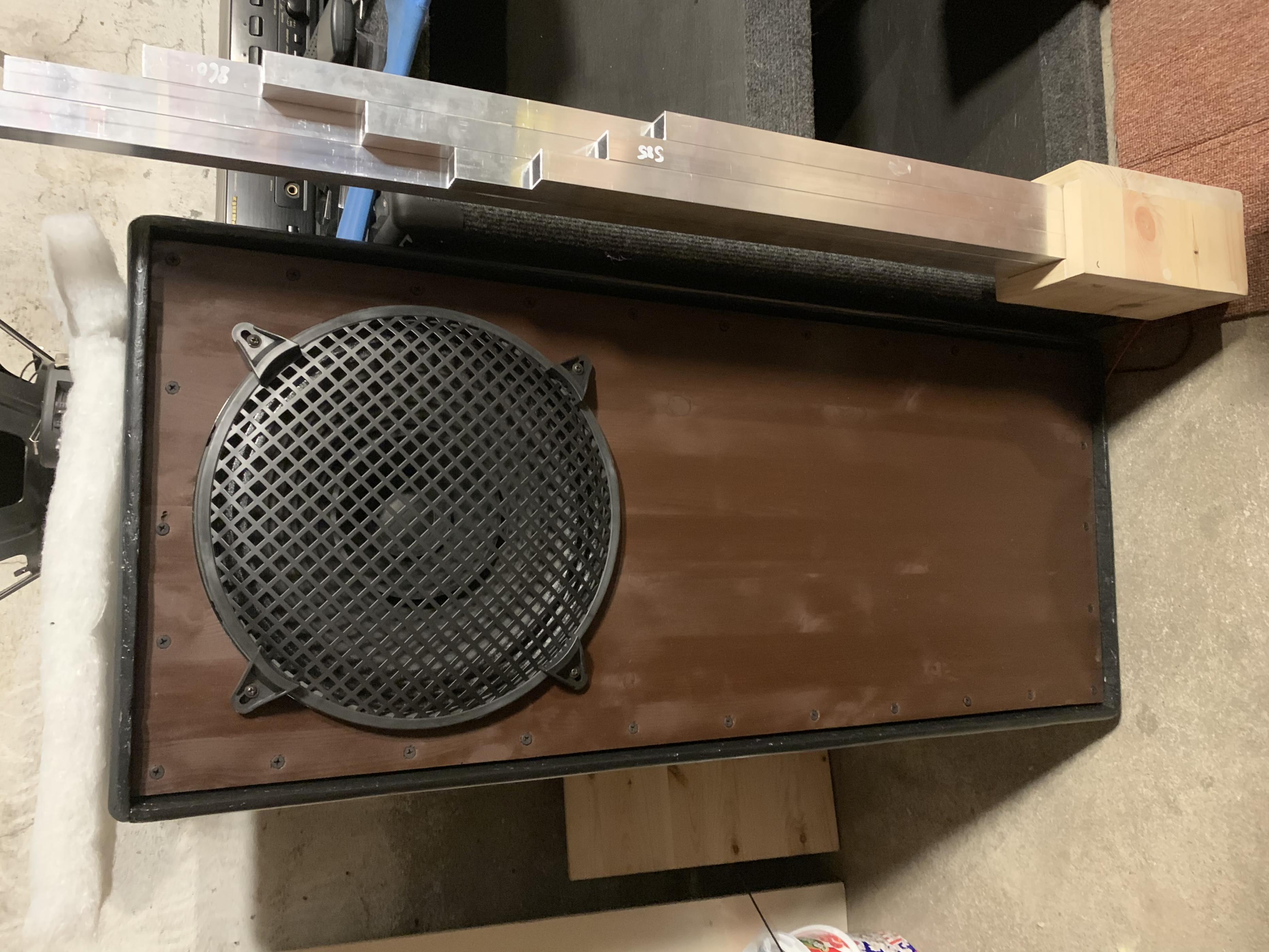

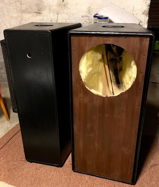

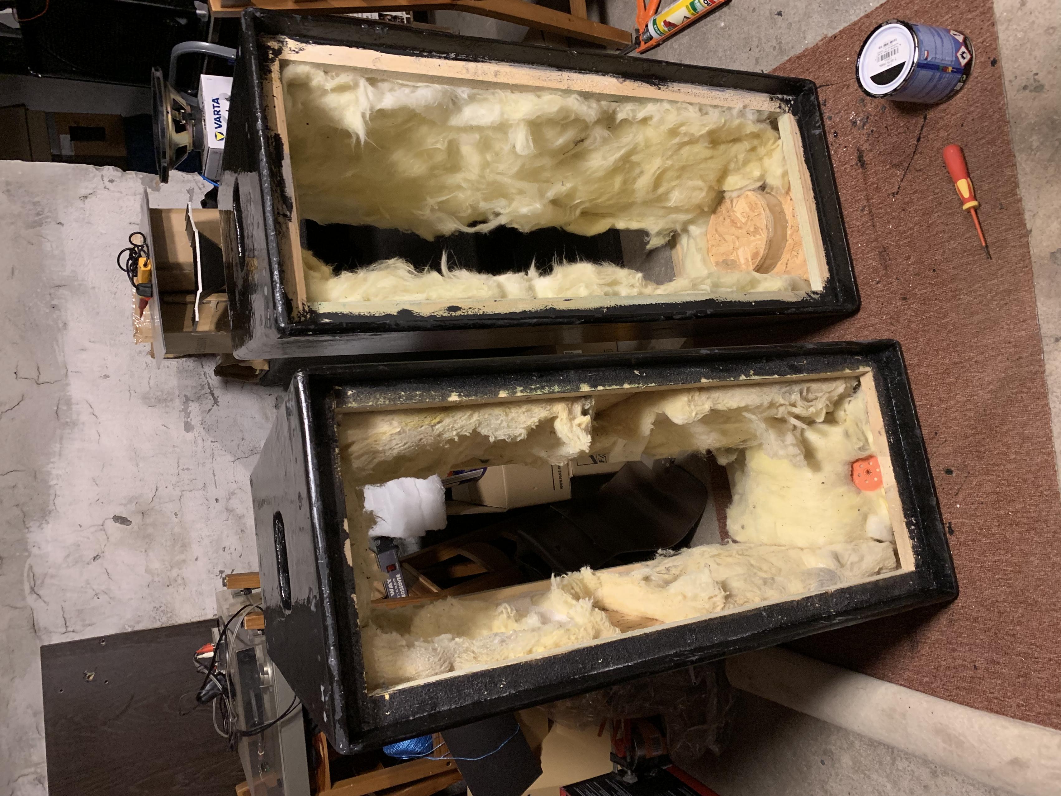

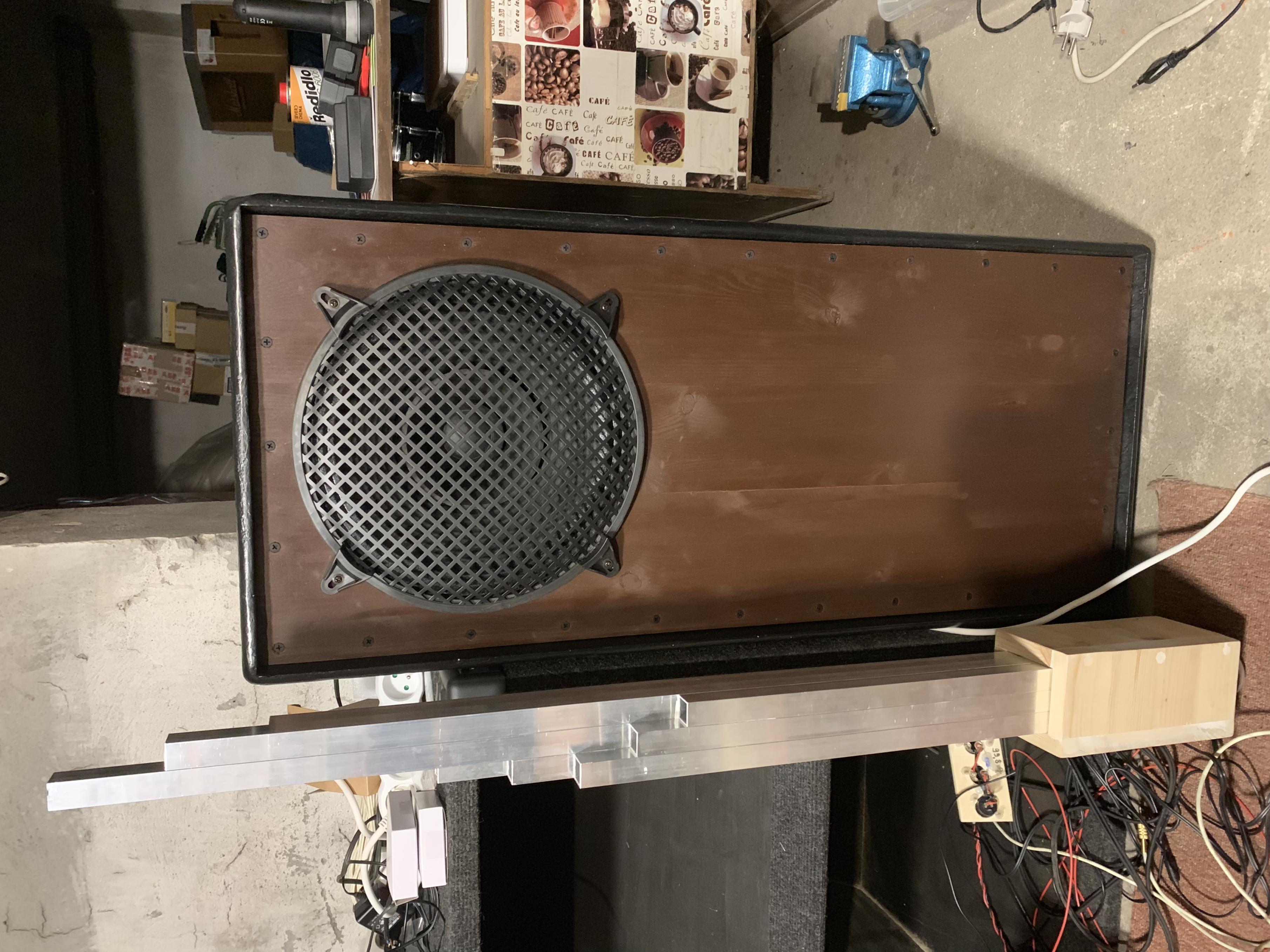

These are my soon to be finished boxes for the Fanes. Ca 90 l (ext. dim. ca 95 x 40 x 40/27 cm trapezoid) repurposed line array boxes, I need to cut new fronts and backs. I did just some basic sanding, filling and painting, the main purpose will be a "garden PA" with FH1 style subs biamped, but during the winter, they will be connected to my EL84 or FU32 SE amp as a backup to the main speakers while upgrading and tuning.

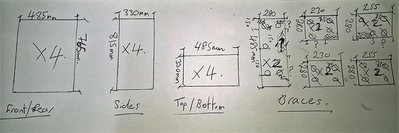

Hmm, thought I posted it already; must be on one of the other Fane threads. Anyway, don't do drawings, just post Hornresp sims with all the data and for sealed, Dave p10 has already posted the classic vented or sealed cab is ~ 54 L for this driver:
45.72 cm Width [baffle], 20.685 cm Depth, 57.258 cm High
driver offset from top: 24.05 cm
vent offset from top [if used]: 48.555 cm
vent: 5" dia [12.7 cm] x 18.2 cm
All dims i.d. [inside] and approximate. Damp to 'taste'.

I posted these yesterday, but they ended up attached to another thread.

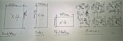

My dims are hand written, and were posted on Audio Talk, these should be a close match the Steve's Speakers.
The other attachment is from a Post on Audio Talk.
View attachment fane12-250 sealed Cabinet Dimensions.pdf

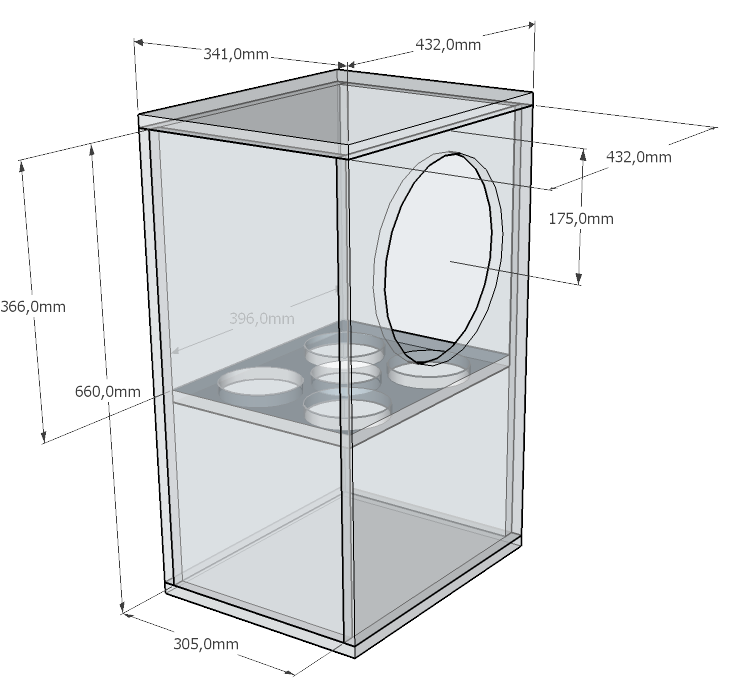

I made a drawing a while back also based on Steve’s given dimensions. Here it is if anyone has a use for it. It was made a while back so best double check with Steve’s dimensions (I think he gave them in the game 12-250tc thread).
