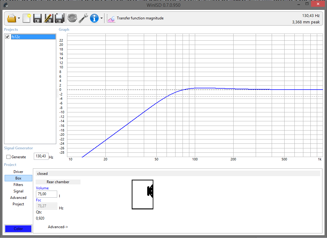

a 250L ported enclosure (or bigger) can get you to to the low 30's says this quick simulation with factory specs, but only if you keep the wattage low (>10w) otherwise it gets in overexcursion as the xmax is only 4mm. The lower you tune your box, the lower the wattage has to be to avoid over excursion. But with a 100dB/1w/1m speaker you only need a few watt to be very loud in your room. WinISD (the freeware soft used here) can give you an id how low and so...

Edit: i included a quick sim in WinISD for the fane in a 75L closed box using factory specs. For sizes i need to calculate to much while i'm in holiday... But there is software that can do that for you if you can't do it yourself. I've used basscad for that a few years ago and there are probally better arround now also.

75 litres is the max recommended in data sheet.
That spec must come from the marketing department. Creates an undersamped enclosure with a bump up in the bass (as much as this driver can produce bass).

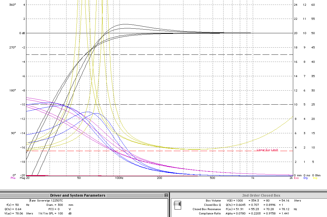

From the sim 350 litres tp get Q of butterworth or lower.

In 350itres you have F6 in the low 40s, F10- in the low 30s. So room will play a role. Do note that F3 (that is often looked at ~55Hz) has been shown to be a meaningless spec for the human ear/brain (ref Toole)
In a small box F10 riss about 10 hz and roll-off does not match (potential) room gain as well.
