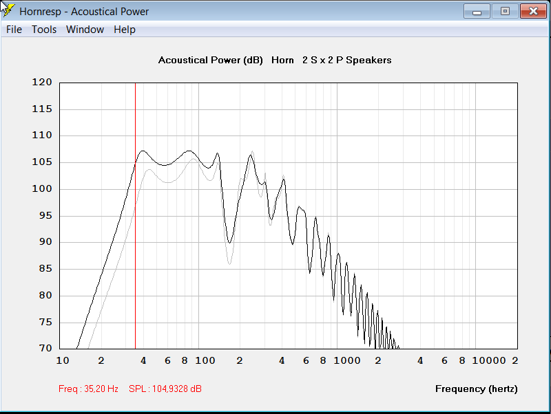

Here is a simple comparison with the Fane Colossus Prime 18XS in a THAM18 and a ROAR18.
The ROAR18 has much more usable output in the midbass (75 - 110 Hz with +10 dB at 95 Hz) and almost 10 Hz more low end. It is a much larger box to build, but the consistent use of 90 degree corners makes for a very easy build.

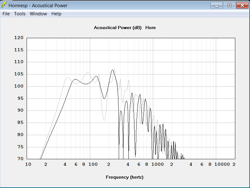

4 THAM18 with the Fane Colossus driver (grey line) compared to one single ROAR12 with a B&C 12PS100. All drivers get 2,83 volt.
One ROAR18 will go almost 10 Hz lower then 4 THAM18.
Black line is a single ROAR18 and the gray line is a stack of 4 THAM18.

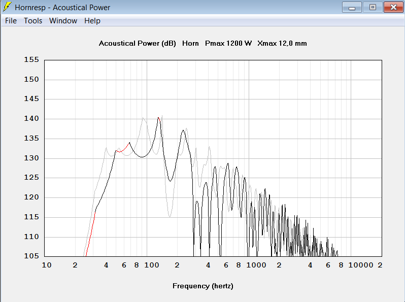

Another problem might be that the tuning is crazy low when stack multiple Roar18 cabs
One vs four ROAR18 with the Fane driver.
A stack of four ROAR18 will have the middle of the lower peak at 39 Hz and a single ROAR18 at 44 Hz.

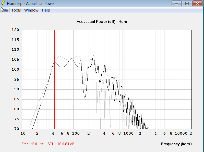

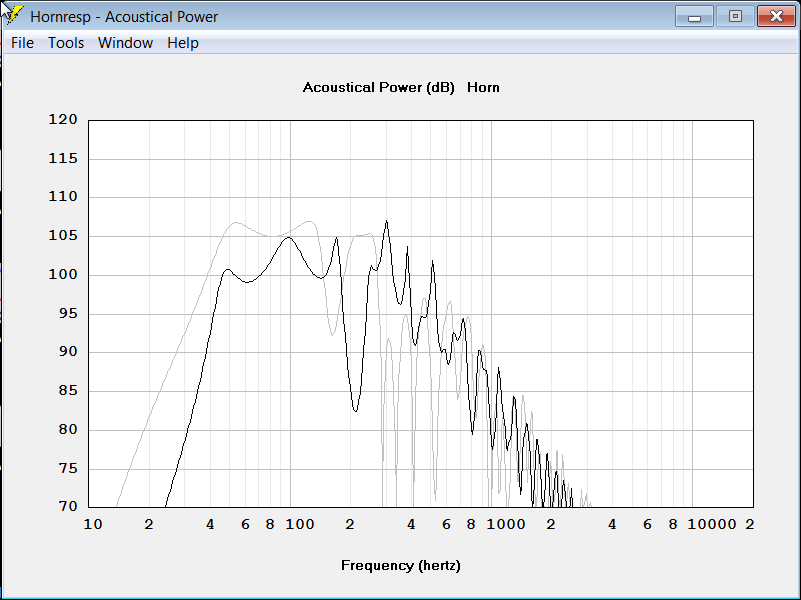

Most of the simulations I run with drivers which look like they might not be best suited for tapped horns tend to exhibit many of these behaviours already in the simulations - the 10Hz higher cutoff, and the reaching of excursion limits much faster than usual. Lower efficiency is less clear but certainly if averaged across the typical passband, the efficiency would be lower.If you use a less suitable TH driver the efficiency at the 1/4WL system resonance of the TH will be lower in the real world. Worse, it might 'push' the roll-off upwards in frequency (up to 10Hz is not unusual) or the driver might run into serious nonlinear behaviour before Xmax is reached.
(The Faital 18FH500 for example, is about 10Hz higher in f3 than other drivers in the THAM18, and reaches xmax with very little power input)
It has 375 Vas and 19 BL. Rme = 70.
But the simulations for this driver seem to bear out much of the content of your warnings already. Do you have good reason to suggest Hornresp is failing to accurately sim 'unsuitable' drivers?
