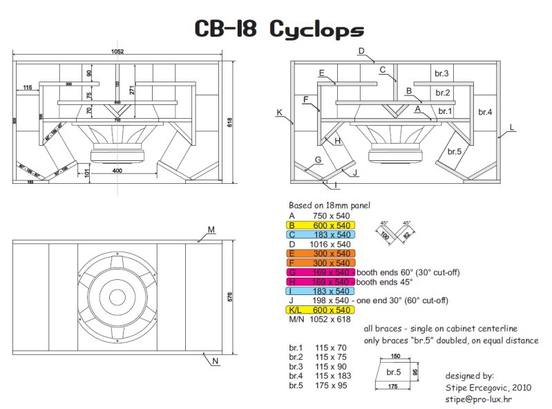

Another option worth considering is the CB-18 Cyclops.
It's a slightly bigger enclosure than the THAM18 but people who've built it report being very satisfied, and you can see just from looking at the design why that could be. The labyrinth of panels on the inside of the box makes it incredibly well braced internally, so the enclosure will be a lot more 'dead' at high power levels, which translates to small efficiency gains (a few tenths of a dB) and a marginally tighter sound.
These are an attempt at modelling the Cyclops in Hornresp that I found on Google, from another diyaudio forum member, but how accurate they are I'm not sure.

Thank you so much for this info. If you look at the tham18 response. What do you think is the first real dip? Where can I cross it? I was hoping for a 100hz 🙂
Well, really the first dip, period. I was just trying to distinguish it from the first unavoidable dip (as with the Cyclops response).
100Hz will work, it just won't be optimal. It's that dip centered on 155Hz you want to avoid featuring as much as possible. It seems like 130Hz or so is where it really starts to fall off a cliff. You could try a steeper crossover slope, or even asymmetrical slopes (rolling off the bass faster than the tops come in), but you can definitely get it somewhere around 100Hz and it'll be fine. It won't make or break the system if you can't stretch to 90 but it might help if you can.

The MHB-4818 is a ridiculously huge enclosure. Unnecessarily large for what it does.
Before definitively pulling the trigger on the THAM's though I still think it might be worth a look at the Xoc 18" 35Hz tapped horn thread I mentioned.
TH-18 Flat to 35hz! (Xoc1's design)
Hornresp data on the 5th post down. It's not actually flat to 35Hz and it looks like a somewhat more advanced build. And it's larger of course.
The thing about the THAM18 though, above these other designs, is it's an easy build. That counts for a lot for reasons I mentioned about the strain of a high power driver on
an enclosure with less than optimal build quality. Less complexity, less to go wrong.
Getting the enclosure walls solid and free of vibrations is in many ways more important than the actual acoustic properties of the design.
