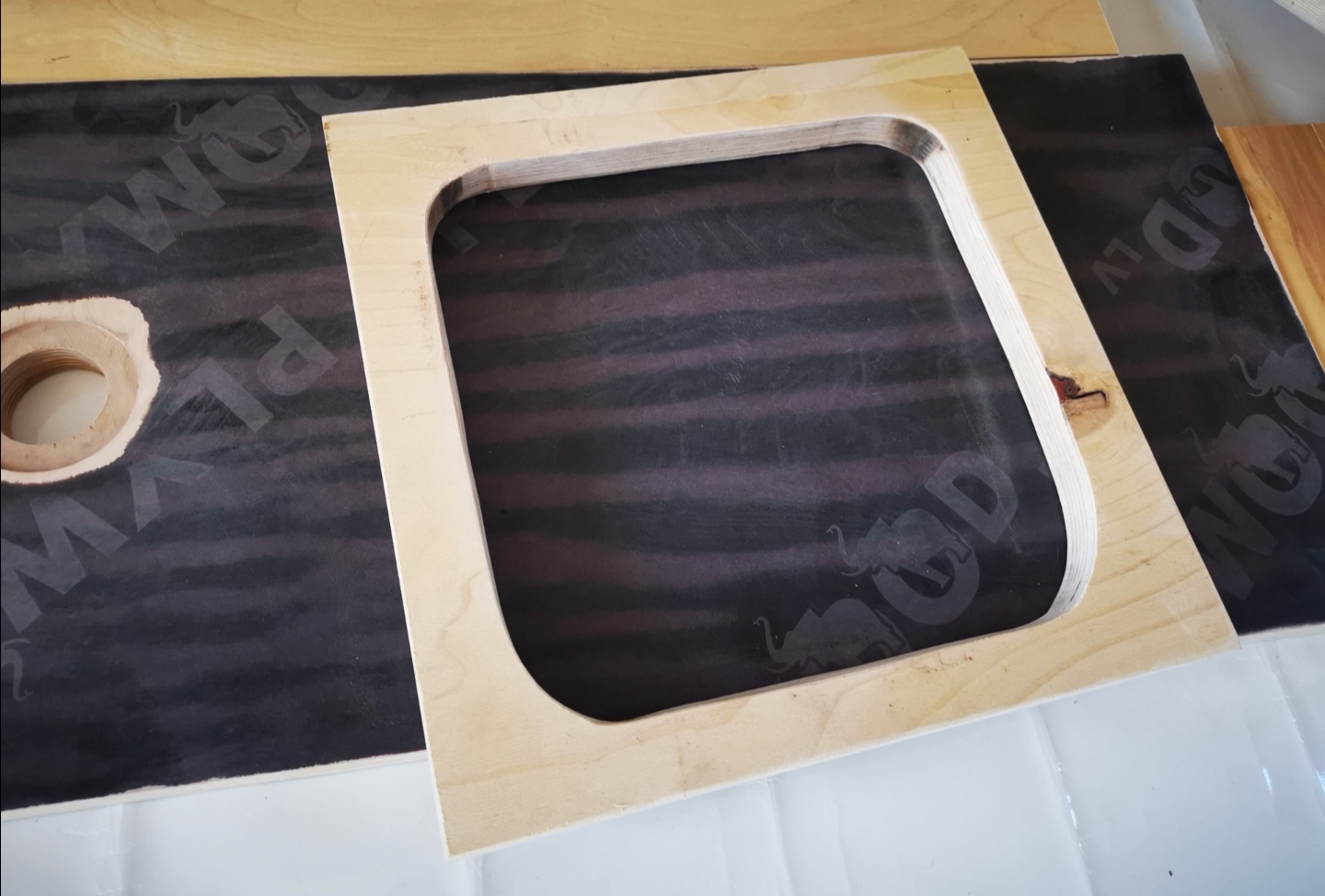

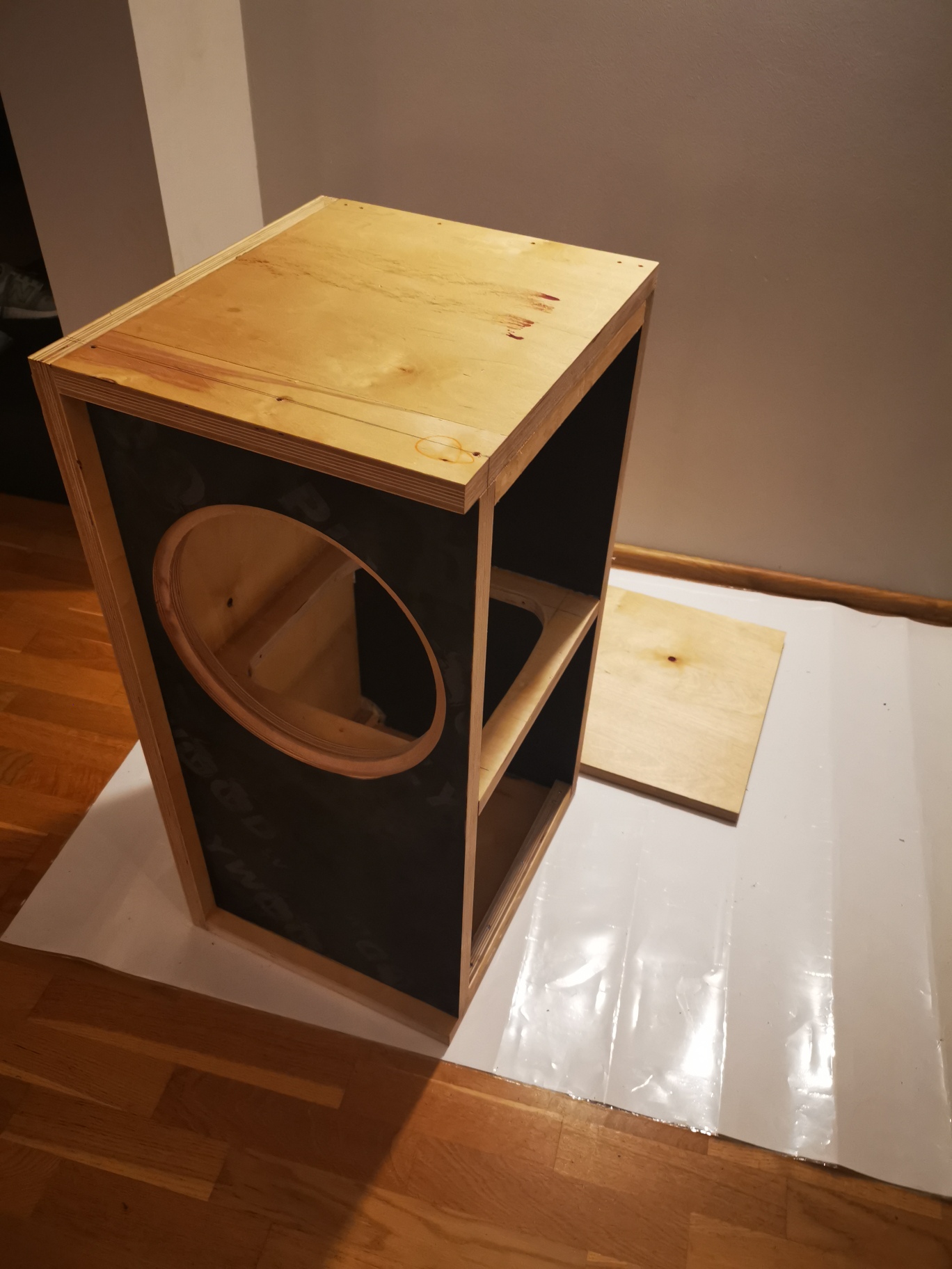

That brace looks solid. If it is, you have lost half the cabinet volume.
When I said the brace doesn’t have to be holey, I was under the impression you were wanting to use an open brace ie like a picture frame with no picture in it.
You need to cut/ drill some holes in the brace.
My jigsaw was not out yet, I just tried the brace for size
Thank God for that!

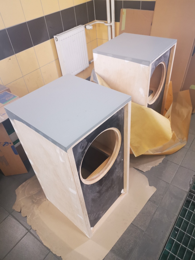

Steve - one more question. I was planning to use damping similar to your project, that is only lower half of the cabinet (but not wool like yours, just simple polyfill). But my rear wall plywood surface is laminated with some kind of "film" (got it really cheap, that's why I bought it ). So will this affect the sound and should I cover it with polyfill to to avoid negative effects? This will be the part that will be exactly the opposite of the driver.
